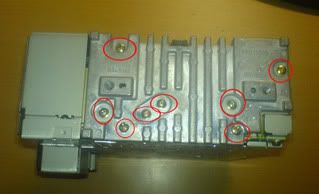

Once you have your stock radio off, remove the (4) screws that hold the radio. There are (2) on each side.

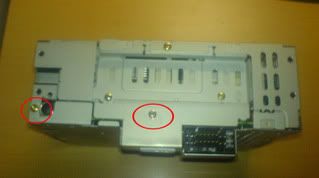

Remove the (2) screws on the back of the radio.
Remove the (8) screws that holds the heat sink together.

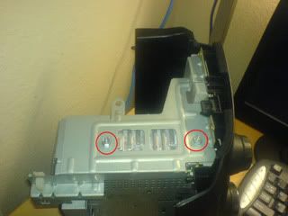

Flip the radio to its front side, and remove the (2) screws.

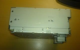

Pry open the bottom cover carefully. Its not hard to remove and use a flat head screwdriver.
Now that you have the heat sink and the bottom plate off, BE VERY CAREFULL WITH THE NEXT STEP.

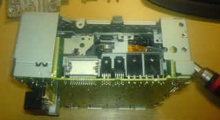

Now look at the radio where the heat sink normally is. You will see set of (3) resisters next to each other. Pay close attention to the middle resister with the number R797. That’s the one you need to fix.
DO THIS AT YOURE OWN RISK.
I just got small wire cutters and broke the resister off. You don’t need to replace it, but you will like to, you need to buy that resister. Don’t know how much it is or where to buy it. If I can recall, they told me it was a 2.4A resister. All I did was to place a small piece of wire and solder the joints. AKA Jump the connections.
Here is a picture of how it looks after I jump the connection.

SEE! I told you guys it was an easy fix, but no one believed me!!
2.4 ohms sounds like it.
I would recommend replacing the resistor. It's there to limit current and too much current is possibly why it burned out.
A resistor is 50 cents or less. A display module is a lot more.
Radio shack should have resistors. If not, order one from mouser or digi-key.
Don't take a chance bridging the resistor. It's there for a reason!
