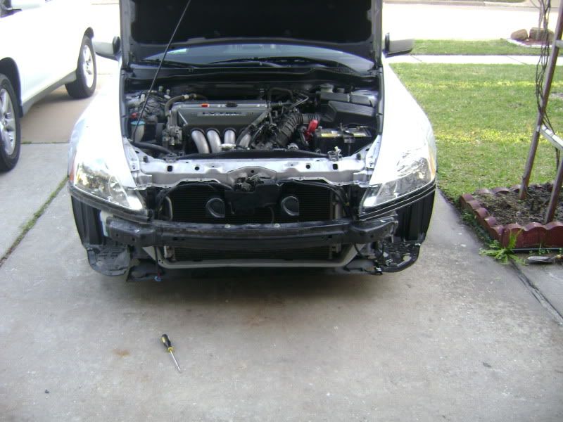

Step 1: Removing Front Bumper
I followed these instructions to remove my bumper:
03 front bumper

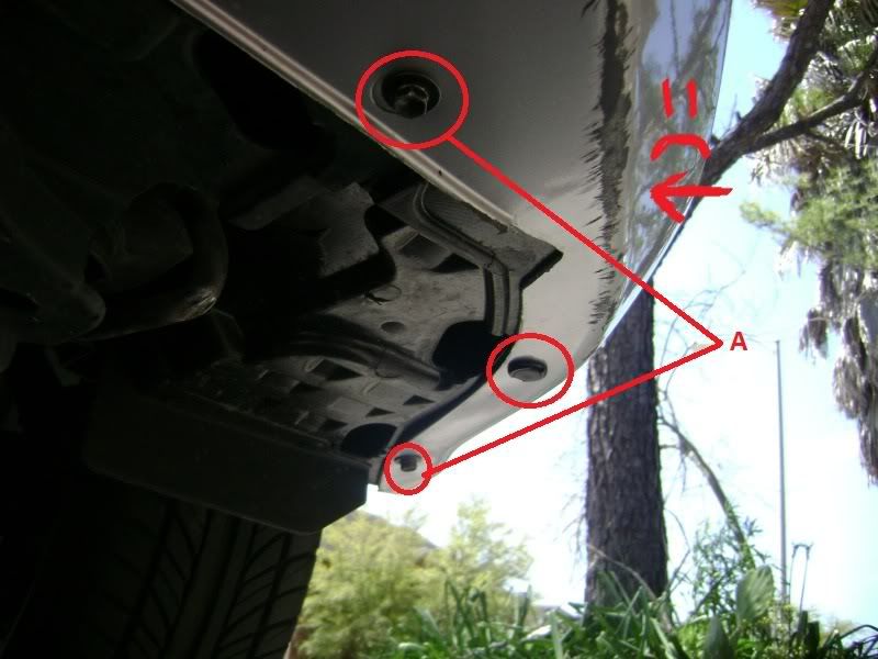

GOING UNDER

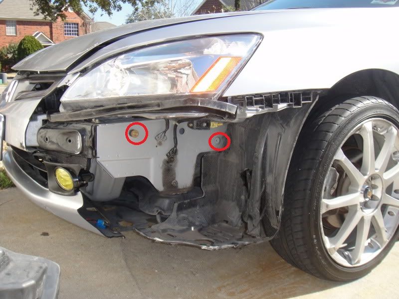

1. Remove the 6 plastic clips on the bottom(Using a Flat Screwdriver
2. Remove 2 bolts from each side also on the bottom [A] (Using a 10mm Socket)
….Forgot about those Non-Ricer friendly driveways after my drop

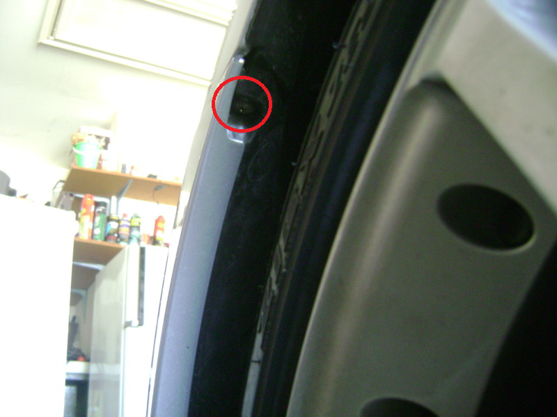

1. Remove both screws by the front fender well (Using a Phillips Screwdriver)

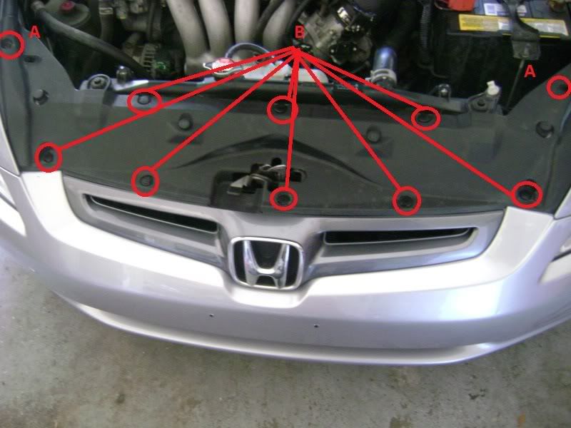

UPTOP
1. Remove 8 more plastic clips on the top (coming out to a total of 14 clips) [B]
2. Remove the 2 side screw clips [A]

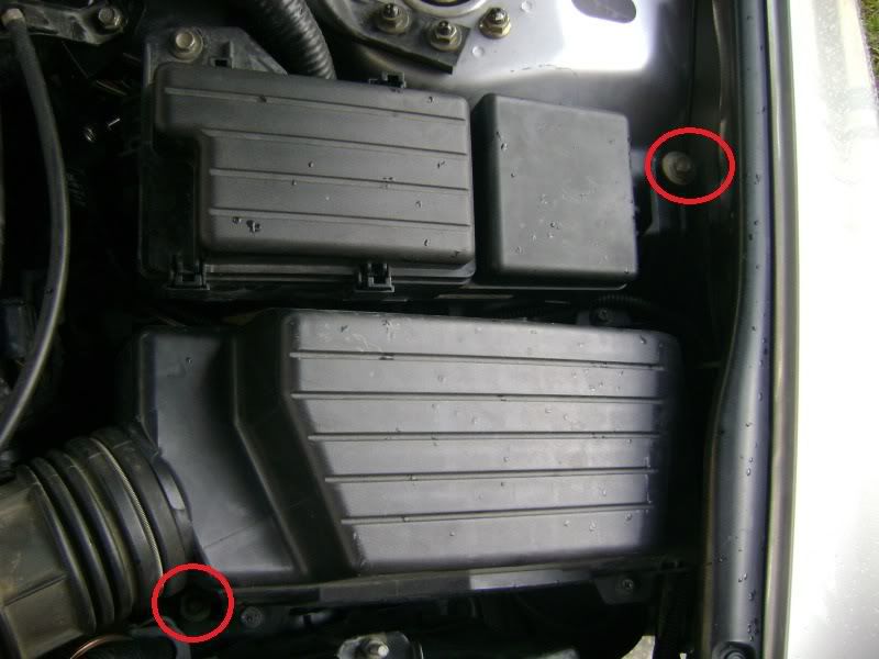

Step 2: REMOVING THE STOCK AIRBOX

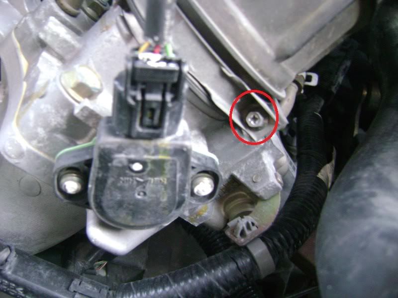

1. Remove the 2 bolts where the filter is at(Using a 10mm Socket)
1.Remove the Vent Chamber…You should be able to just pull it out

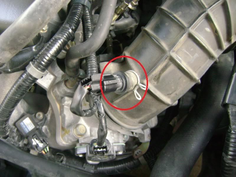

1. Remove this sensor using a plier to squeeze the clamps
1. Remove the clamp holding the stock airbox tube using a Phillips Screwdriver

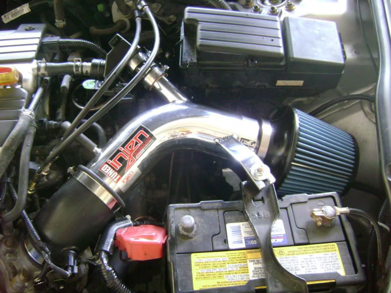

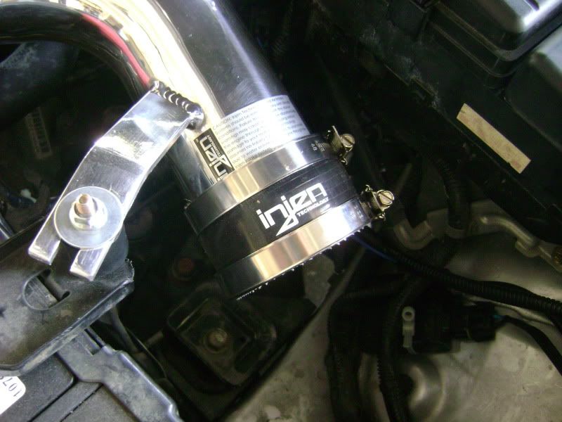

Step 3: INSTALLING NEW INJEN INTAKE (DON”T TIGHTEN ANYTHING TILL THE VERY END)

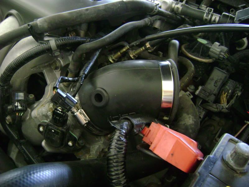

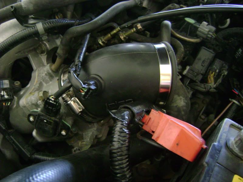

1. Install the new rubber tubing(Make sure you push it all the way in) Tighten it a little using a Flathead or 8mm Socket so that it does move to much.
2. Insert the Sensor

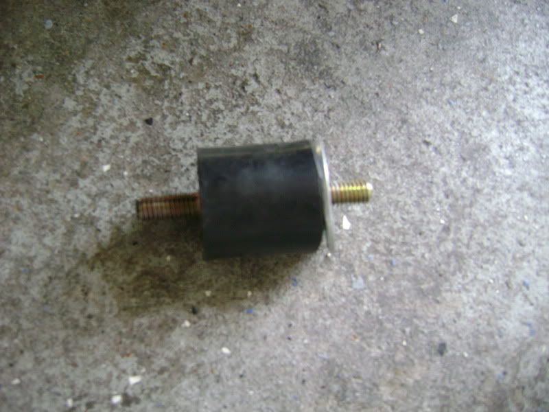

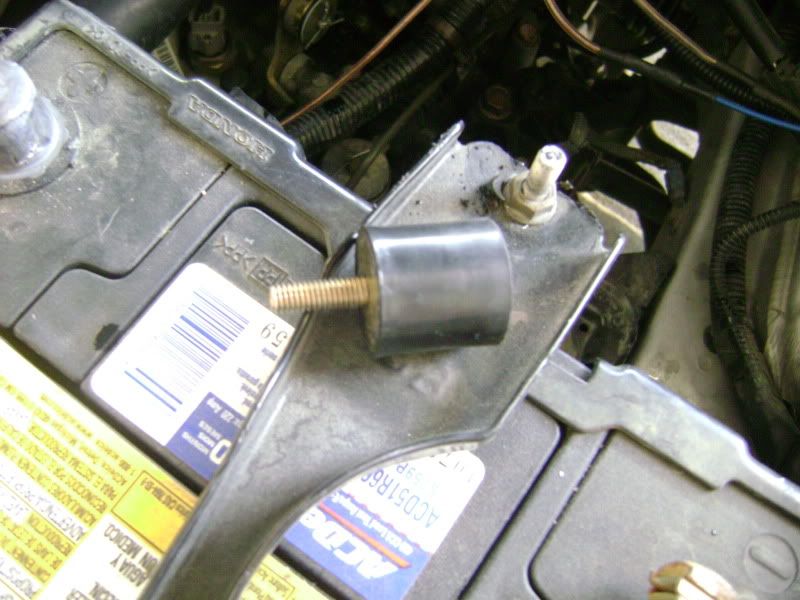

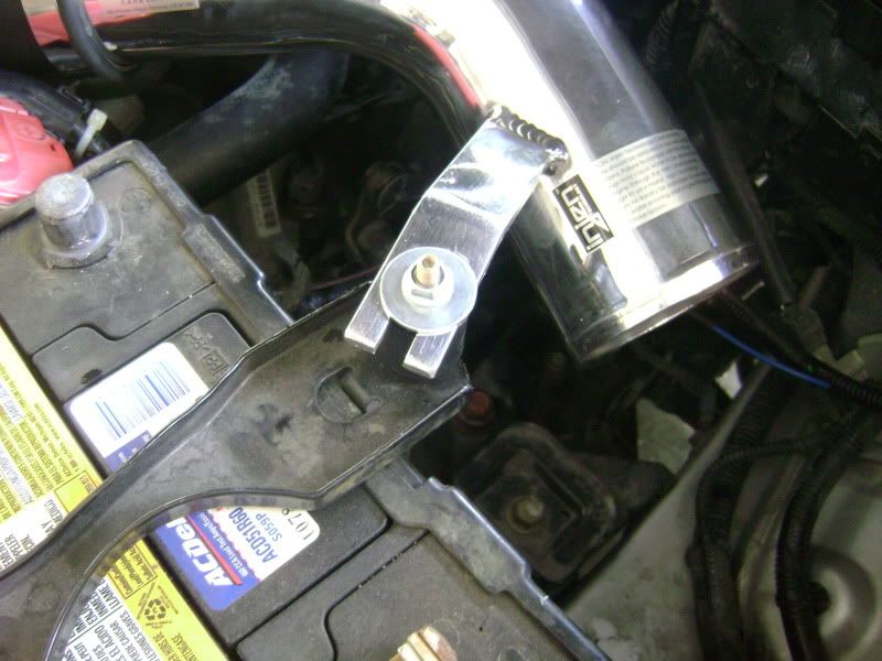

Screw on the 1st Vibra-Mount (One female end and one male end) to the top battery screw
The second Vibra-Mount (2 male ends) goes where the old Factory Resonator was…Near the Fenderwell

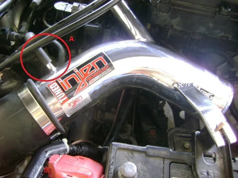

1. Install the 1st part of the CAI
2. Install the stock vacuum line [A]
1. Slide the bracket onto of the Vibra-Mount and screw on the nut(using a 10mm Socket)

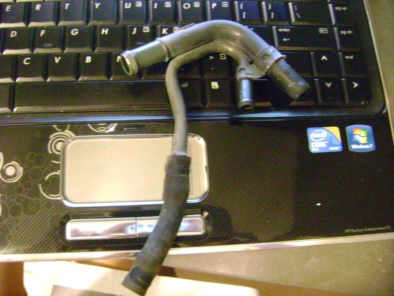

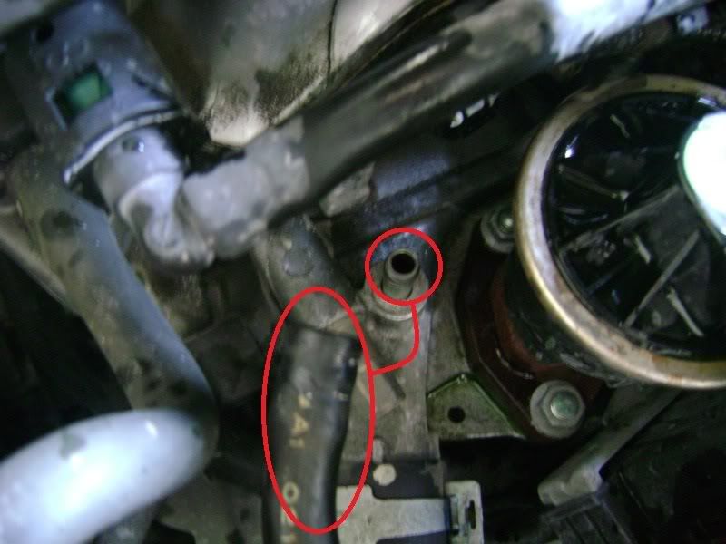

You won't be needing this piece(the PVC Pipe and Short Coolant line)
Remove the short coolant tube and Install the long coolant line where the existing short coolant line was.
1. Install Breather Hose directly onto the Vent Chamber
2. Install the the Injen Sleeve and then Assemble the Vent Chamber

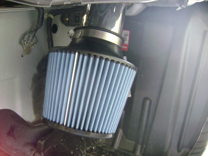

If you want a Short Ram Intake (SRI) install the filter now and put everything back to together ….If not lets keep going…

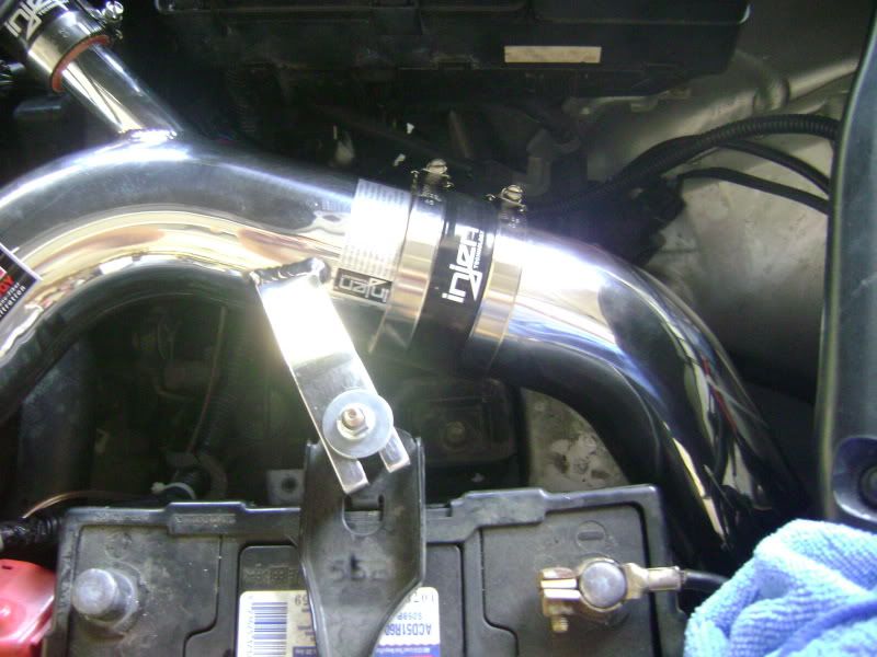

Insert the other Injen Sleeve onto the end of the tubing

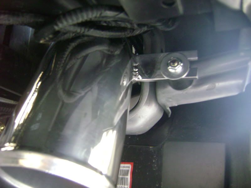

1. Going from the bottom insert the 2nd part of the CAI into the Sleeve
2. Slide the Bracket onto the Vibra-Mount and screw it on

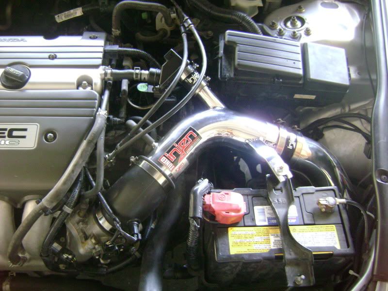

Install your filter and you are done!

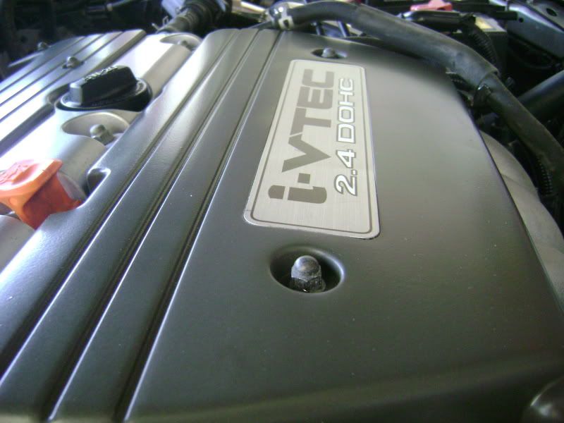

Should like this
Oooo Painted Manifold Cover(GunMetal Gray)

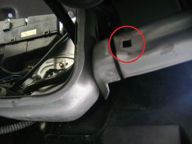

SHOW US HOW TO TAKE OFF RESONATOR!!!

Come Nick thats so easy ...
Remove your Bumper and you'll see something like this(sorry this is an I4 "slight difference in V6") hehehe
The Bolts are already removed on the picture below, but you can see where the bolts were at

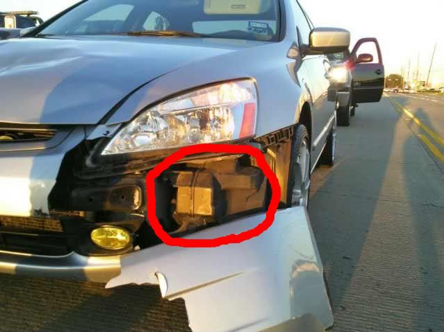

why is your front impact sensor places so far back? mine is all the way to the front right behind the foglight...

that yellow thing???
