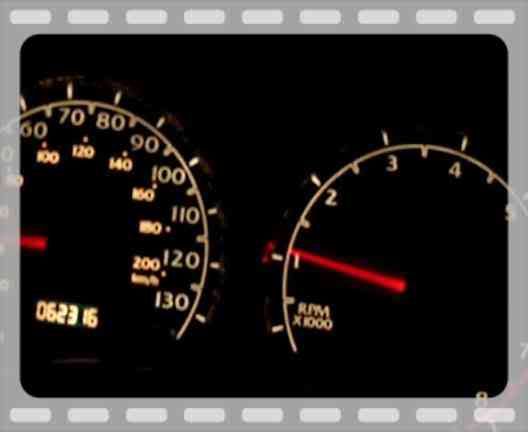

GM L66 = Honda 3.5L V6 & 5 speed auto. EGR appears to be the same as on my Accord, so Honda sourced.
Here is a video clip of how the trans is acting on mine. It seems to shift to the highest gear at too low of a speed. Sometimes it feels like a manual transmission in too high of a gear that bogs and needs an upshift. I was holding the camera with the steering wheel, so sorry for the couple of bumps.
