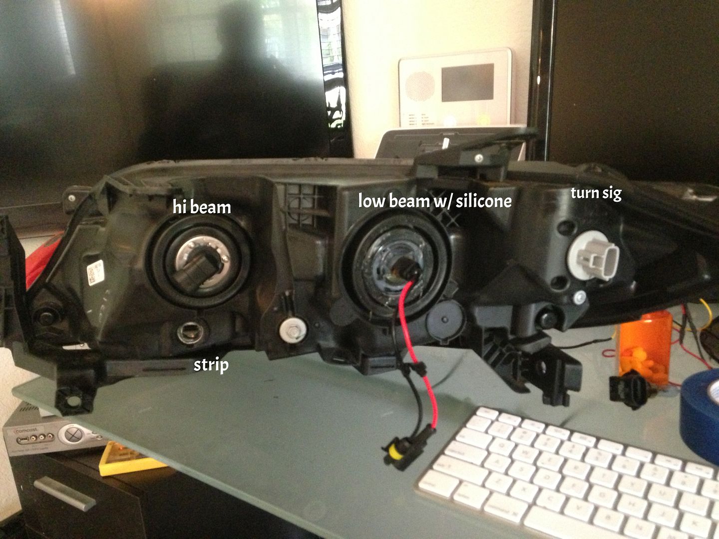

Remove 1 plastic clip and 4 screws to take the headlight out. You will need a ratchet with an extension at least 6 inches to remove a bottom screw under strip light on the horn side. If it is too hard for you to get the whole headlight assembly out then refer to the video to take the bumper off for easier. Remove all harnesses, bulbs. Take left and right headlight out by slightly lift up and toward the front.

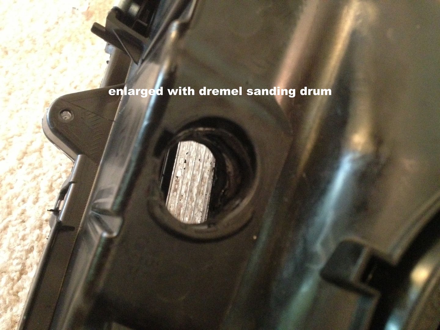

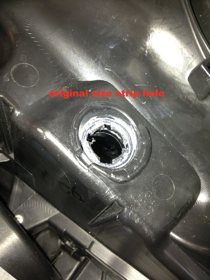

Drill the strip light socket hole wider for sliding the led blocks into strip light space using a 1/4" or bigger bit.

Slide led DRL bar into the hole. The bar is slightly curve in the bottom to fit perfect in. Make sure the led blocks face to front so you can see the lights,

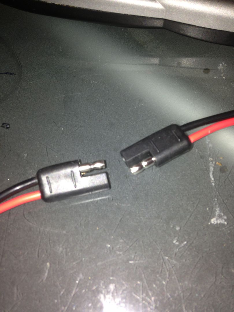

Make a short 1 foot ground wire with a female connector on one end. Attach the other end to car chassis.

Tap a wire to the turn signal. There are 3 wires in that harness, and the wire in Blue/Gray is turn signal wire. Connect a female connector to the other end.
