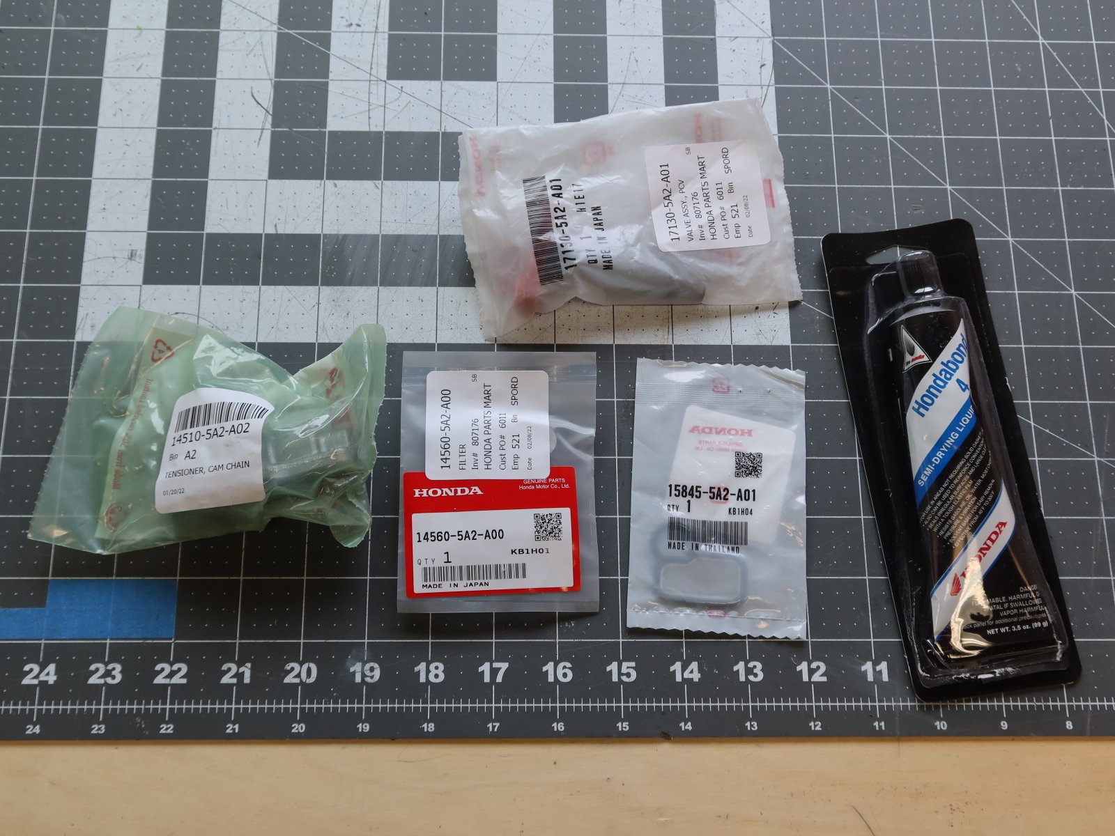

Anyway, enough talk. Here are a bunch of photos that I took today, which will hopefully be useful as a reference to others.
Here are the parts that I replaced today.
The new CCT came with the locking tool...I sort of wish that office supply stores sold push pins of this length lol. That would be useful for all sorts of other stuff!
The CCT filter, which is considerably more expensive than the CCT itself, is a nice little piece of laser cut stainless steel. My engine had one in it (others have said that their engine was missing it from the factory), so I could have cleaned and reused it, but since I already had the part I chose to use it.

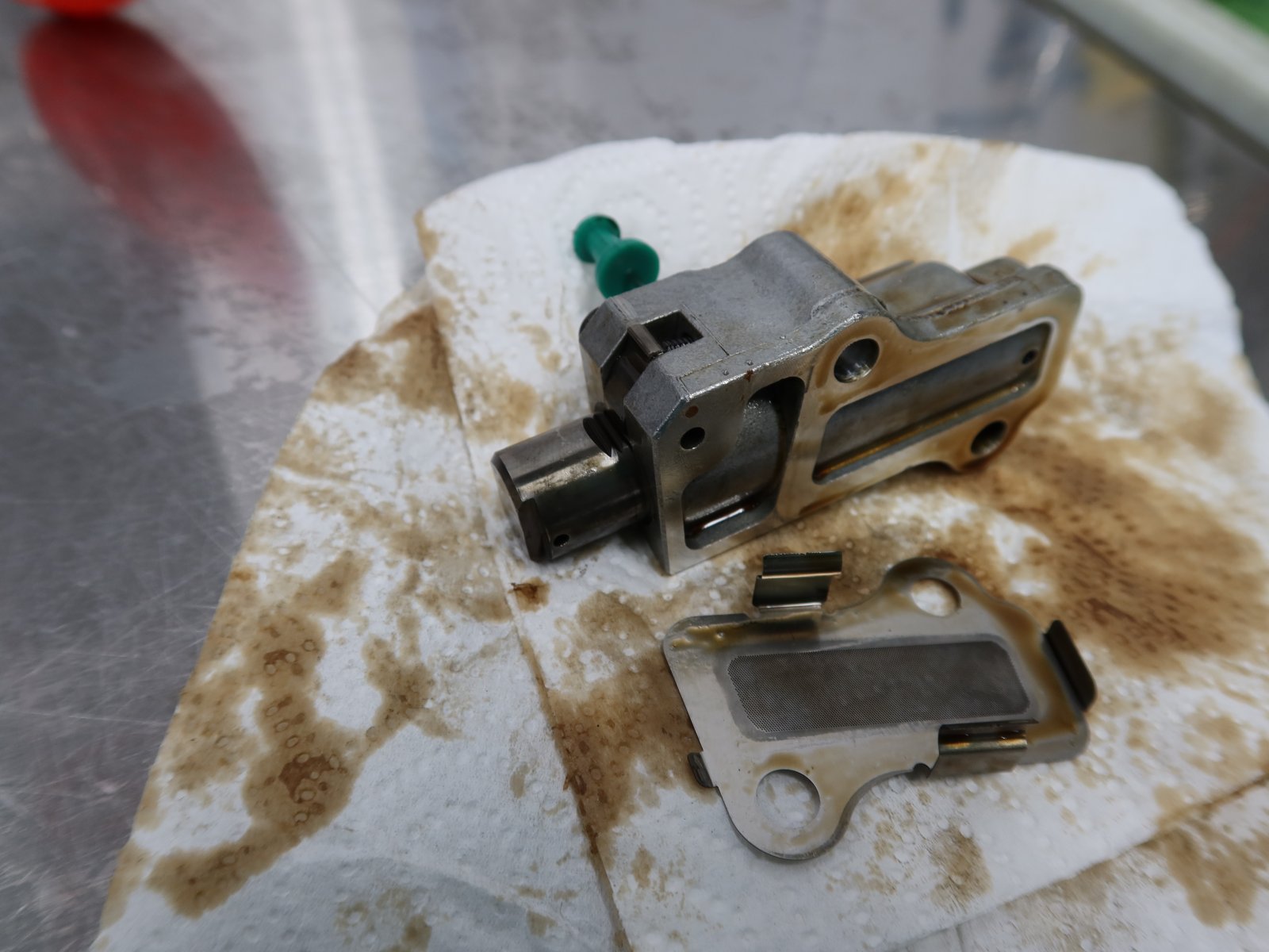

As far as the old CCT and my inspection of it, there was light wear as I noted at the beginning. There are two check valves inside, a lower and an upper (upper is in the piston). As far as I could tell, the upper one had crapped out and was not holding any pressure. My guess is that it is designed to create some amount of back pressure to ensure that sufficient oil pressure exists in the CCT piston to keep the chain adequately tensioned. If the spring inside breaks or loses stiffness, it will not allow proper oil pressure to develop. This post is getting pretty long, so I will just dump the rest of the pics below lol. Feel free to ask questions.
