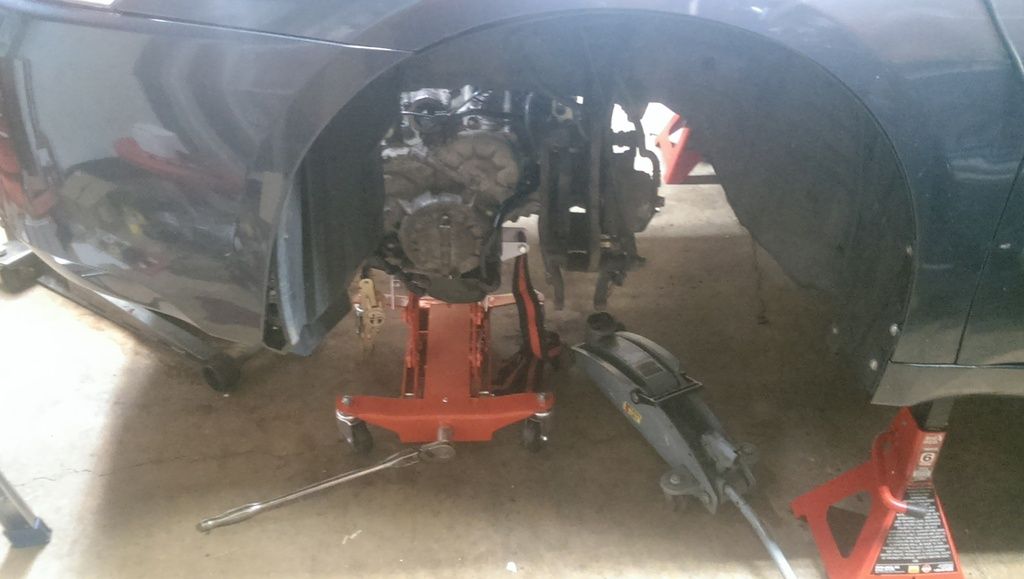

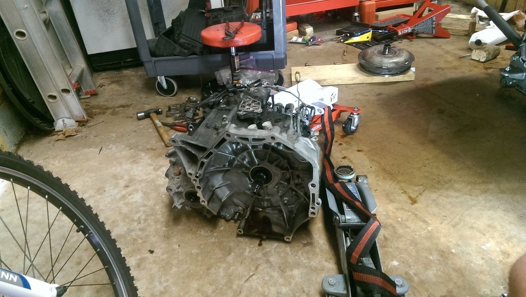

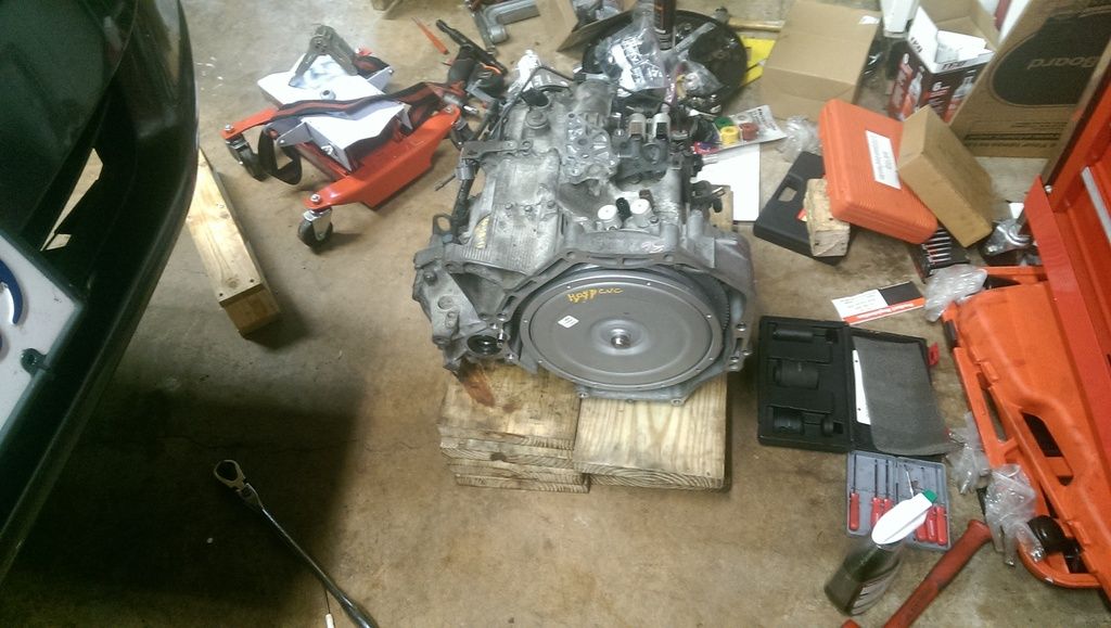

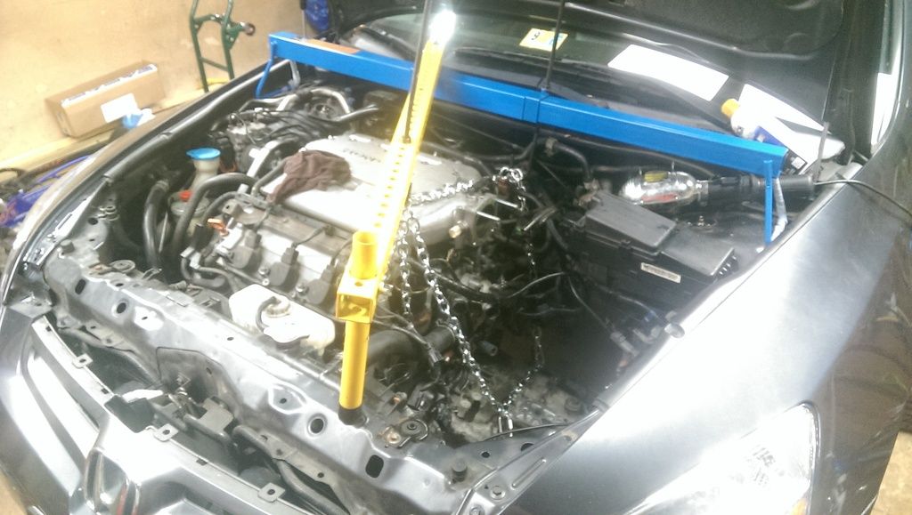

Sorry folks, I didnt intend this to be a DIY so I didnt take pics or catalog my progress. I will say that the FSM is 95% an idiots guide so if you follow it step by step, you will be just about there. The procedure is not complex but is physically hard if that makes sense. Here are some random photos:

I. a.) You will need chains to lift/support the engine and trans
II.) if you dont have an engine hoist, you will need a transverse mounted engine support - you can get these for $60-80 but see my above point about chains. There are two lifting points on the auto tranny and one lifting point on the passenger side of the engine plus a bolt on each cylinder head that can accommodate a lifting hook
