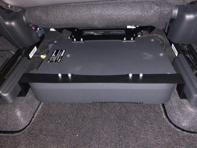

So I finally got around to installing this system. For those that aren’t aware, it’s a plug and play sound system upgrade for 10th Gen Accords without the premium audio. Consists of the Alpine KTP-445U Power Pack 4-channel amp, which provides 45 watts RMS to the 8 factory speakers and also the PWE-S8 compact powered sub. Both units are installed on a custom frame made by Alpine that installs under the passenger seat.
I purchased it from Crutchfield for $749.
It comes with everything needed to install it, to include a power cable that is ran from the fuse box in the engine bay to the powered sub. No wire cutting is needed.
The install is not the best. If you follow Alpine’s included instructions, they are lack luster at best. There’s a bunch of discrepancies that I’m not keen on. They have you run the power wire through the firewall on the passenger side; an absolute mother f*cker to get to...and I’ve done my fair share of installs. Word of caution, the A/C line you have to reach around is a soft aluminum. Don’t bend it too much trying to get the wire through or you’ll weaken it and possibly cause a leak. Other small things I have issues with is the factory radio connection area. They just talk as if it’s a simple unplug, and plug the T-harness in. Not so simple. You have to loosen the head unit mount nuts (10mm) and slide the unit up for access. They also don’t include instructions for removing the shift console on a 2.0T model with electronic shifter. Discovered you just pull up on it, and disconnect 3 connectors. Lastly, you have to remove the passenger seat to install the assembly. This means disconnecting the 3 connectors on the bottom of the seat. One thing Alpine left out is that harness is secured to the seat with a white clip. I removed it as careful as possible using a panel tool, but it still broke.
Everything else is fairly accurate on the install sheet. You have to remove both side panels on the center console, the shift console, the storage compartment forward of the shift console, the push button start panel, the glove box, lower panel below the glove box, trim above the glove box, right side dash cover, and finally the HVAC panel assembly.

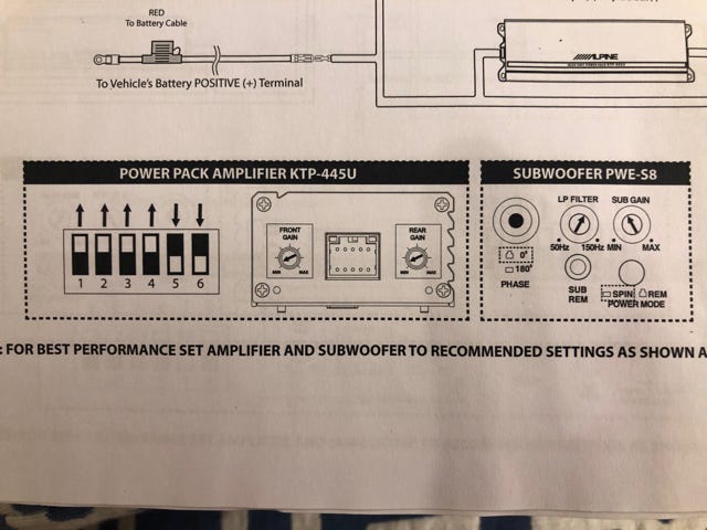

After I had everything wired, I fired it up and started testing things. Alpine’s instructions say to leave the crossover points on the 4-channel amp OFF. I’m certain the instructions say this and I’m not sure if this is an image error, or not.
To me, this muddied up the mid bass horrible. I have mine set to 80hz right now and might lower them to 60hz for more testing.
As far as sound quality goes. It’s LEAPS AND BOUNDS louder without distortion.
As far as bass goes, the jury is still out on that one for me. I’m not really a bass head but I can appreciate a low note and the low notes (around under 40hz) just aren’t really that pronounced. It definitely helps in bass, so don’t get me wrong. I haven’t heard a premium audio Accord yet but I’d like to compare them just to see.
And yes, ANC is disconnected.
I’ll answer any questions you guys may have about the install the best I can.

I changed the crossover to 60hz high pass and I’m still on the fence about it. Deep bass isn’t that low. But I guess not to be expected. Other bass notes are fine. I’ll play around with it some more and try defeating the crossovers again. Just doesn’t seem right sending full range signals to the doors, based off of previous car audio experience.

Did some more playing around last night. I flipped the phase switch on the sub to 180* and the bass is a little lower. To me, it sounds more balanced and even than at 0*.
