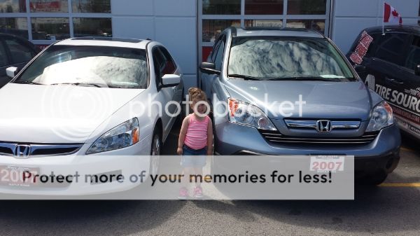

Back in late June 2013, my wife and I found ourselves in need of replacing both our main family hauler, and a secondary commuter. After an exhaustive search we stumbled across a local dealer with our perfect “his and her combo” (the commuter idea went straight out the window, that Accord was MINE), and with a bit of haggling (8 hours worth, really) we ended up bringing them home.
An ’07 sedan, with a K24 and a 5AT … Taffy White with black cloth interior. She’s a Canadian SE, so the steering wheel and gear selector are leather wrapped, and the sunroof and 6 disc in-dash radio are also in place. There were 160,000 kms on the clock (173,000 at the time of posting). I immediately nicknamed her Betty White, because she’s my “golden girl” who exudes class and commands a little respect … my daughter "gets it" and loves my car almost as much as I do.
