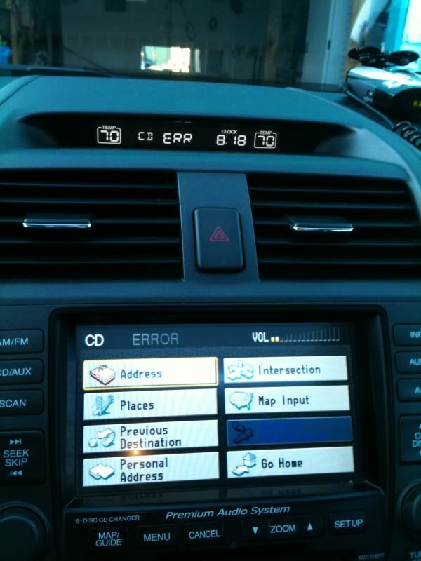

Like many, my 6 disc CD changer jammed up giving me the CD err error, representing a mechanical error in the changer. FAIL.
My question is- is it possible to swap in a CD changer from another Accord non-navi head unit into mine? And if so, would a 2006 CD changer be compatible?

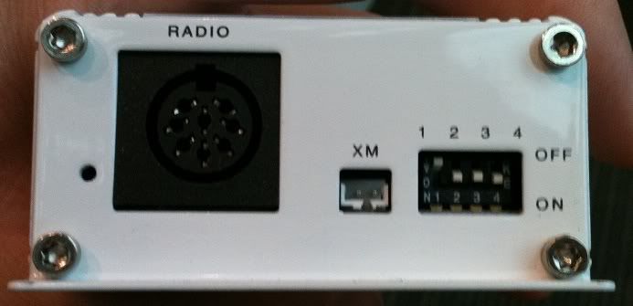

So in a previous thread I attempted to install a USA*SPEC PA15-HON2 iPod/iPhone interface unit to my AUX port to bypass my jammed CD changer (CD err). I tried and I couldn't get it to work. Even after hooking it up my CD/AUX button would keep going to "CD" mode and giving me CD err instead of picking up the AUX input no matter how many times I pressed it.
Anyway, I may attempt again pretty soon, and wanted to see if anyone who's installed a USA*SPEC hook up could help me out with the dip settings. The manual it came with is extremely confusing to me to configure for my specific vehicle.

I believe DIP #1 should be on since that's the AUX port. You must use 3.5mm cable (headphone jack size) for this to work. I believe you need the CD changer to function properly to use the CD-C mode.

Incorrect information. The in-dash CD changer has nothing to do with the USASpec iPod kit. Without XM, the dip switches must be configured for Non-XM use. See page 7 of the manual, section 3-3. For Non-XM, the dip switches must be ON for Dip Switches 2, 3, and 4. Dip #1 is for Aux on or off. So if you plan on using an additional audio source through the Aux input, set Dip #1 accordingly. Once you set Dip 2, 3, and 4 to ON, the USASpec will appear an an external CD Changer (CD-C). Your CD/Aux button will toggle between the broken in-dash CD unit (CD), and the iPod (CD-C). If you can successfully eject your CDs, then the CD/Aux button will be for CD-C only. In your photo, it looks like some of the switches may not be fully in the on position. Set all the switches to ON, and see if that works.

The problem with the USASpec, as you discovered, the manual was written by a bunch of retarded idiots. It makes no sense. Another member had problems with the dip switch settings, and I think he got it to work by leaving the Aux dip #1 on. Can't remember. Many have also gotten dead units on arrival as well.
