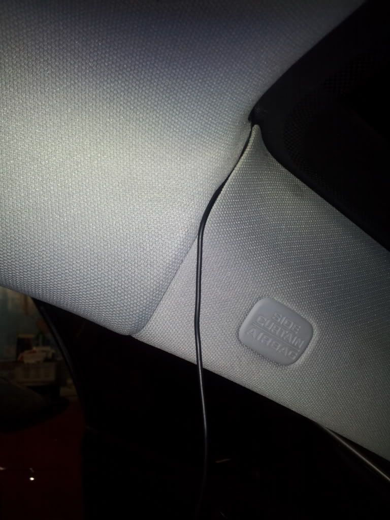

You should run the A pillar wire correctly. Remove the cover and zip tie it down with the other cables. These airbags are very precise. If there is something getting in its way during a crash, it might not perform as it should.
Look at this Kia below, the side curtain was blocked by the pillar cover and never got to fire. Don't ever get in a Kia :wave:
http://www.youtube.com/watch?v=lrHYl9D5CTI
Its tucked in 1/4" from the gap, just out of sight. It never goes farther down the A-pillar than the roof panel...definitely not in a position to interfere with the airbag...I definitely appreciate the concern and urge other Owner's to be mindful of these sort of things, it cannot be repeated enough.
· 2006 I4 MT
2,113 Posts
I'm big on safety these days. Spent too much time watching Russian car cam videos :) I've seen too many tutorials on youtube where they just tucked it behind the A pillar without thinking of the consequences.
Also, it was a good idea to not remove the shift knob if not needed. I took the knob out one too many times and the shift boot clip broke.
Here is the part number if you want to upgrade that stock knob to leather. 08U92-SDA-100A.
http://www.bernardiparts.com/Honda-Leather-Shift-Knob-MT-Accord-Sedan__08U92-SDA-100A.aspx
