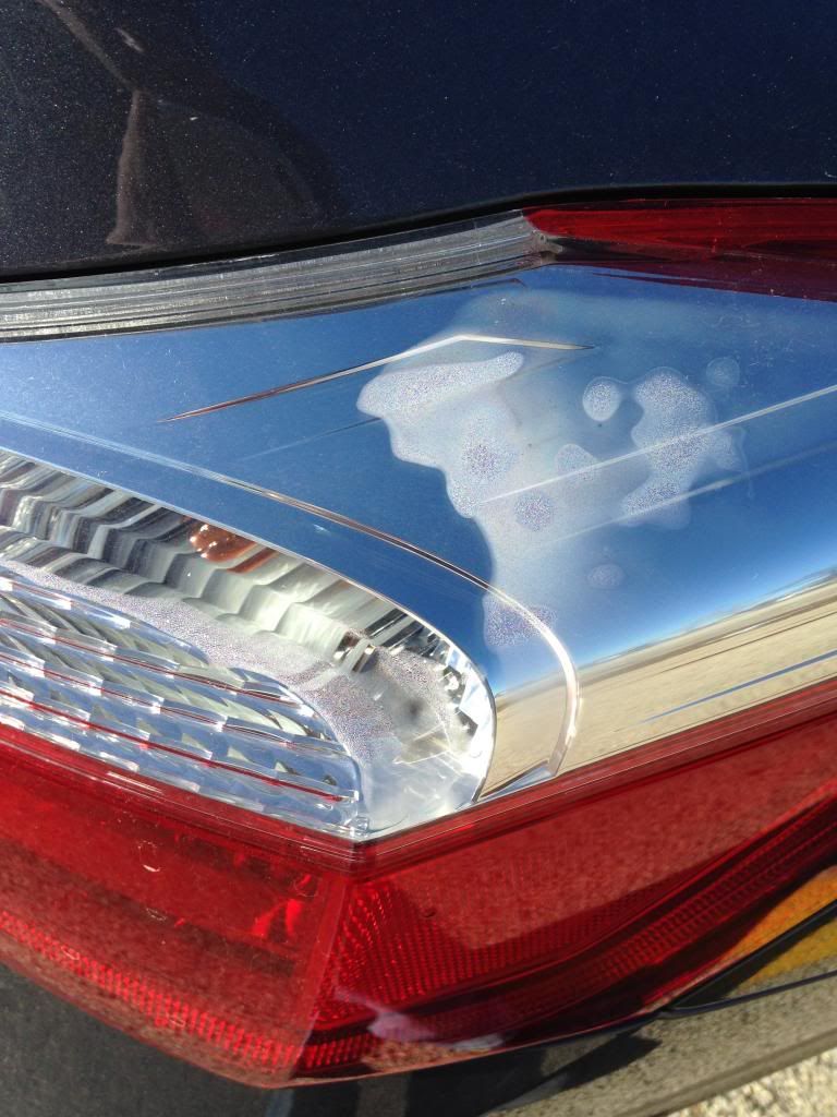

Just got my Accord a few months ago and after the first snowfall and cold I notice this. I took it to the dealer and they said to keep an eye on it, Honda doesn't view this as "warranty" work because the bulbs in the light assembly will warm and evaporate any water. Only issue is these are LED and the heat produced is little to none.
Has anyone else seen this on their car?
Driver:
Passanger:

not normal at all..take it to another dealer and tell them your concerned about mildew buildup inside the lens. make sure you take it with condensation and not dried up. Also make sure your bulbs are seated correctly with the original bulbs.

I was just getting ready to post this same exact thing with my tail lights. Noticed it after driving in the rain and when I parked in the garage I happened to glance at the tail light and it looked slightly fogged up like OP's 2nd picture. I came in the house, pooped the dog then went out with my camera only to find it was completely gone. It will however over time put a permanent cloudy appearance on the lense just as a double pane window with repeated moisture will.:thumbsdow. I just dread the thought of them jacking with the tail light assembly only to have it re-installed incorrectly & ending up with chipped paint as so many others have around tail light.

I noticed a little on my car this evening after the temperature dropped. But if mine looked like yours I'd take it in.

Ya'lz crazy, totally normal.
SITUATION:
HEADLAMPS HAVE CONDENSATION FORMING INTERNALLY
NOTE: Normal condensation is a natural process. Headlamps are vented to alleviate
changes in pressure. Atmospheric air contains water vapor or humidity. When this air
enters the headlamp through the vents there is a possibility that condensation can
occur if the temperature is cold enough. When normal condensation occurs, a thin film
of mist can form on the inside surface of the plastic lens. The thin mist will clear and
exit through the vents during normal operation.
Internal "misting" is generally caused by natural condensation and can be expected under
certain atmospheric conditions. Vehicles that have been recently washed, may have had
water forced into the headlamp via the headlamp vents, resulting in condensation forming
inside the headlamps. Water may also migrate in to the headlamp assembly following bulb
replacement.

I just came on here to post about this happening to my taillights as well. I don't have as much water as you but it is still frustrating. Did you check with another dealer?
