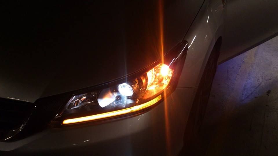

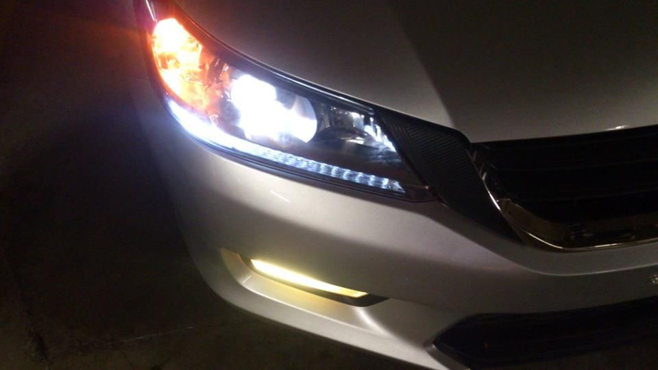

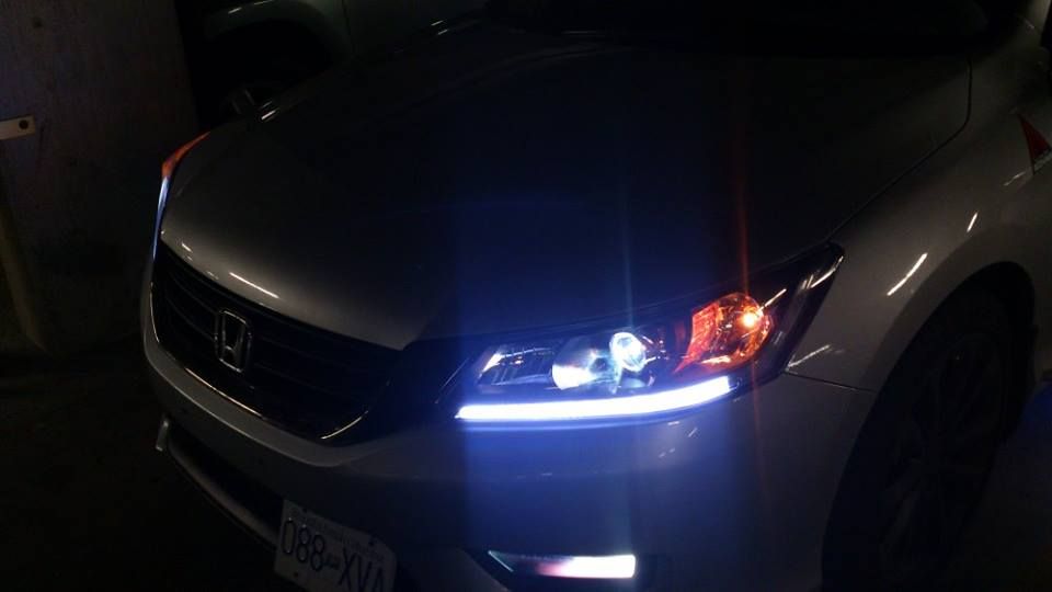

DIY daytime running light . i dont have Touring model lights Its a soft rubber tube contains a LED strip, connects low beam and signals .
I used to only have a T10 LED bulb to lighten the strip . Im impressed by the outcome of the LED now. However, now I lost the feature of the "blink blink" when I unlock the car which I loved so much

That looks nice. I like the switchback feature and is what I would do if I did this mod.
Which LED did you use?

That looks fantastic.
288 Posts
Take some daytime pics. It'd be interesting to see how powerful they are compared to V6/Touring DRL.

Any pictures of said tube? I assume you had to custom wire it to get the turn signal function.

looks nice at night, would like to see some daytime photos with/without lights on in direct sunlight. Is the tube a sore eye when the light isnt on during the daytime? i found a few shops that sells those tubes but wasnt too sure about the light output in the daytime. pics please! thanks
and i believe someone on here used relay/tap-a-fuse to get the blink blink function on the strips. i forgot where i saw it and who did it. might try searching on here somewhere

whoa. that looks really nice.. however i wonder if its too bright at night though, last thing i want is to blind people
need daytime pics for sure!!
