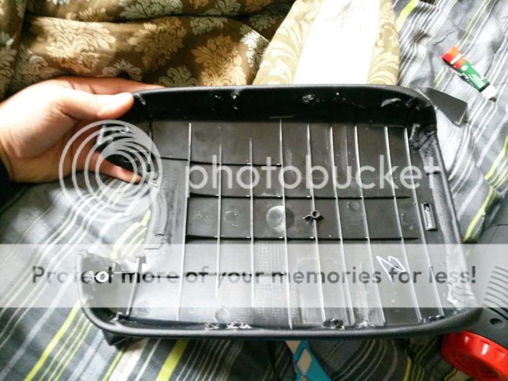

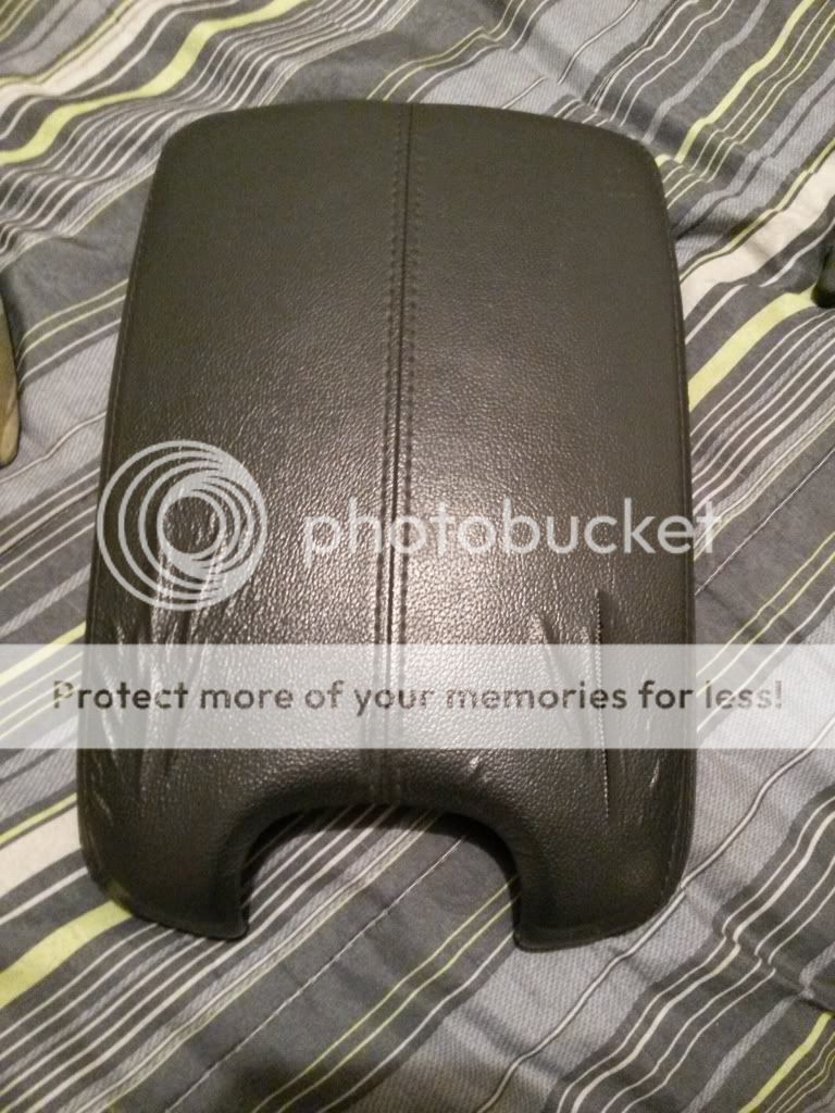

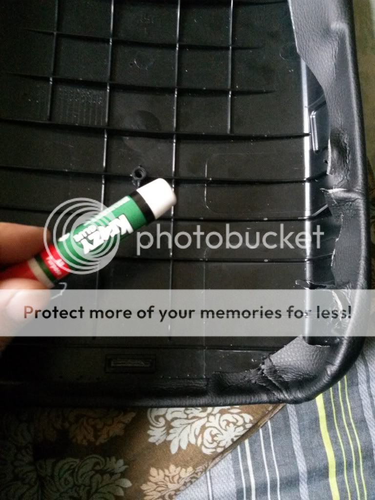

go on ebay and buy the replacement cover lid , I paid 16 dollars shipped to my house this is what I got in the mail
Ive remove the armrest lid by removing 7 screws underneath and you will end up with this , then remove all the staples using any flat tool
I purchased this staple gun thinkin that it will work on the hard plastic of the lid WRONG I had to return it, the only way is using an air staple gun but since I dont have an air compressor
I decide to take it to my upholstery shop thinking that it will be like 15 bucks since I will be giving them everything and they just had to staple it ,wrong AGAIN they wanted 50 bucks I was like G T F O H lol
So I went and bought krazy glue ! 2 dollars

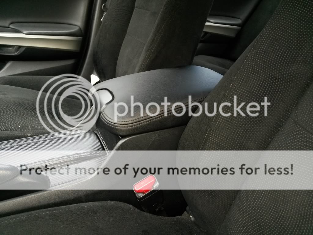

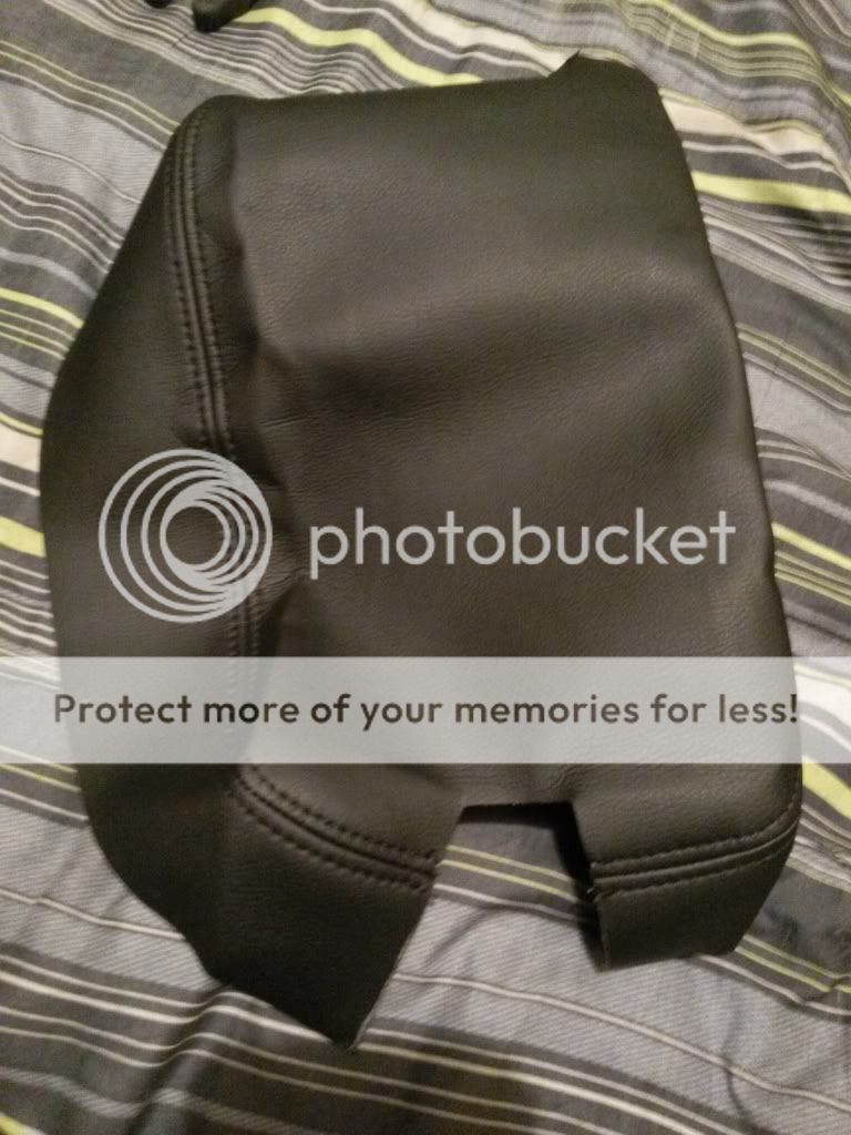

And starter working my way around using a heat gun or hair drier to soften the leather that way it will stretch for good fitment , PATIENCE is they key it took me 45 min to do it ! And here is the final product
Definetly BETTER MATERIAL THAN STOCK
1,361 Posts
Looks like you did a great job on that repair and saved yourself $$ in the process. Amazing what you can do with a sense of determination and a tube of super glue!!

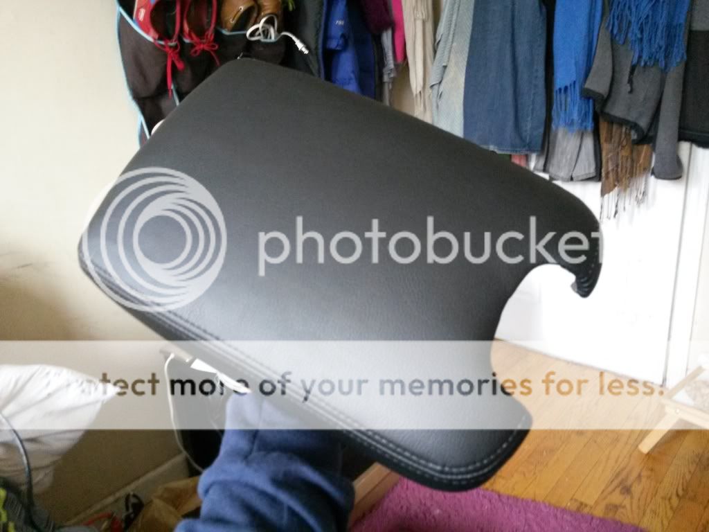

Literally did the same thing today. I bought 1/4 inch staples and used a manual heavy duty staple gun to put it in. Heating up the leather with a heat gun worked wonders, however, the trickiest part to stapling were the corners. Took me about two and a half hours from start to finish. Wasn't bad at all and paid $23 for all the materials. Could have done a better job, but it was also my first time reupholstering/sewing ANYTHING - ended up with a couple battle scars.

It took some persistence, man. I tried super glue, but it simply just wouldn't bond to the plastic. At least for me. So I kept at it with the staples, it looks like the glue you used did a MUCH better job than the staples. it was tricky and went through at least 200 trying to get them to sit right.
I did it before you posted the DIY. I actually followed this one: http://www.driveaccord.net/forums/showthread.php?t=146073

Great bro, it came out really good I basically decided to go with the glue since I didnt wanna get an air compressor, staple gun and all the accessories .

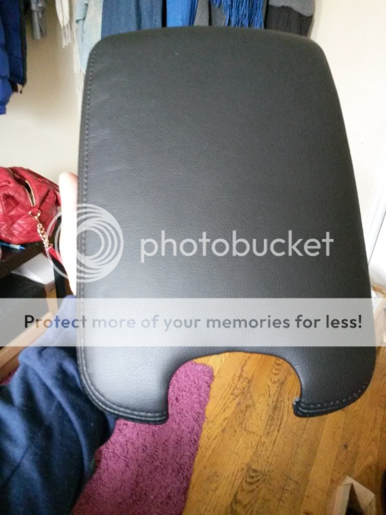

I purchase the material on Amazon and had a profecianal leather shop installed it,they did use small staples .
It came out great ,they also put extra padding ,the OEM padding was so thin.
