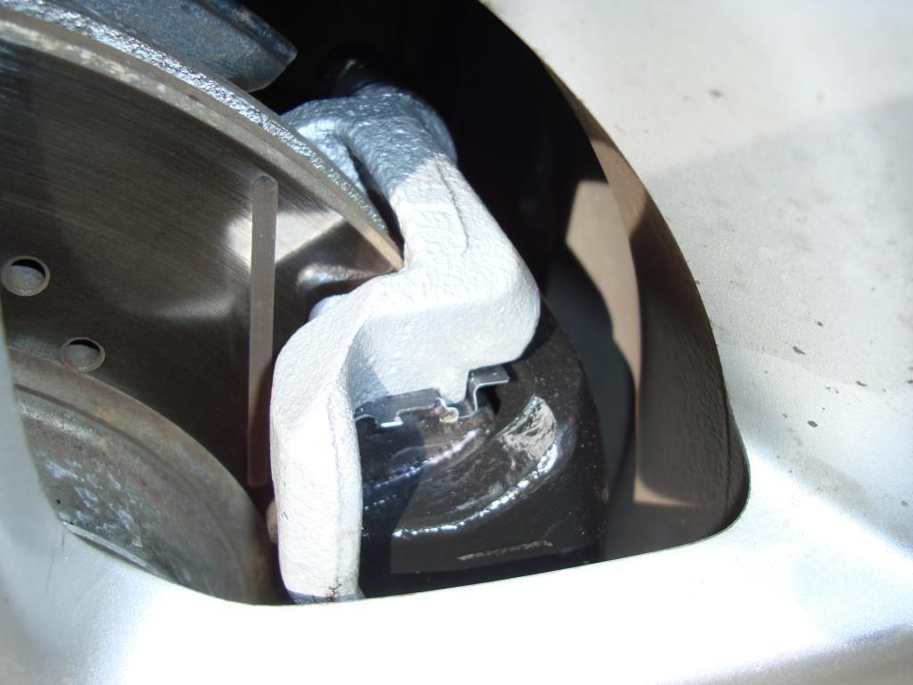

I noticed my brakes dragging and also saw that my driver's side rear wheel was much dirtier than the others. I pulled the wheels off and found that the driver's side rear brakes don't release when the parking brake is disengaged.
The cable moves, but for some reason the "arm" (pictured in the 2nd photo in red) is stuck. I tapped it with a hammer in the direction of the yellow arrow in the 3rd picture and it released, moving approximately a half inch. Does anyone know what would cause it to stick? Any ideas on how to fix it?

Clean it and lube it.
Good for you for pulling the wheels off of your new ride and getting ready for winter. I have noticed that SOME Chicago-area members have problems with the rear brakes. More than the rear brakes of members in cities that don't dump 2 tons of road salt on every intersection every single week during wintertime.
It is a good idea to simply pull your brakes every spring, clean, and re-lube everything including the slide pins.
I suspect that a quick disassemble, cleaning, and re-install (using new brake lube such as sil-glyde) of your existing brake set up will cure your problem. Our parking brake is "mechanical", so lube is needed there- road salt eats it away. I don't think your cable is frozen, I think it may be the point which it attaches to the caliper needs cleaning and lube.
Would be good to remove rotors, pads and check that the caliper's piston itself is not frozen stuck.
When I pulled my rear brakes in May (after a two-year hiatus) my rear brakes were this/close to failure. No lube, uneven wear, etc....From now on, I work on my own brakes.
See less See more
ROADSTER: Good for you for pulling the wheels off of your new ride and getting ready for winter. I have noticed that SOME Chicago-area members have problems with the rear brakes. More than the rear brakes of our brothers in cities that don't dump 2 tons of road salt on every intersection every single week during wintertime.
I've been doing several brake jobs on Accords this year, including my own. I concluded that it is a good idea to simply pull your brakes every spring, clean, and re-lube.
I suspect that a quick disassemble, cleaning, and re-install (using new brake lube such as sil-glyde) of your existing brake set up will cure your problem. Our parking brake is "mechanical", so lube is needed there. I don't think your cable is frozen, I think it may be the point which it attaches to the caliper needs cleaning and lube.
Thanks RickBlaine. Cable is definitely not stuck. It moves, the arm doesn't. I don't suppose there is a step by step thread with pictures that shows the disassemble and cleaning you referred to?
That whole mechanism should be lubed up. Ideally you would disassemble and rebuild the caliper. For now, keep the moving parts lubed up over the next few days to see if it gets better. If not, definitely time for a rebuild. My $.02 is that you might as well get new rotors and pads since you're doing a caliper rebuild...and since you're doing a rebuild you might ad well paint the calipers. But if you're getting new stopping hardware, you might as well get nice pads...and since you're getting nice pads you might as well get nice rotors. Since I'm on the topic of getting nice rotors, you might as well spend the extra cash and get the larger diameter Pilot rotors and caliper relocation brackets. And this is why I'm always broke.
Roadster, those two bolts which are compressing the rubber boots in your first pic. Those are the slide pins. Take them out, rub them down with steel wool then grease them with good quality caliper lube as Rick said. That is the single most important step you can take to prevent caliper lock ups.

Thanks again everyone for all your help. RickBlaine, I agree with you--Eric the Car Guy was a great help to me as well. I watched his complete rear brake job video twice.
I ended up having to replace the driver's side rear caliper. I don't believe anything short of rebuilding the caliper would have fixed the fact that the cam for the parking brake would not disengage without the help of a hammer.
Rotor and pads were OK, so I left them for now and will most likely change the rotors and pads in the spring. Removed the caliper and saw that the boot for the piston was damaged. Not sure what effect this had on the operation of the brakes (feel free to weigh in), but either way, at that point I was already committed to changing the caliper out.
Everything was smooth sailing until I got to the point where I had to connect the parking brake cable to the new caliper. That was tough. After about 25 mins of playing around with it, I got it in. The bleeding of the brakes was another pain, but in the end it all worked out great. Brakes work perfectly! Last picture is the finished product.

Roadster, be prepared to do the passenger side as well. Mine failed within 6 months of each other (95k miles or so). Like you, I didn't bother to spend the time to rebuild it and bought new calipers instead. Didn't have a problem for the next 30k miles when I traded in my car.
Silicone brake lube is better since it's designed for the harsh environments. Anti-seize may cake up over time depending on the type of anti-seize you use.
And yeah, I agree based on your excellent photos- that caliper needed a rebuild or to be replaced with a re-manufactured unit (as SSMV6 said- watch the other side!) When a brake caliper's piston boot seal is cracked, it means the piston seal (you can't see it unless you remove the piston) will quickly fail and then allow brake fluid to be exposed to air and water. THAT can lead to the ABS failing.
You were prudent and did well. When you see a damaged boot- you must rebuild or replace. These are brakes, after all.
