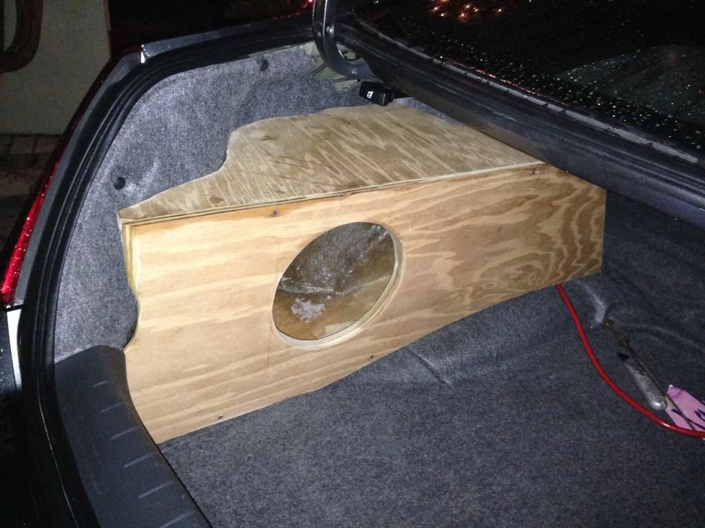

Nice work. Looks like a pretty good sized box! What are you going to use?
