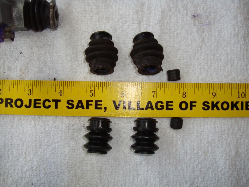

The front brake's upper slider pin with old (above) and new (below the slider pin) rubber bush:
Old and swollen (on the left) vs. New and original size (on the right)
I picked up two new little rubber bush sleeves and could instantly tell that the swollen old ones were restricting movement.
I know rubber can swell up and expand over time, and more rapidly if you use the wrong type of brake lubricant. I am not knocking the Permatex stuff (those little rubber bush things and rubber boots are original to the car- now 8 years old) but decided to use good old Sil-Glyde (NAPA carries it, so does Advance Auto, O'Rielly's, all the usual suspects) on the upper pins with the new little rubber bush things. They slid in very easily....
Anyhow, next time you do your brakes, look at those little rubber bush sleeves and determine if they are swollen. I replaced them and all four swollen boots- the whole front set was just $7.99 at O'Reilly's Auto parts (PART NUMBER 13521Q and it includes new shims- such a deal!). Look at how the original ones swelled up in 8 years!
Old ones on top (like a prize-fighter that should have retired long ago
Now I have happy brakes:
