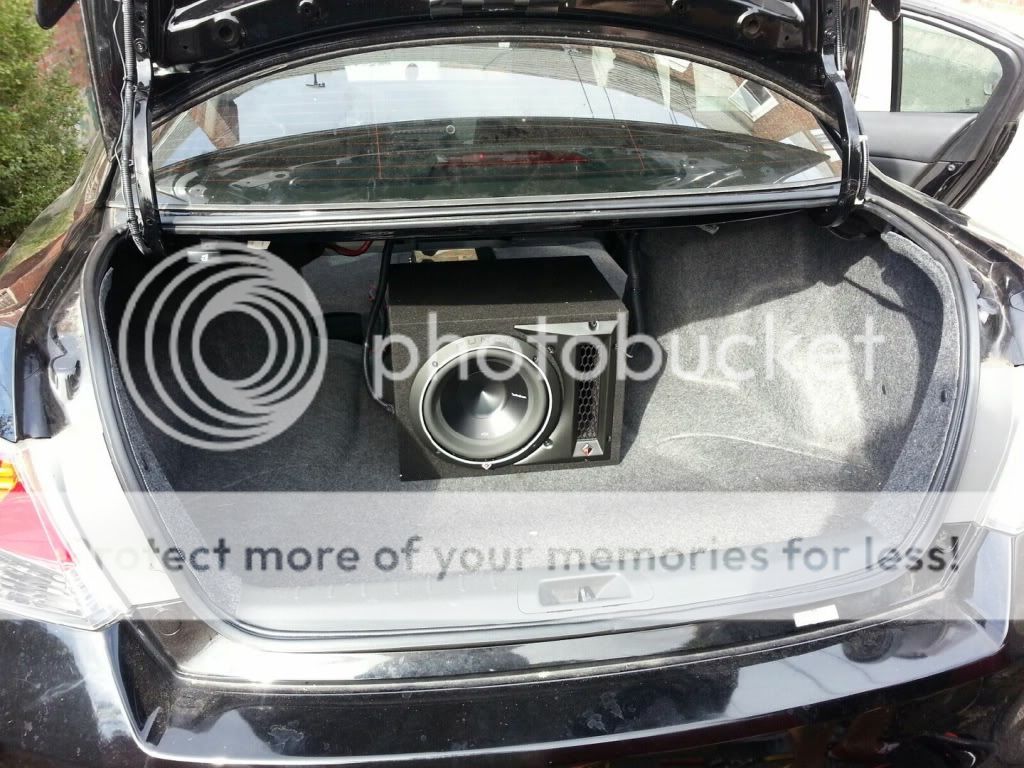

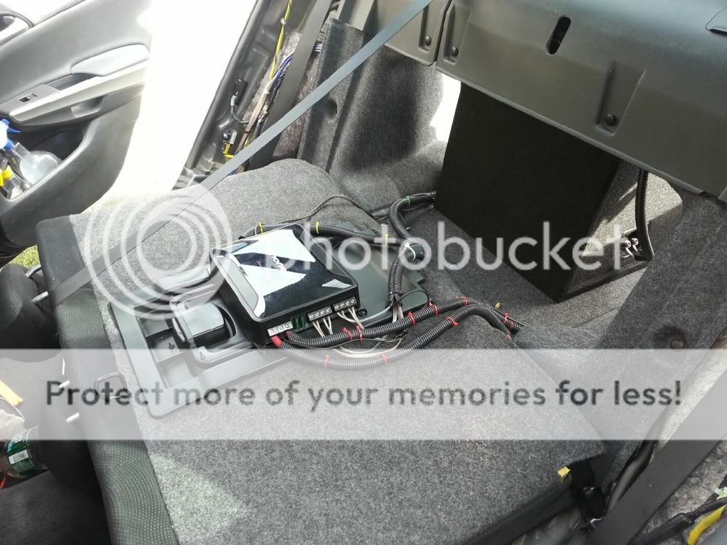

well as you all know ive installed a complete stereo system upgrade on my 09 accord sedan ex
my sub box was too big so i changed it for a single 10" ported box and it fits perfectly !

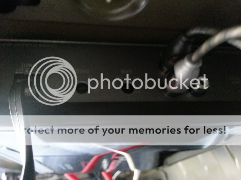

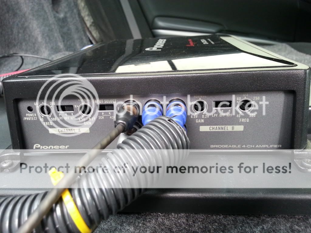

one question for all the audio experts what will be the best settings on my amplifiers ? one 4 channel and one mono , i have:
front components - 100 rms @ 4ohm
2 rear coaxials 60 rms each @ 4ohm
1 10' sub 500 rms @ 1ohm
stock head unit using LC6i line out converter , thanks

yeah I would run a 400x4 to the front and a single ten maybe a 500x1 to the sub. I hate the way the did the trunks in the 8th gen. I have a single 154 in a sealed enclose because of the problem you had with the fitment of a 2 12 box. Unless you get a sutom box made for the trunk you are kinda limited on what you can do and still have useable trunk space.

for your gains you should bring it to a shop and let them set it up with a dd-1 or have them use a oscilloscope and let them set it to the max before distortion and than you can use a bass nob to turn it up or down from inside the cabin. Also make sure they set up your crossover when you get this done. You will be very pleased with the results.
