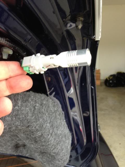

The rear back up lights are plug and play. After disconnecting the power source, simply twist the bulb housing to remove it from the car. The bulb pops right out.

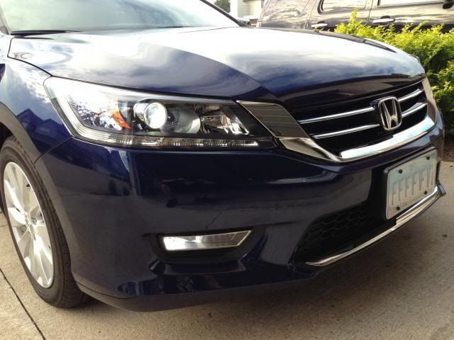

Fogs match the Morimoto XB35 H11 very well. The switchbacks are a little bit bluer. I'm very happy with the results.

Those reverse lights have no side firing LEDs, therefore not taking advantage of the reverse reflector housing.

Just thought I would ask while we are on the topic here of LED'S. What company makes the best,problem free,plug and go,side firing reverse LED'S for the 2013 Accord Touring?. I notice that exLEDusa don't have reverse LED lights at all....wonder why? Thanks,Hot Brass
These have some side firing. I think the ones I have work just fine. Bright enough during the day.

U can get the same ones on ebay for 20 bucks :)
Look for t10 high power ^_^
Yeap. I just got mine. Shipping took a while from Hong Kong, but I don't mind waiting. It was significantly cheaper.
These are the best T10 LEDs I've ever used. Better than the 5630 Samsung LEDs which are already very good. However due to the length, applications/uses are limited to the reverse lights, and front city lights on non-LED DRL trim levels.
These are very white with no hint of blue.
It also gets as hot if not hotter than halogen bulbs. But this could only mean one thing...it uses real CREE LEDs.
