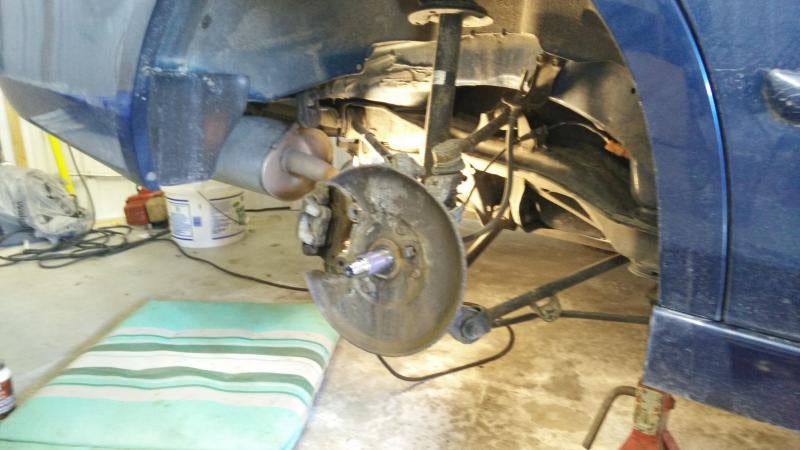

1. First things first, jack your car up and put it on jack stands, you can lift the entire rear up and put the stands on either side or do 1 side at a time like I had to since i didn't have enough space all around the car. http://www.driveaccord.net/forums/attachment.php?attachmentid=230018 (1st pic)

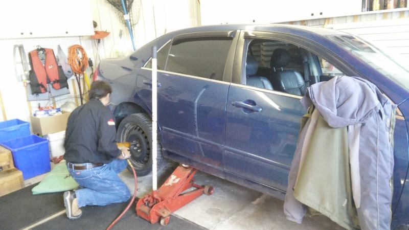

2. proceed to take off the wheel(s)
http://www.driveaccord.net/forums/attachment.php?attachmentid=230026 (2nd pic)

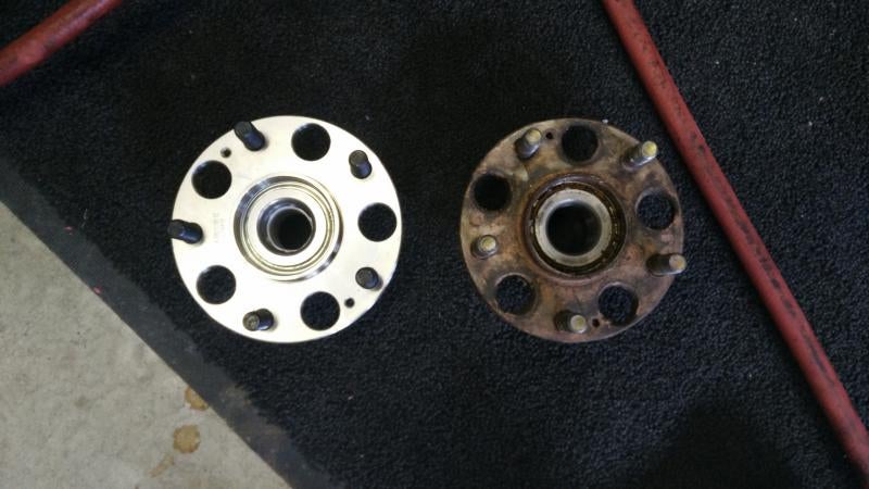

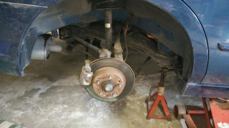

3. You should now take off the callipers and rotors, just as you would if you were changing them however you don't have to take the pads off (unless of course you are changing them while you are doing this)
It should look like the third picture below, just with the bearings housing, i didn't have a picture of it with the bearing there (3rd pic)
4. here is the old one vs the new one. doesn't look too bad for having 230k on them http://www.driveaccord.net/forums/attachment.php?attachmentid=230050 (4th pic)
5. You can now take off the dust cap from the bearing nut. once you have it off it, undo the nut and take off the bearing housing, it should look like this http://www.driveaccord.net/forums/attachment.php?attachmentid=230042 (3rd pic)
