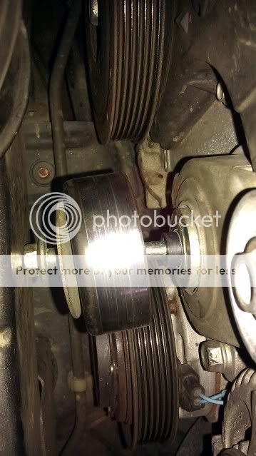

One of the pulleys on my v6 was making a horrible noise on cold days. So I decided to change out both the tensioner pulley, idler pulley (kinda impossible to tell which one is squealing since they are so close), and serpentine belt while I was at it. I got the tensioner pulley off with no problem but the idler pulley bolt is too long to come out; it hits the frame. Can someone tell me how to change it, and a write up would be amazing...

Pulley Removal
2004 V6 Accord
I had the same whining noise coming from the pulley side of the engine. All rpms and operating temperatures. Used screwdriver to listen and alternator was the the strongest vibration whine.
I pulled alternator and took to get tested and it was okay and spins freely and quietly.
I picked up a replacement tension assembly. I see in your picture that the pulley cannot be removed without other methods mentioned. I removed the 12mm offset bolt from under the tension assembly and the whole thing came out pretty easily. New tension arm is alot stiffer and made it fun to re-install belt. Engine runs quiet and I am thankful to this forum.

You need to pull up and move away the power steering reservoir that's it. Partially remove the splash shield by the crank pulley, then you loosen the 12mm alignment bolt at the bottom left side of the auto tensioner. Then you loosen the 14mm middle bolt on the tensioner itself. After this, you can turn the tensioner sideways and move it out.
