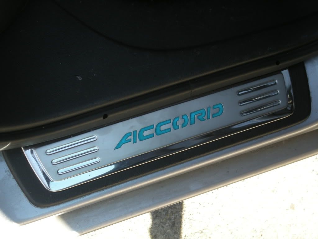

Took a bit of searching but I finally found the door sills I wanted. The only thing is I was hoping for it not to have the stencil look, but I suppose they will hold up better and I can expect that the middle of the A, O, and D will not peel off. Now that I have them in though, I don't mind the stencil lettering at all.
Got em off ebay for 79.00 here on Ebay. The original listing showed a picture of Jetta door sills, but when I contacted the seller he sent me pictures of these so I bought them. Here is a new listing:

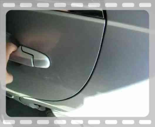

And some video:

I honestly do not know. I did not think about that. I guess I will find out and see how well they hold up!
looks sick :thmsup:
how did you wire them so they light up when you open the door?
Basically I wired the negative wire of each transformer to the door switch, and ran a constant 12v from the fuse box.

I am trying to contact the seller to see if there is any color options. If I wanted to change the color I would just use some transparent color spray. Someone did that to his 6th gen coupe sills on V6P, and he made them red. You can make them any color you want except for white, since they are already blue. I like the blue. If I had a coupe I would change them to red since the instruments are red. I've seen pictures of a Mercedes with lit door sills in this same color. They should be available for the coupe, it would just require some searching. Installation is literally removing six panels and making 9 splices. I did not follow those instructions all the way. I just used it as a guide to show me what wires I needed to tap into. I didn't use T-Taps either, I just used quicksplice connectors. Even without the guide you can trace the right wire by unbolting each door open switch and looking to see what color the wire is. Those are all negative circuits. I didn't even remove any underdash covers or the kick panels in the corner of the footwell. I just used a constant 12v power wire from the fusebox to supply power, and I ran the wire along the weatherstripping on the drivers side and then under the rear seat to the passenger side.
