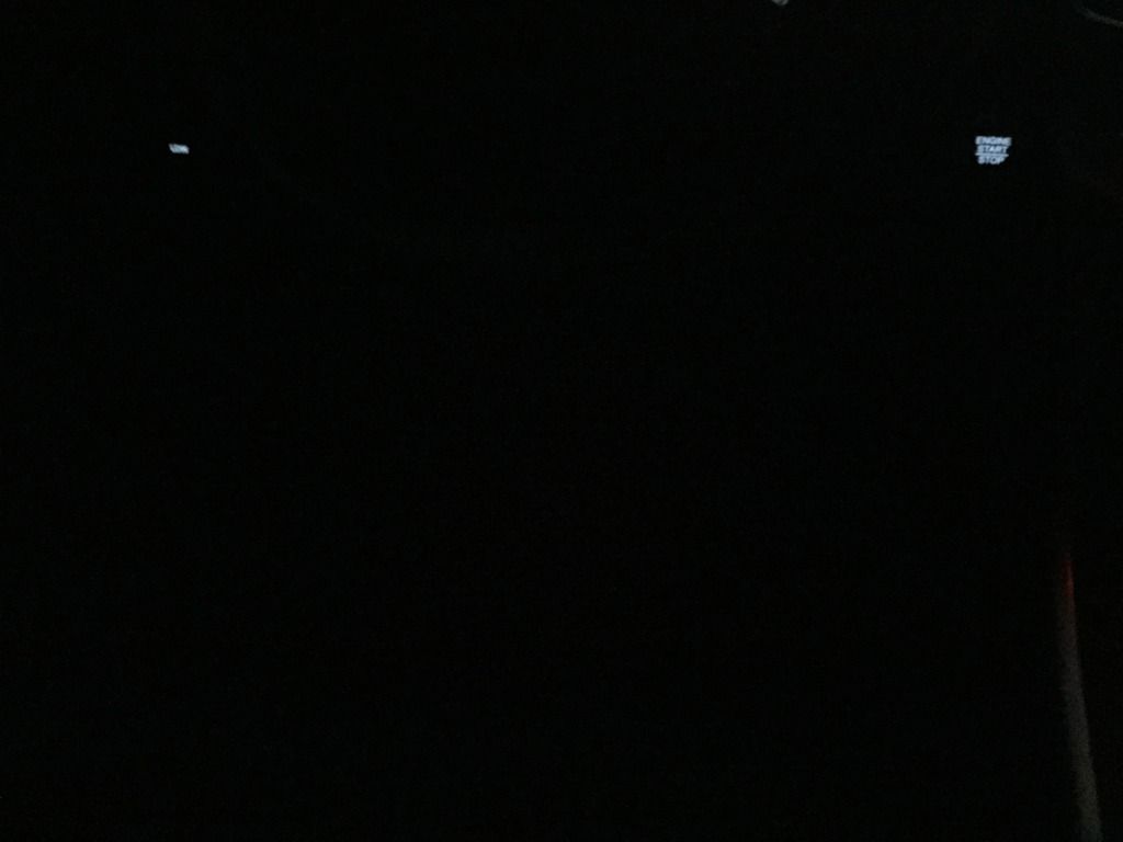

I was one of those saps who wanted the factory interior illumination and paid for it because I've fried some stuff in the past adding interior lights on a previous car. Well, it sucked ass from the beginning. You could hardly tell they were even on. Tonight, I decided to fix that problem and here are the results.
This is the way it came from the factory with the "Illumination" package installed. You can't even tell they're on!!!! This is the driver side.
