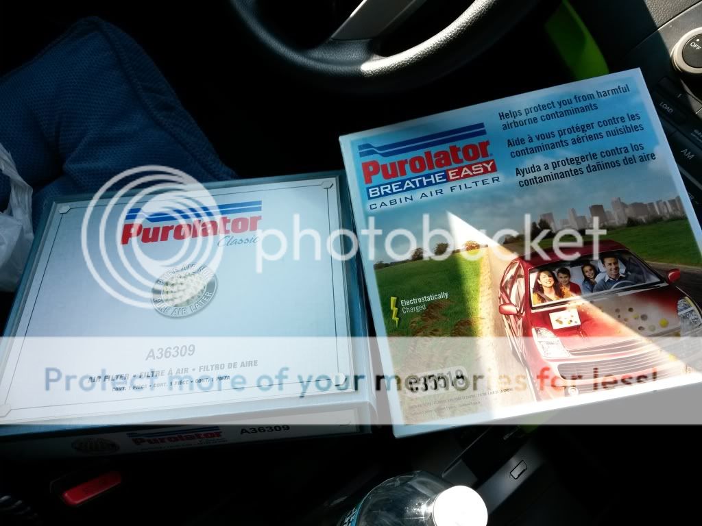

I just changed my air and cabin filter for a peace of mind
bought them at pepboys total came out like 33 bucks for both
very easy 5 min job

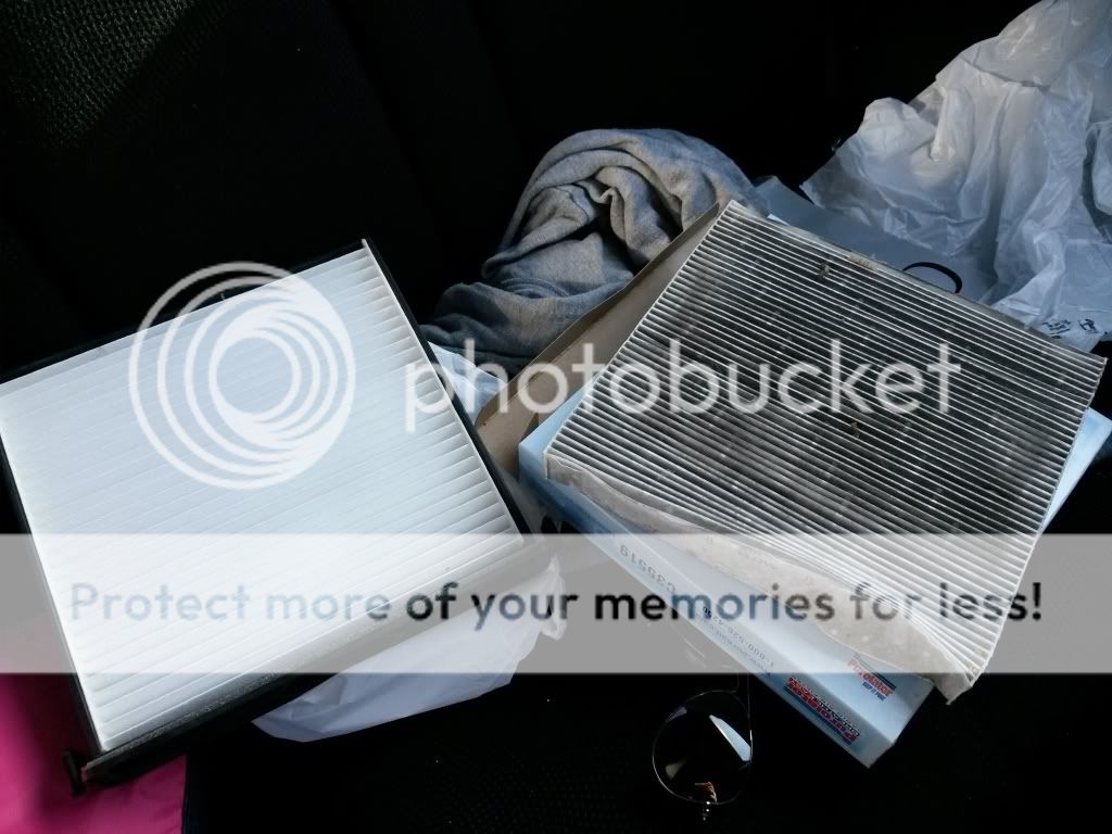

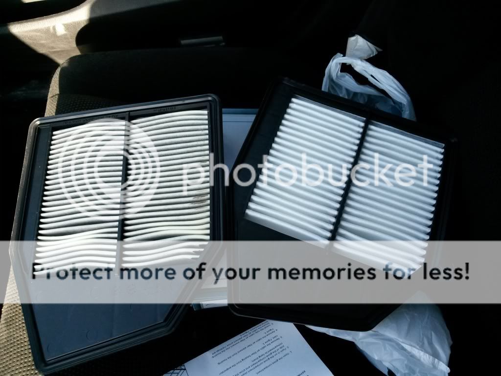

I thought Purolator made good filters...........but look at the pleat counts. Cabin filter ~45 vs ~28, old filter has ~60% more filtration area. Engine air filter ~27 vs ~ 19, old filter has ~42% more filtration area.
FWIW: I prefer original Honda engine air filters (they have a light coating of oil on the media) and Fram Febreze/activated charcoal cabin filters.

you should examine the bottom side of the engine air filter since that's the side that faces incoming air flow.

I didnt check the bottom side of the engine air filter I know there might be some dust as well next time ill clean it as well
