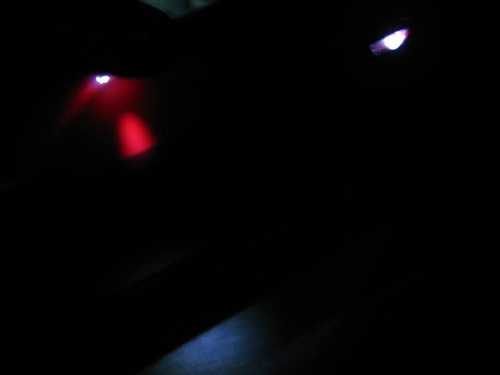

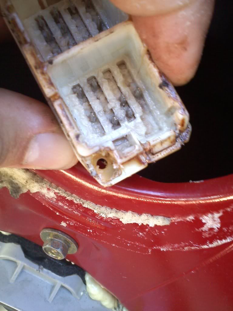

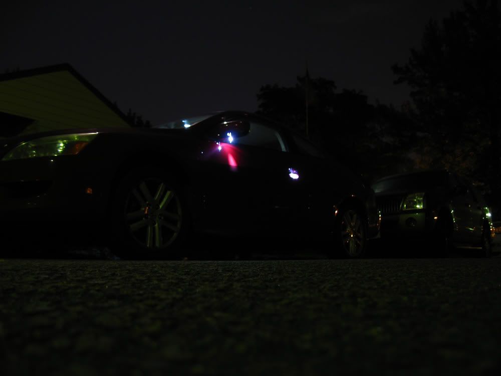

I took some new pictures for those who were asking about the led handle mod i did. Well first off, I took these pictures because I updated my lighting. I added a small LED under the mirror so now I have the two on outside. since the wires were already in the door, it only too a few minutes to do. The first pic just shows the spot it leaves on the ground, its blurry because i was standing; no tripod. Second i put camera on the ground to see the light on door better. The last two add to the pics i have on the other thread (http://www.driveaccord.net/forums/showthread.php?t=51354. It just shows how you have to cut the factory harness thing to get into the door nicely.
detatch the part between the door and pop the part left on the door to the inside
remove the white cover material partially and take the clip off of this harness from the inside of the door (follow the wire down and feel it where its mounted, and work by touch lol.. i cut my arm up doing this) then you can pull it out and drill the corner so later a wire can go through

How did you wire the Leds for the mirror?
Thanks. I took the mirror off the car, and the glass off the mirror. Put the led in the hole that alreadly exists in the bottom of the mirror (fit perfect) and ran the wires through the spindle where the mirror motor wires are (so I could still turn in the mirror without pulling anything). Followed that straight into car along the other wires and connected it to the wires I ran in the door for the handle. When its not freezing cold I'm going to make that a two way switch so that when the ebrake is on and the car is on they stay on. Right now its only when I unlock the car or when the doors are open, but I deliver pizza and it looks nice at night when they stay on when I'm going to a house.
