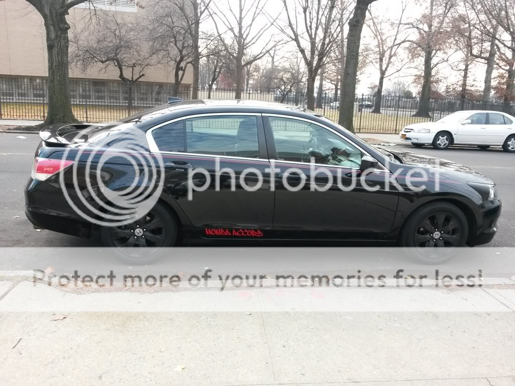

-im looking to upgrade my wheel and tires :thmsup:
-nothing to crazy expensive my budget its like $1200 the most with rims, tires and installation
-i did some research regarding, sizes, offset, bolt pattern, etc
-i definitely want black glossy rims with 5 spokes only , since i wanna be able to paint my calipers, and see them
- i live in new york city with crappy and bumpy roads so im not looking to drop my car, just wanna upgrade the wheels and tires

these are my current oem wheels with plasti dip , they have 7 spokes and i cants see my calipers as i would like to , plus im getting tired of the flat black look from plasti dip
I THINK MY CAR WILL LOOK WAY BETTER WITH NEW SHOES :thumbsup:
