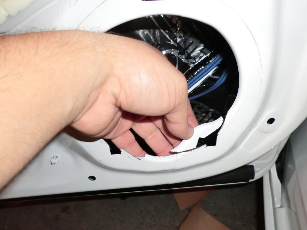

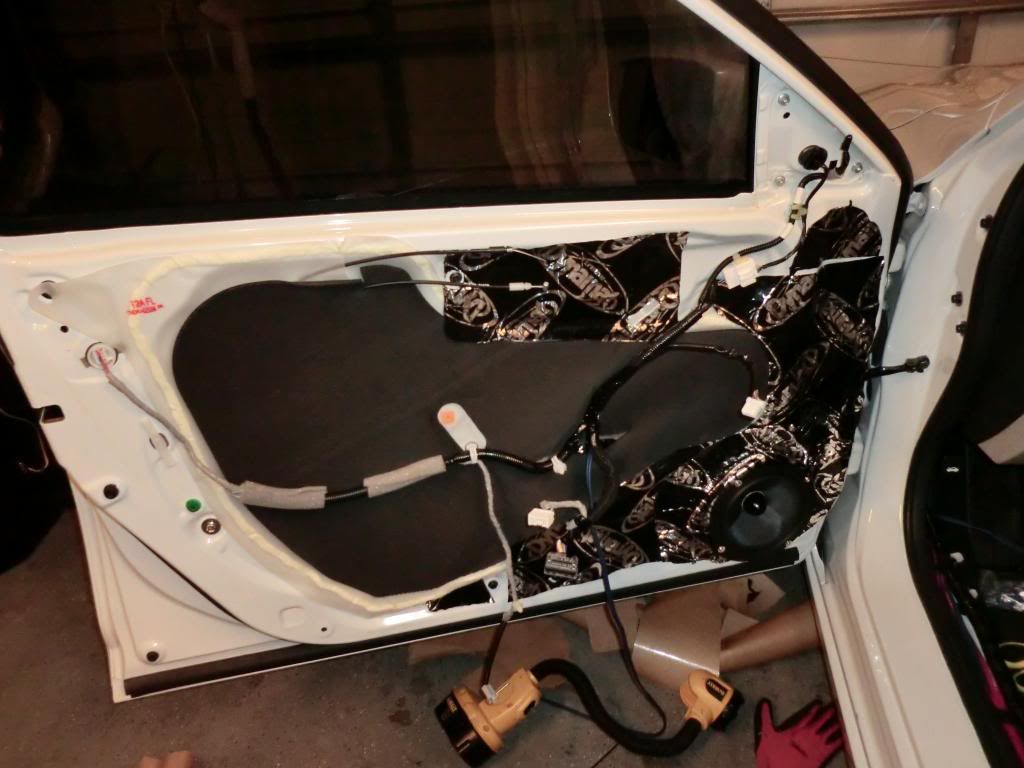

Here's what I have done so far to a brand new 2014 with only 100 miles..lol I have looked for help but this car is pretty new and most guys have not touched it from what I have seen. I am also a JL freak. I know I can find things cheaper but I prefer to stick to JL Audio as they have not let me down and trust me I have tried a boat load of stuff in my cars :).
The first thing I did was make a custom harness form 3 Metra harnesses to RCA's for the Matrix plus LD.
1. Image Dynamic Chameleons in the doors.
2. Dynamatted the front doors
3. Made a custom metal amp rack for the rear trunk
4. Dynamatted the rear panel
5. Image Dynmiac CTX65CS in the rear
6. Audison Bit One
7. 2 JL HD 900/5's. One for Left and one for right :)
8. 2 JL 10W6V3's for Bass
9. Ran knuconceptz 0 Gauge from front to rear of trunk
Obviously I have more amps than I need but I do not plan on sticking with the same setup long. I am looking at the Hertz 3 ways or more choices in the future.

The Chameleon's fit without having to cut the door? CXS62's?

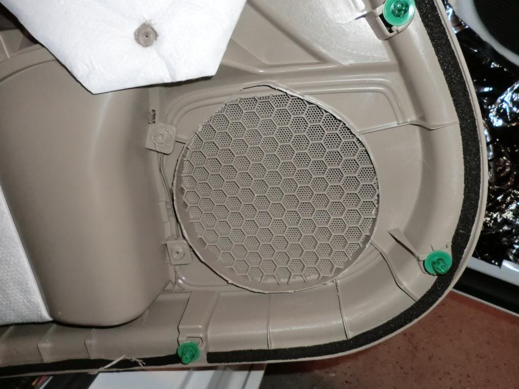

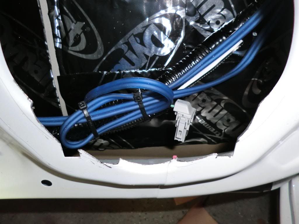

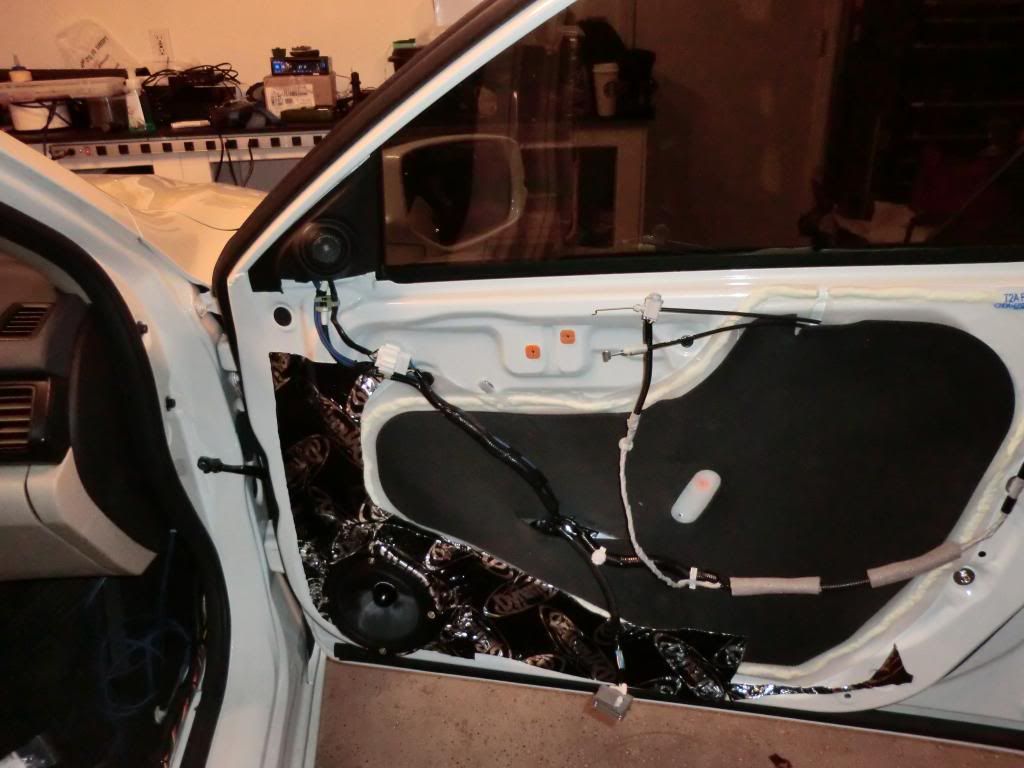

Yes you have to cut into the door but it is minor. Here is a pic.
YOu also have to cut the rear of the panel
The speaker on the door:
The speaker on the drivers side door:
Stock Speaker VS ID Chameleon 64V2. Holly smokes the stock speaker looks Wimpy..lol

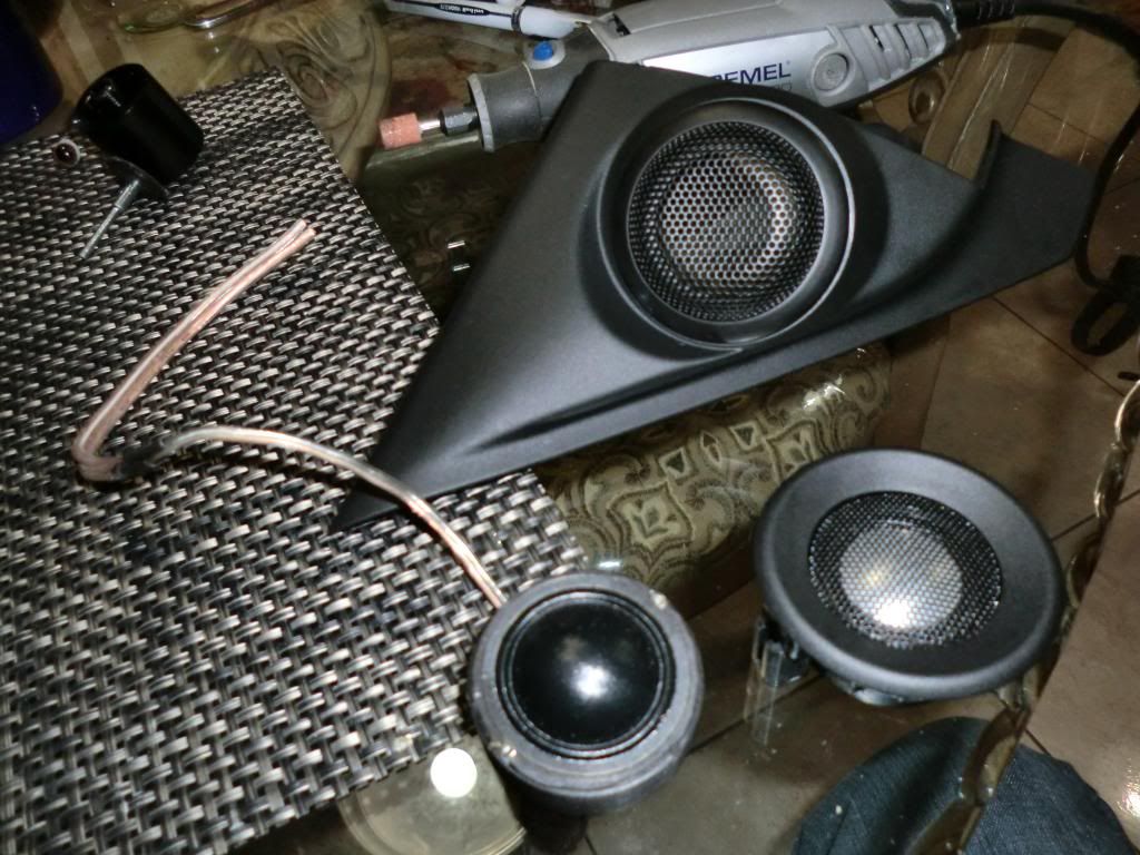

ID Tweeter in stock sail panel

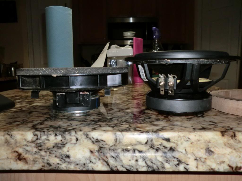

Nice pics! Are your doors still off? If so can you measure the diameter of the speaker hole horizontal where it's not cut and also the depth and report the measurements here?
I put the doors back on and put Dynamat on so I cannot measure it anymore. I would have to take the Dynamat off to measure as you need.
I made a MDF ring from the stock speaker dimensions. So if we can fit a ID Chameleon 6.5 you can fit any 6.5" component mid as this thing has a big magnet :).
So looking at the specs the ID 6.5" mid is 3" top mounting depth. Please keep in mind this is the Extreme speaker you can fit in the Accord without major modifications. The window to the magnet is super tight.
Did you use 1" or 3/4" MDF spacer?

51 Posts
I had to do the same thing in my TL. Cut the door and trim the plastic off the door card. Dremel works GREAT for this job.
I used 3/4". I actually cut it super easy with a new blade but the dremel will work :).
