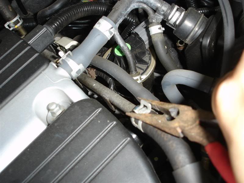

Poor 1/3 of the bottle in the fuel tank, 1/3 in the crankcase and the final 1/3 will be s*ucked through the intake. Be ready to change the oil after.

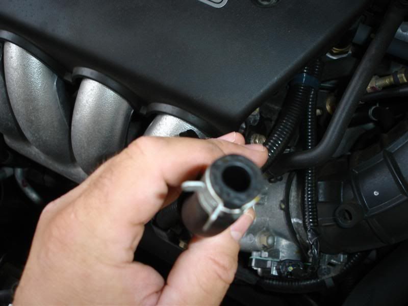

I used this hose for the intake.
Be sure the car is running and slowly poor it in. If you poor it too fast, it will stall! Once it is all s*ucked up, turn off the motor and wait 5-8 mins.

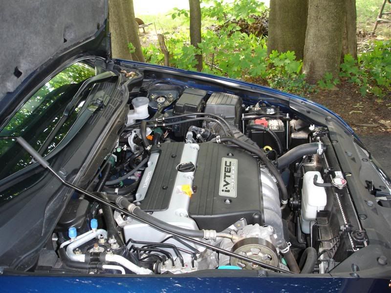

Next I decided to change the plugs. The plugs were pre-gapped in the box to the .44. I use the hood prop hole closest to the cowl which allows me more space.
Remove the plastic cover on top of the motor (one behind the oil fill) by removing the 4 10mm bolts. You can now see the coils. You’ll need to remove two more 10mm bolts securing the coils.

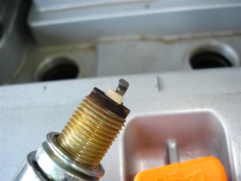

Using a standard 5/8 spark plug socket, remove the four plugs. I found them to be a bit worn, but not too bad. Doesn’t hurt to replace them.

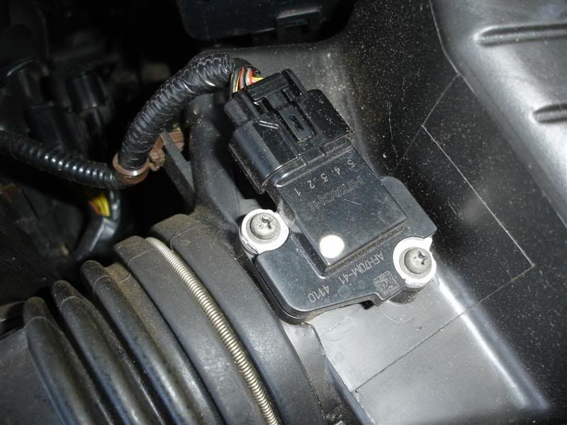

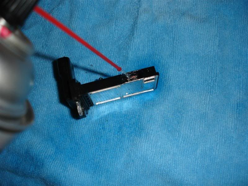

Next I decided to clean the MAF. I use CRC MAF Cleaner which can be found at any auto part store.
Remove the two phillip head screws and detach the wire harness.

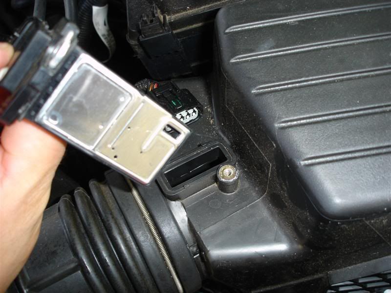

Be careful when working with the MAF as not to drop or bang it as the wire sensors are delicate. Lay it on a shop towel and spray 12-15 spurts of the cleaner on the wire sensors as shown.
Let it dry for a few minutes, and then reinstall it. Start and check for operation.

Question for MAF sensor:
-> When you spray 12-15 sprouts, will the liquid goes to the other side of the MAF sensor case? Or, will it simply dry inside?
Thanks!
It will dry in a matter of moments.
