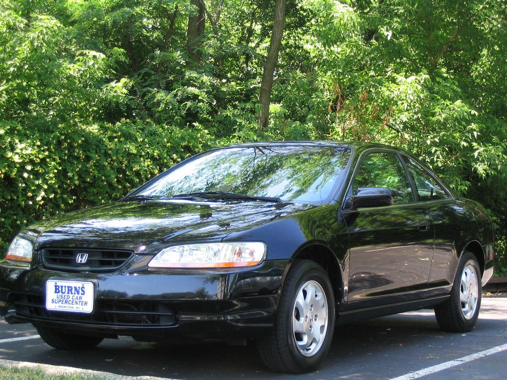

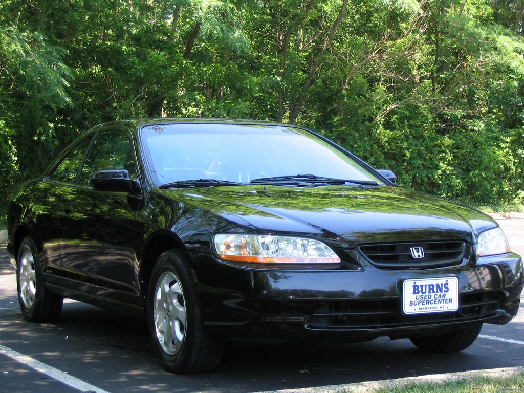

Enne, I know it's significantly more expensive, but do you think you'll ever pull the wrap off and do a bare-metal re-spray? Mine was black currant pearl, and it was a gorgeous shade of black. Reminded me of Knight Rider, when Michael first sees KITT- super-deep black. When I got rid of my '98, the clear coat was failing, but if I had kept it, I definitely would have had it repainted.
(Don't get me wrong: I think it looks cool as it is, but just curious)
At this point I could just buy a 6th gen without paint damage if I wanted one with real paint. I like the idea of being able to change Selene's color whenever I want for about 1/12 of the price of a full repaint.
So I probably won't ever get her repainted. If someone offered it to me I wouldn't say no, as she could use it to even out the finish, but I like her the way she is just fine.
