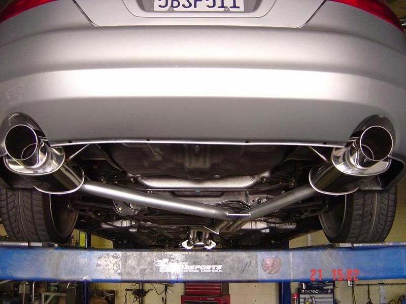

Do I just replace from the 3rd cat on up to the pipe splitter with 2.5" piping? would it be better to go with 2.25" piping to make sure I dont lose too much backpressure?
Ok, i just joined this site, so therefore heres the late reply, but i just cant get over this freakin sweet exhaust set up. I cant stop druling over this, which was found in the first post with the link. I come from previous domestic muscle car experience and this definately catches my eye. Too bad i dont have a V6. LOL :jawdrop:
http://i43.photobucket.com/albums/e358/flydealz/6365Custom_Exhaust_002.jpg

I'm a new member and I was about to do the stage 2 on my 03 accord v6 coupe, but then when i took my car to the exhaust shop, they told me it would sound exactly the same if i just switched the resonator. I ended up jumping from stage 2 all the way down to stage 4 lol. I don't understand why on video it sounds so raspy for the tl's, but for my car it sounds pretty damn quiet. It sounds only a little louder than stock. It has a slight G35 sound to it as well. There's no rasp at all...AT ALL. So if anyone wants to know, i removed both the mid-muffler and the resonator and replaced both with 2.5in straight piping.That's my experience...hope it helps some people make decisions.
