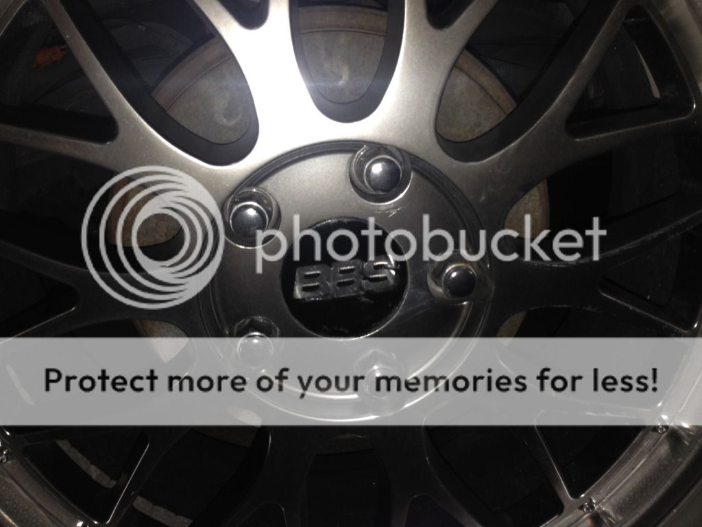

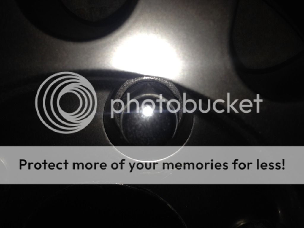

I have never came on to such a stupid search before, i am trying to buy a set of muteki lug nuts (12x1.5) im not sure if the diameter of the lug nuts or even the lug nut key will fit in the lug hole, im running oem lug nuts which are 19 mm and they look perfect in there but i need to run an acorn shape lug nut (tuner, muteki). These are 22mm lug nut and 24mm lug nut key. As mine right now are 19 and fit snug (oem lug nut and crosswrench), heres the link to the lug nut

Heres pictures of my wheels
Or could it just be that i went full retard and they meant the overall width is 22mm including the lug nut itself, i just seen they use a 17mm socket size which is smaller

You need to remove one of those lug nuts and look at the seat of it and make sure it is the correct type. For example, you can't use a cone seat lug nut on a conical surface of the rim.

Yes i have the acorn seat the 60 degree one, i ordered a set of lug nuts.................by fitting i meant width wise though
