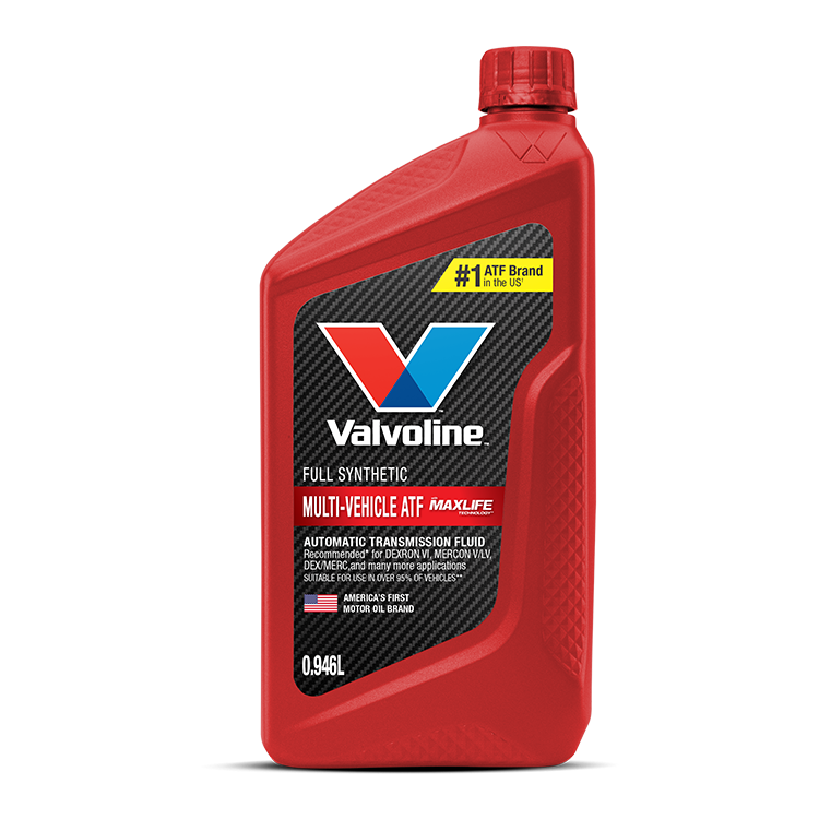

Volvoline ATF here says that It's approved to use except CVT:
BTW, Is Amsoil approved for Honda DW-1 CVT? Since you are using full-synthentic, How frequently you change it? Will you go higher miles than 30k? If I think to follow you, Can I mix it with the current fluid and set the baseline in Amsoil? The three quarts for Honda OEM costs $32 here.
