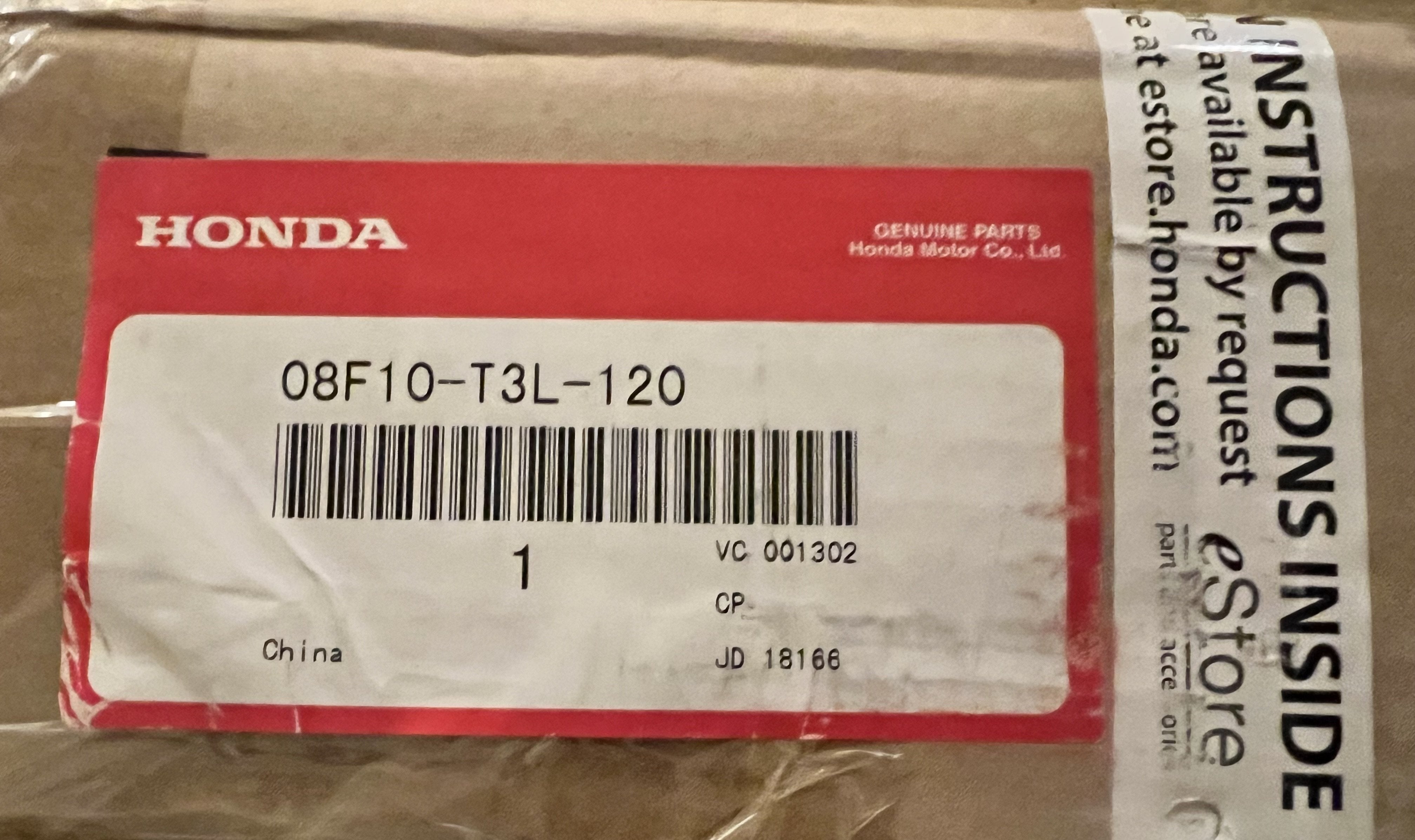

Just bought a OEM deck spoiler my 9th gen accord coupe and wanted to know how I could go about getting the installation instructions outside of the dealer. Can I source trunk lid schematics from anyone? I have a photo of the part number, has anyone attempted to replace their OEM factory spoiler? Any tips or installation advice would be helpful.
Box says instructions inside?
The sticker on the box is cut off but it actually said no instructions included. Not a huge deal tho, the install was pretty straight-forward aside from prying the old spoiler off, in the process I managed to cracked the high mount brake light assembly, so I had to order a new one.

Just bought a OEM deck spoiler my 9th gen accord coupe and wanted to know how I could go about getting the installation instructions outside of the dealer. Can I source trunk lid schematics from anyone? I have a photo of the part number, has anyone attempted to replace their OEM factory spoiler? Any tips or installation advice would be helpful. View attachment 556446
