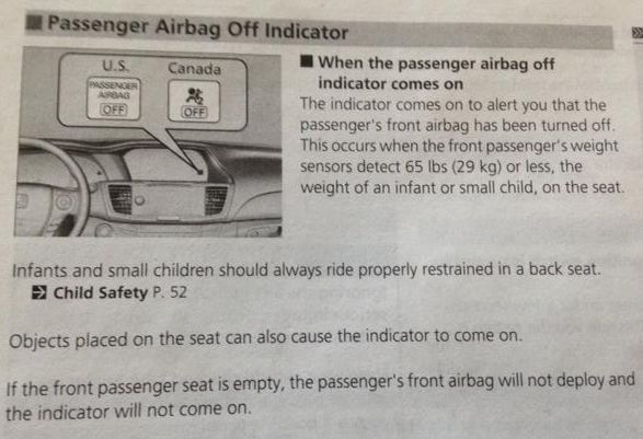

Looks can be deceiving, p. 45 of the owners manual has the answer to your question and details impact forces that cause deployment.
If you did not have a passenger in the car, the pass airbag should NOT have gone off. It is deactivated with 65 pounds or less in the seat. .

That is not entirely true. If the air bag "off" light is not illuminated the passengers air bag could deploy, even if no one is in it. I don't understand the logic, I just know it's that way.
Jay
Jay
See the last paragraph from the OM.
Understood. But, I know people with late model Hondas and other makes that got into accidents with no one in the passengers seat and the air bag went off.
A friend just totaled her late model Oddy when someone ran a stop sign on a backroad intersection. No one in the passengers seat, passengers air bag went off.
Another friend had a Silverado that was totaled when someone took a left right in-front of him. No one in the passengers seat, it went off.
I operate in the notion that thing is live and ready to blow at anytime.
