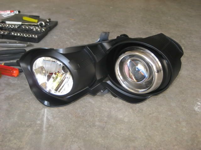

well... im almost done so here are a few pics that i wanted to share with you guys. please be gentle!!! ive worked my ASS off getting this setup together... im EXHAUSTED!
BULBS: philips 85122+ D2S
BALLASTS: ddm tuning slim ballast
PROJECTOR: FX35/44 bixenon with R*source replica clear lenses
here are a few pictures:

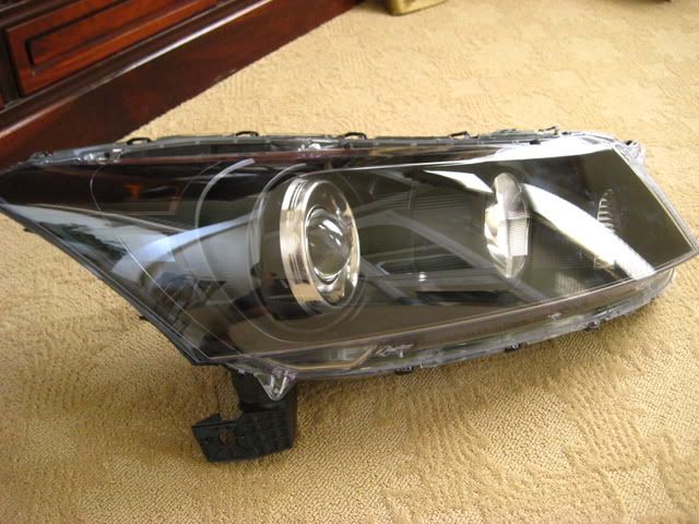

the lobeam projector and regular halogen hibeam

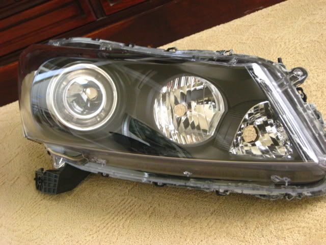

the final product
i only have one side completed right now

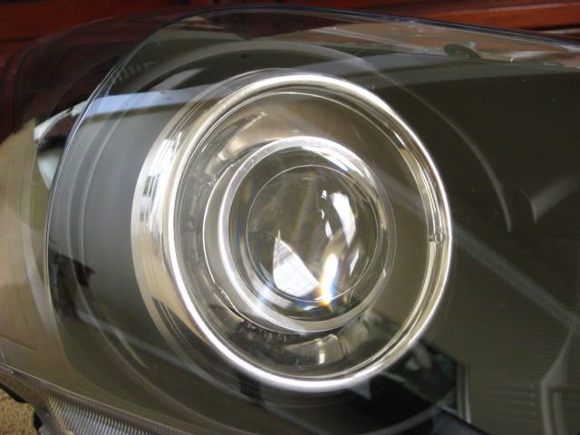

close up of the projector and shroud

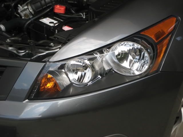

taking off the oem headlight

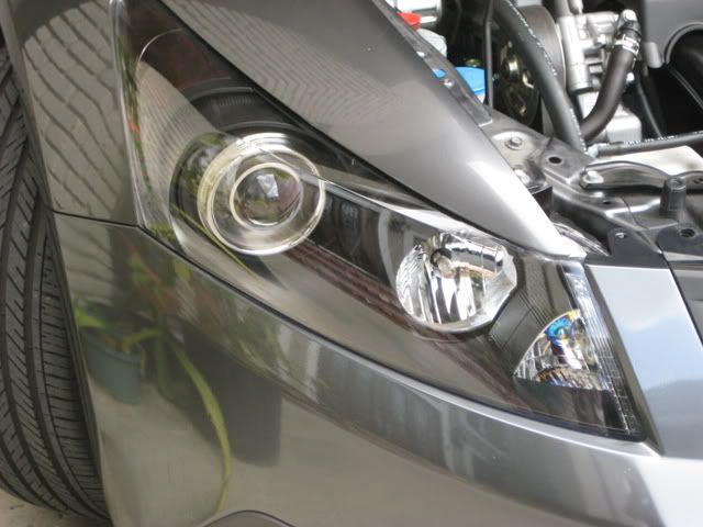

just installed the new headlight
the final comparison:
new projector retrofit on the passenger side
versus
oem headlight on the drivers side

a few pics of the final result
this is one of the things that is really bothering me. i went about 1-2 shades too dark on the smoked side reflectors. i wish there was just a hint more of the orange.

what else is needed to do the retrofit besides the projector lamp and hid bulb, such as shrouds? you'll need to get a ballast to power the HID bulbs. you'll also need shrouds as you mentioned. you'll probably want a spare set of headlights (which im selling :naughty:). and also miscellaneous tools.
where to get them ? i made my own shroud. but you can go on theretrofitsource.com to buy shrouds.
