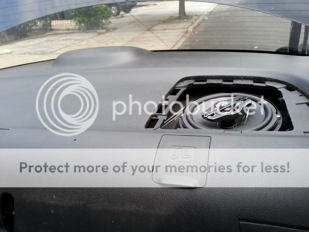

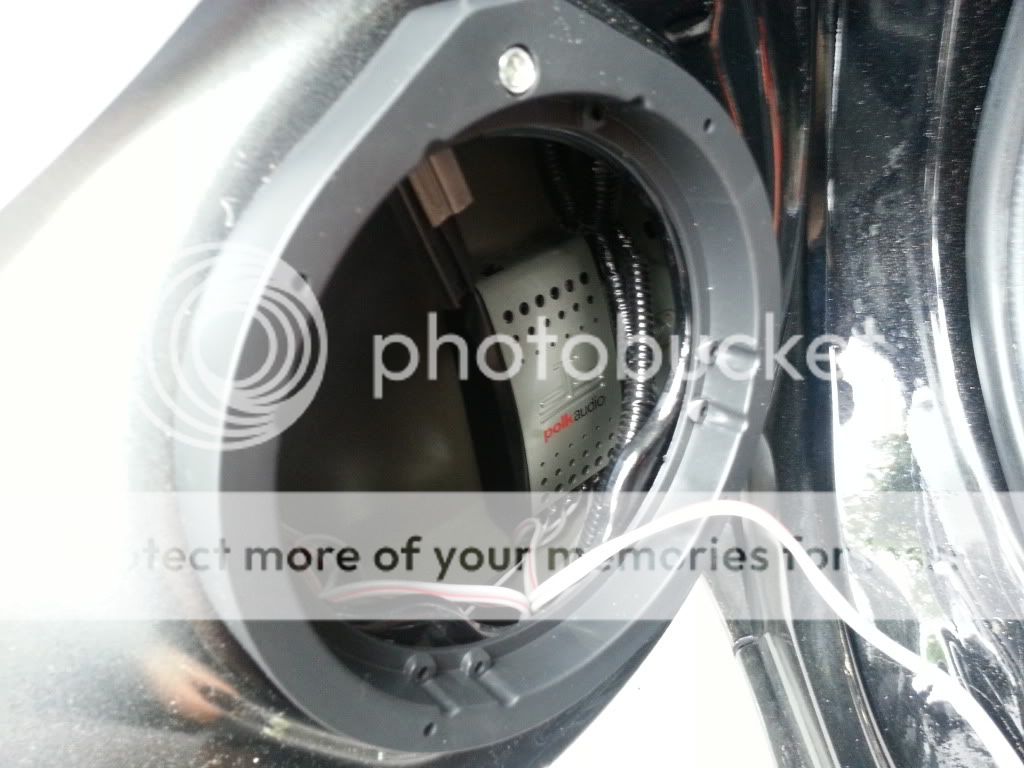

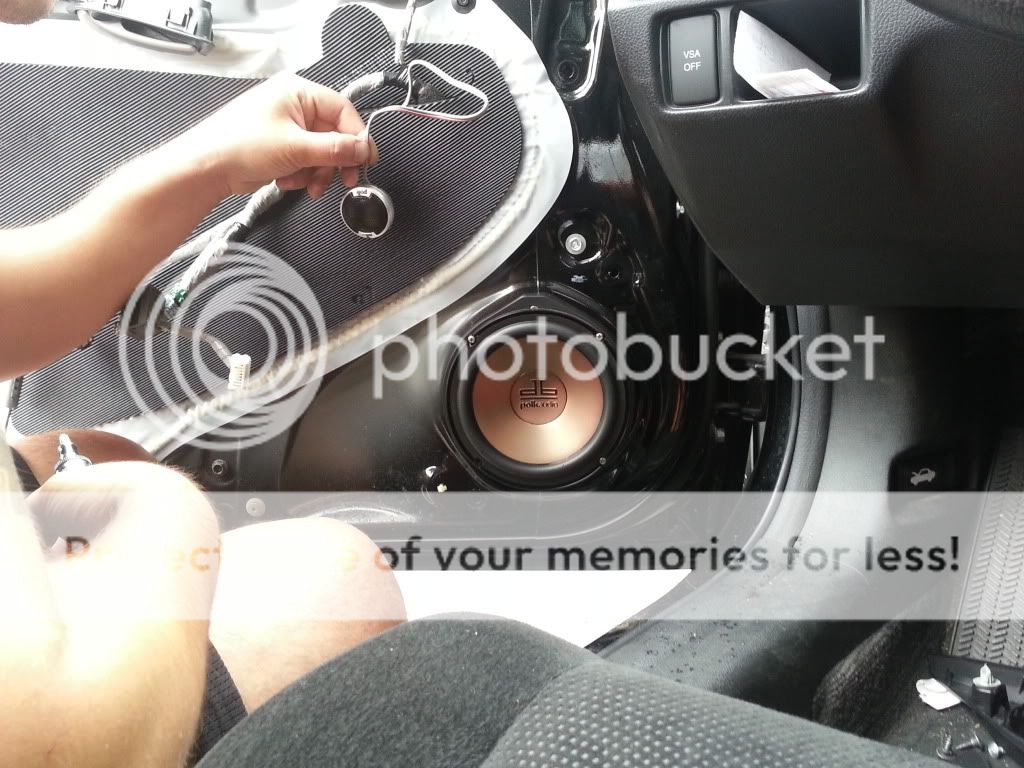

front components installation with crossovers

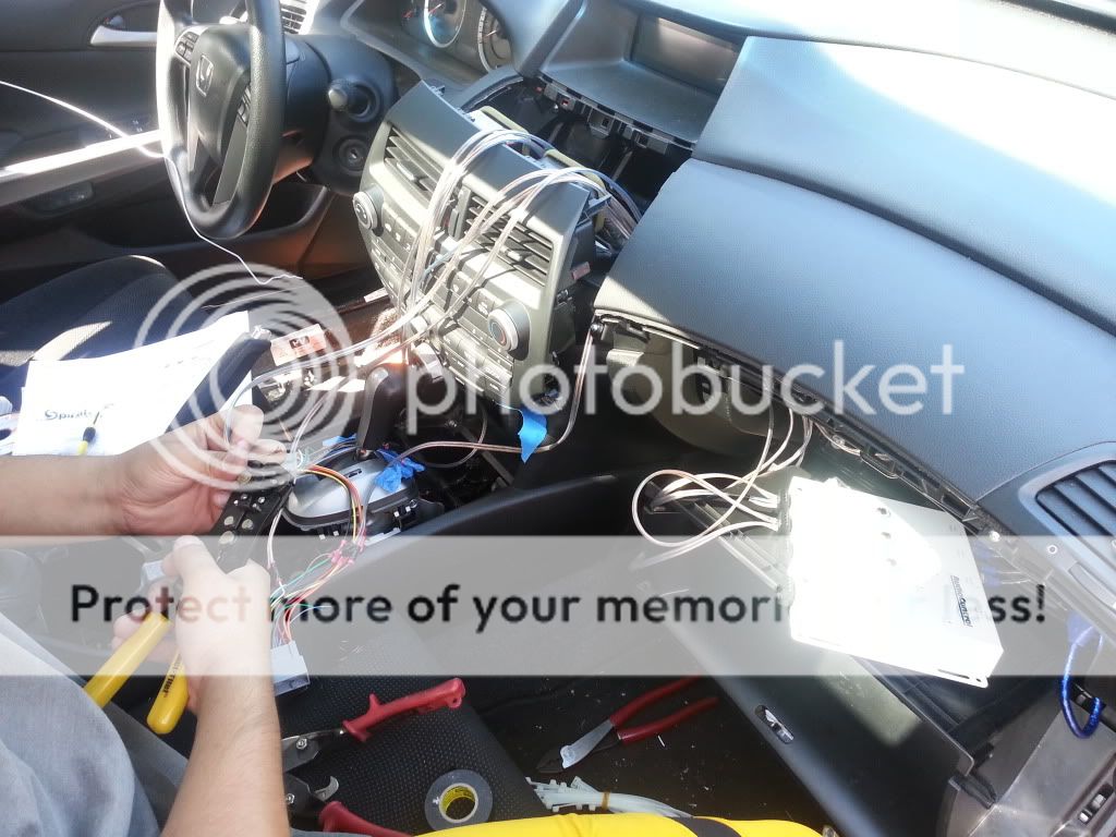

i bought an aftermarket harness to avoid cutting my stock radio harness but i would give up on my steering wheels volume controls so thats the downside but overall it doesnt bother me , it was so much easier to make my own harness connection with this one

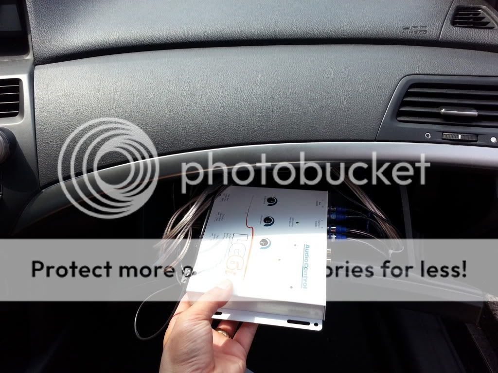

i use my glove box compartment to place my line out converter i figured it was easy for me to access to it when i tune it !

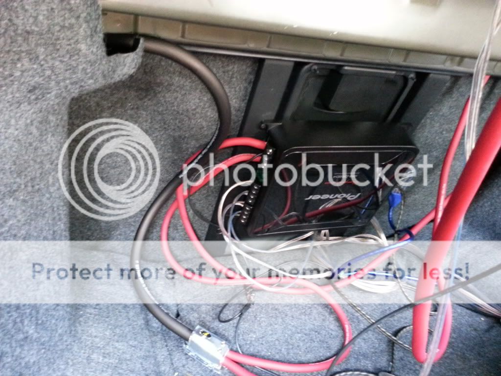

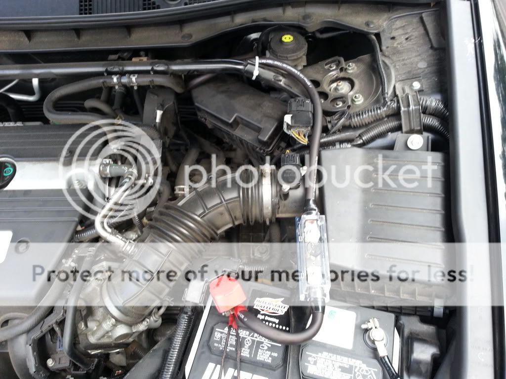

run my 0 gauge power wire tru the firewall this is where i broke my friggin nail lol

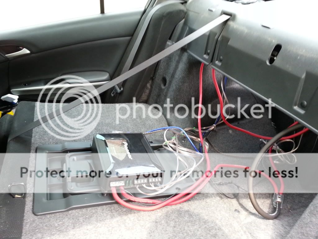

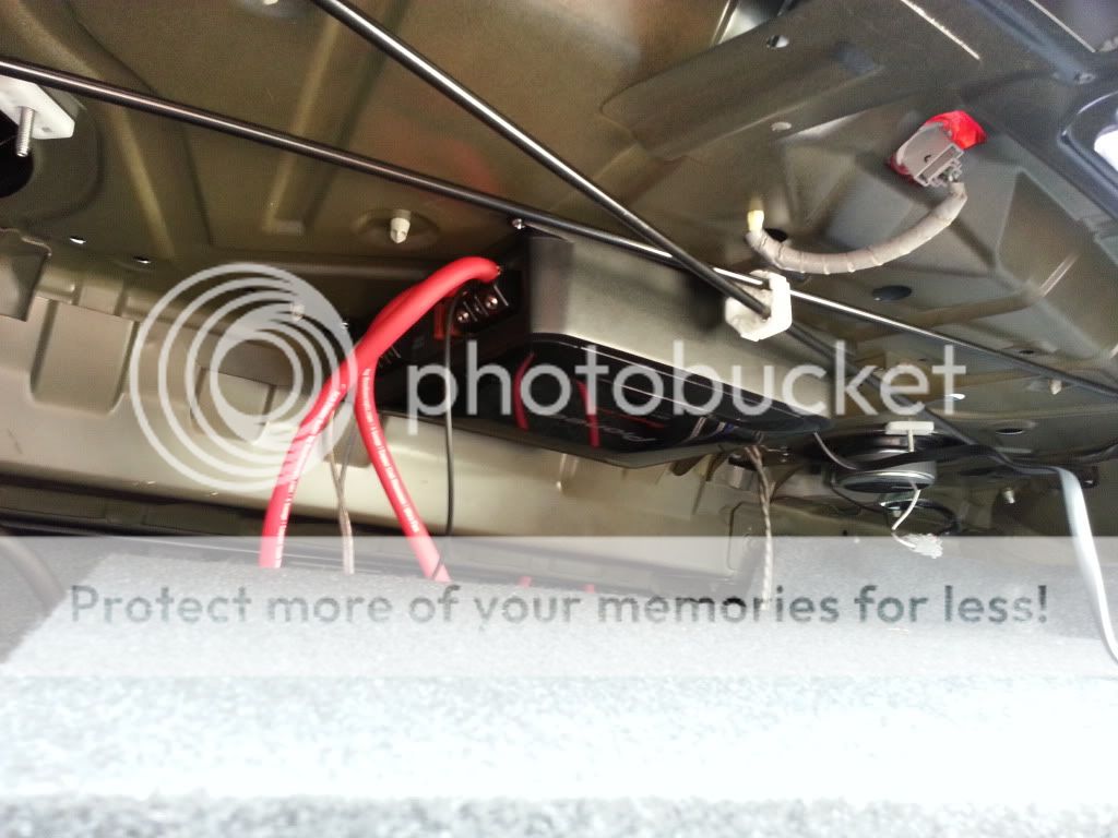

i mounted my amps on the back seat and the other one below my rear speakers panel , but it need to organize all the wiring

speaker brackets and harness this was HUGE to make life easier
and also i need to find a good ground
i run my power wire on the driver side and my rcas and speaker wire on the opposite side

not to sound overly harsh but here we go... i'm not sure how you lost wheel controls if you're still using the factory stereo. the sub box is far too large for your application and will consume most of your trunk since it can't be pushed back against the seats. also, the wiring is a horrible mess. i always address a clean install during the installation itself to avoid double work in the end. that would help keep your signal and power wires as separate as possible and potentially prevent your interference issues. ...did the rear grilles fit back on?
it's good to DIY but a clean install that looks like a non-install is always the way to go. this setup looks like you've effectively lost a glove box, wheel controls, and 75% of your trunk space for an average quality system. last, and while you obviously love ebay, buying electronic components there is generally not a good idea since you will usually have zero warranty and/or customer support. i'd have probably drawn up what it was that i wanted/expected and my budget and shopped around locally. being that you're in a highly competitive metro market you probably could have gotten the same (if not better) components and a more tailored install within your budget.

and yeah doom i still have no idea how i lost my wheel controls since the aftermarket radio harness had 12 pin and the stock has 15 so i guess one of those wires was the wheel control ... i guess im stock with my big sub box lol, ill figure something out and i will try to relocate the lc6i as well if i find a better spot what would you recommend !

i'd get a better designed box that follows the contours of the trunk and either mount the components on the seat facing side or even better, make a flush mount wall on the visible side of the trunk. if the amps are shallow enough the ideal setup is to install them under the seats. my idea of an install is to have nothing immediately visible except the subs.
agreed with Doom. Not sure why you're using an aftermarket harness while keeping the stock radio. The ground noise could be coming from any number of things. Most likely culprit are bad grounding for the amps/LC6i or cheap RCA cables (or both). Why didn't you mount the second amp to the back of the rear seat like the first? Most amps are not designed to be mounted directly to a metal surface which may be causing your interference also. They should always be mounted to an insulated surface. Also noticed you mounted your crossover for the front components inside the door cavity. Not a great idea as it gets wet in there when it rains not to mention i don't know how you would have mounted them securely in there. To give you some ideas, i have mounted my 5ch amp and my signal processor under my front seats so that all you see in the trunk is the sub box. My goal was a completely stealth install (other than the sub). You could maybe move the LC6i to under the passenger seat to at least get your glove box back.

I had similar issues with my 7th gen, What I ended up doing was buying another set of wire harness and extracting the wires then insert them into the first set of harness. That way you convert the 12 pin harness into a full 15 pin harness.

You can get the amp off the metal with some plastic washers or some other substitute. You never ever want mount an amp directly on metal. That is amp install 101. Also run the RCA cables, shielded or not, on the opposite side of the car from the power wire or least somewhere that has a decent amount of space between them (if you didn't already) to minimize noise. I would also try running separate grounds for each amp because it looks like you are sharing the same ground. This can generate unwanted noise. Guage of the ground should match the power wire gauge going into the amp. Never go smaller.
A distribution block would might also be a good idea imo to use going from 0 gauge to the smaller gauge and should make life easier organizing the wires in the tight spaces cars provide. FYI, The size of the power wire will not matter when coming from the distribution block as long as it is mounted close enough to the amps. Distance is the enemy and why bigger gauges are used. Larger gauges are only necessary because of the distance between the amps and the power source. You might have been able to get away with smaller with this setup imo. Plus dealing with the smaller gauge wires allows you more options for wire management. To clean up the rats nest you have currently, the easiest way is building a false wall to mount your amps on. It is very easy to get matching carpet to wrap it in. You can then hide all the wires behind it which in turn helps make it look a lot more professional.
