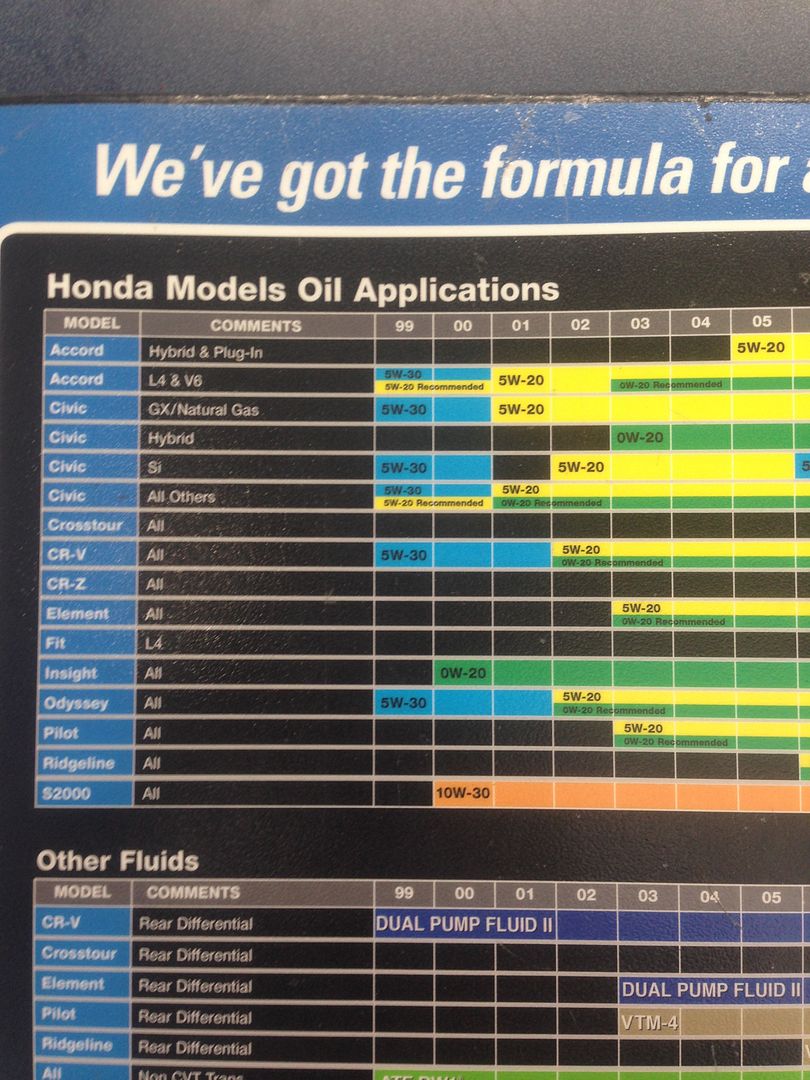

Saw this at the dealer yesterday.

Yeah they recommend 0W20 now on pretty much everything except the S2000 and stuff before 2001. They're not allowed to retroactively change what's required though, which is why for stuff before 2010 (or so) they can only "recommend" 0W20.

I find it weird that they don't say you can use 0w20 where a 5w20 is acceptable
These charts evolve. Where they used to say "0W-20 Acceptable", they now say "0W-20 Recommended".
My guess is that they don't go back and thoroughly test an old design like they would a new design, so using engineering judgement and maybe some testing they put out the "acceptable" rating. Those who opt for it at the dealer become beta testers. With enough data, the rating becomes "recommended."
The older cars surely do not go through new EPA/CAFE certification, so this recommendation is not a government mandate.
