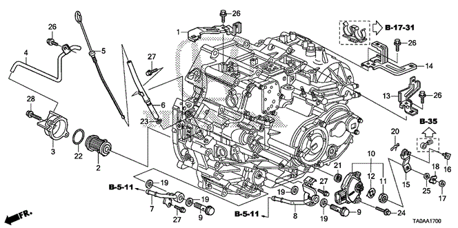

Yes, it does have a filter that is considered "Non serviceable". However, they said the same for the 7th gens and many of us change it all the time. Without looking at an 8th gen trans, it's hard for me to say for sure, but I'm sure someone has attempted this by now. Best thing to do is look at your trans and see if you can find the cap that covers the filter. A quick look over at Majestic Honda shows the filter under "AT Oil Level Gauge - ATF Pipe". It's part number 2. If you can see the cap "number 3" and the hose going to it, you should be able to remove the cap to get to the filter. However, if this is in fact internally then the whole transmission will have to be removed. Hope this helps.

Unfortunately the 8th gen V6 filter is internal. I think the following post shows most clearly that it's internal:
http://www.driveaccord.net/forums/960057-post40.html
If for some reason it really isn't internal, it shouldn't be too hard to find the "cap" (#3 in the Bernardi diagram) sticking out of the transmission.
The only question here is whether this transmission internal filter can be removed without any clearance issues.
Based on the diagram above it looks very easy to remove bolts #28 take out the cap #3 and replace the paper filter #2 but God knows what's next to the filter cap and even if you can reach the said bolts...

The information drozzin kindly provided from the service manual clearly shows the filter is inside of the transmission case. I confirmed the information myself by reviewing the Helms factory service manual.

And the part I looked up on AZ seems to corroborate the diagram. 09 Accord EX 3.5 V6 Trans filter
The service manual information you're showing is for an I4 not a V6. Your AutoZone part search is simply wrong. It's been well established from OEM Honda part sellers already shown above in this thread.
