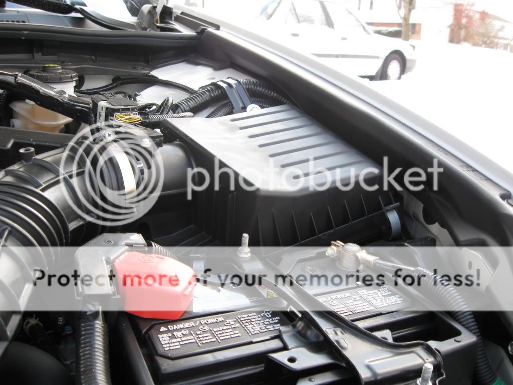

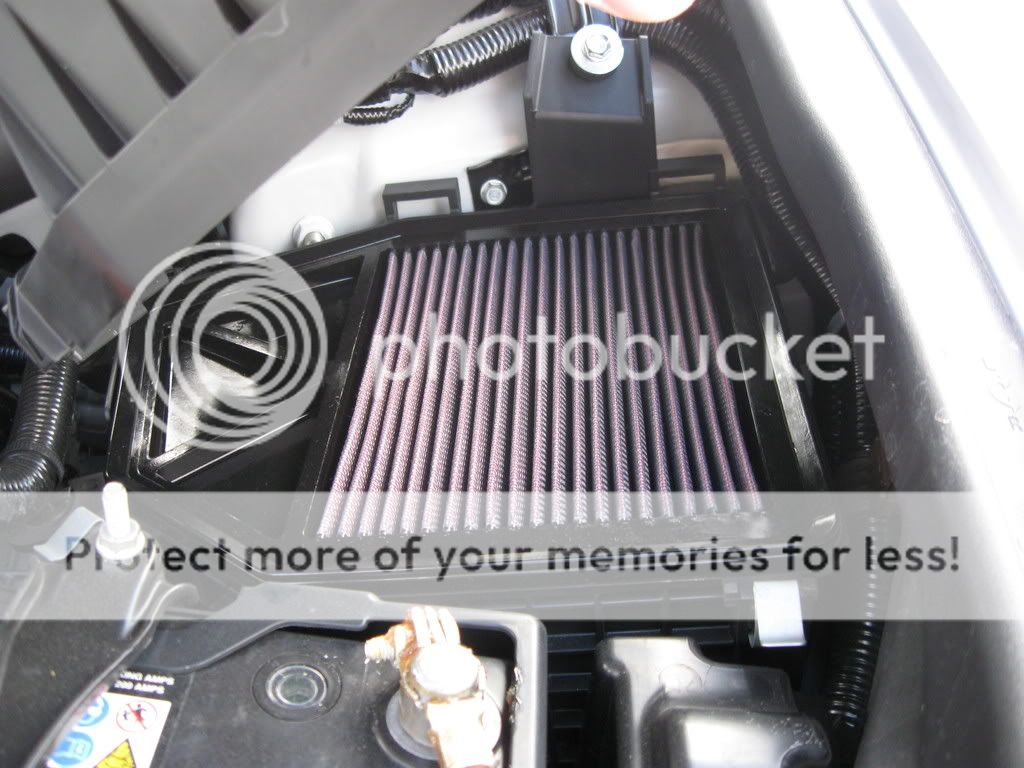

Hey everybody. Went outside and took the 30 seconds or whatnot to install this panel filter. I'm not sure of the difference it's going to make in engine characteristics, but I plan to unleash a small slew of very minor upgrades in the hopes that it'll increase the Accord's fuel economy 1 to 2 MPG. In future threads, I will document my success/failure with synthetic oil, pulse plugs, ground wire kits and a larger battery.
But for now, here's the quick pictoral history of this easy install.
Unclip the 3 tabs that hold down the top of the box to the bottom.

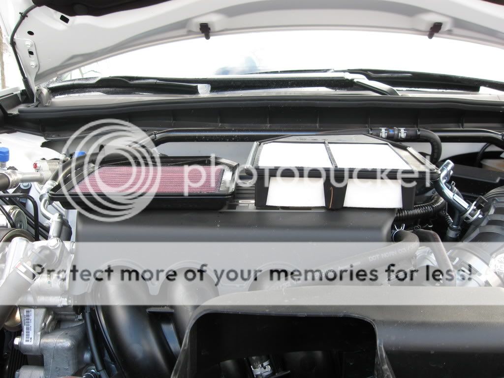

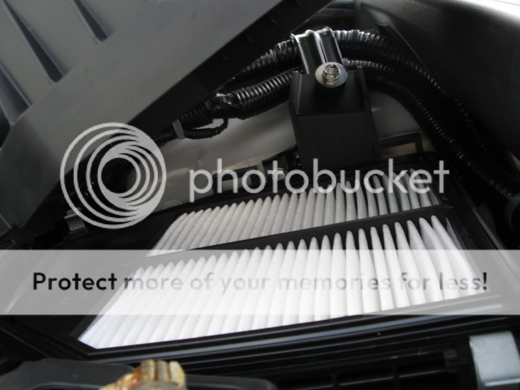

Here is the OEM paper filter

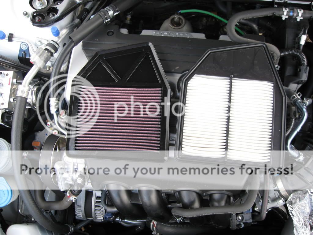

The differences in the K&N and OEM filters are obvious. It is easy to see the K&N is less restrictive being more shallow.

The depth of the filter has nothing to do with air flow restriction. You're argument is invalid. Using your logic the Honda filter is less restrictive because it has (as seen in a later photo) more surface area.
When I was employed in the automotive engineering industry (Jaguar, Ford, BMW) I was privy to test results of air filters of all kinds on air flow meters. Not a single OEM filter was a restriction for the vehicle for which on which it was employed. Using air flow meters, BTW, is a far more accurate way to measure differences in filter restriction than is ANY dyno. Dyno results can be affected by a myriad of factors.
