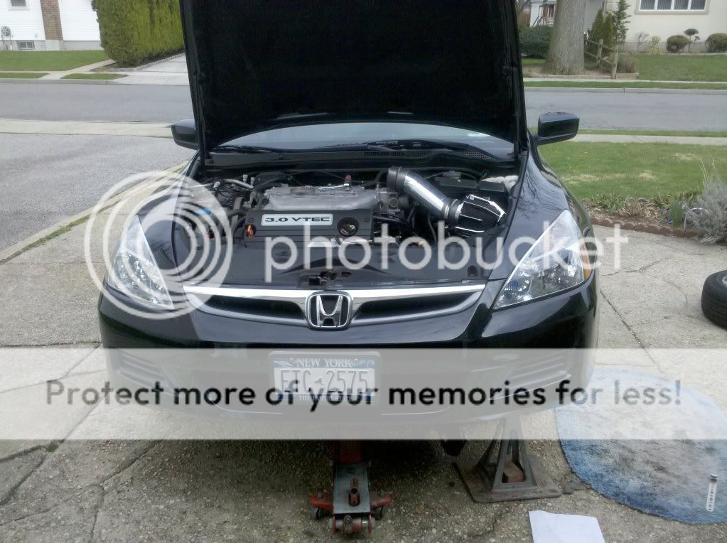

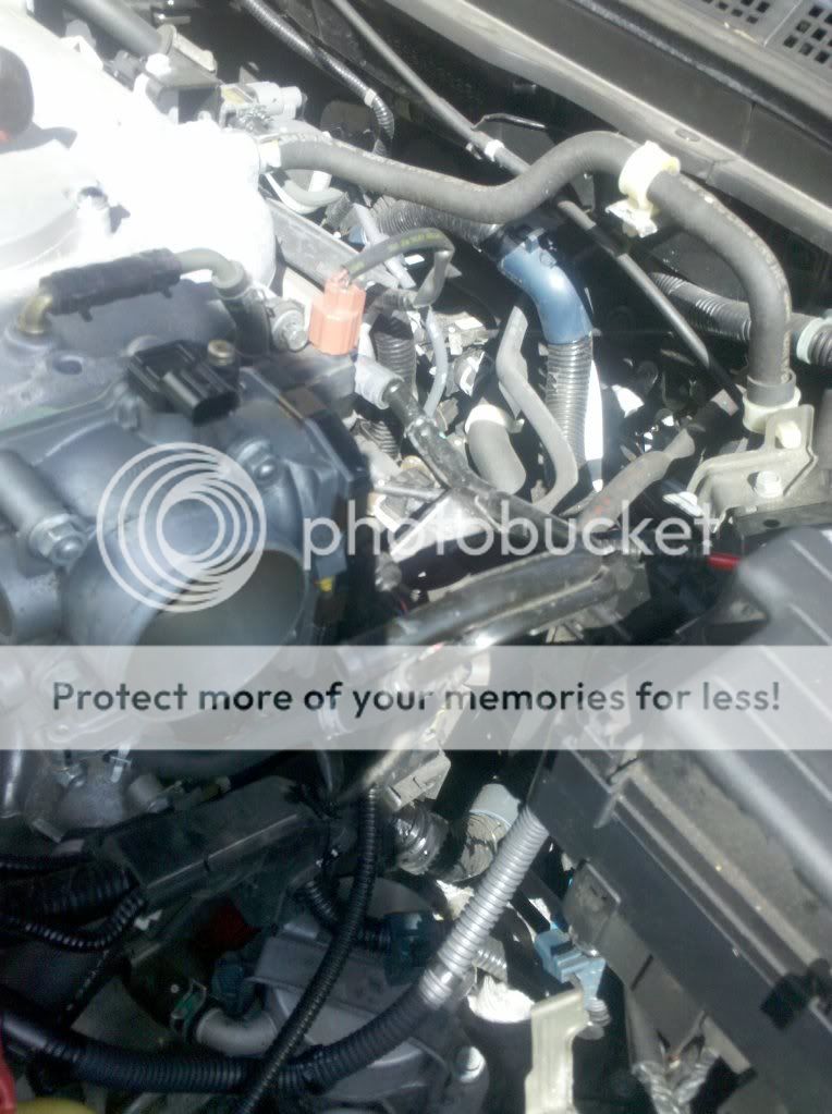

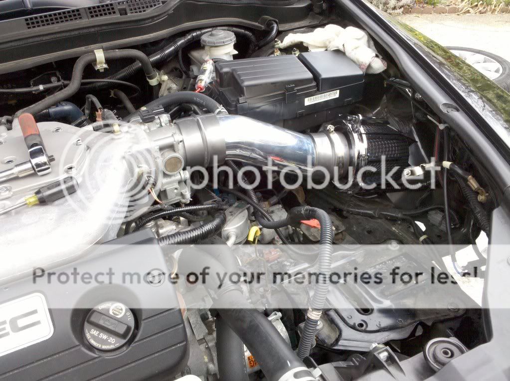

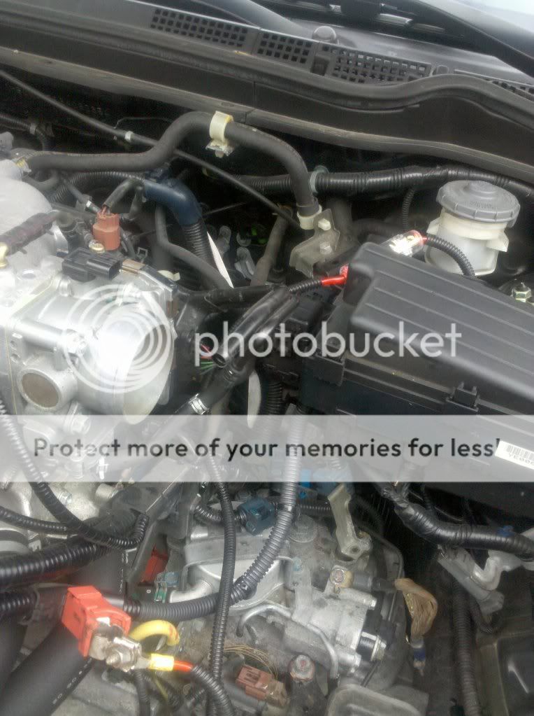

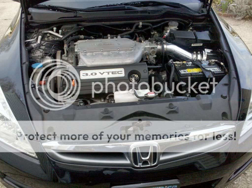

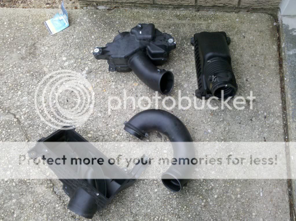

Hey guys, this morning i installed a weapon r intake for my 06 v6 sedan. It took me 8 hours to install it (Im 17 this is my first car cut me some slack). Weapon r instructions are terrible and so it the hose that they want you to use. Also it doesn't fit right when u try to connect the hose from engine to intake. Resonator and original pipes were really hard to take out. It sounds sick though!

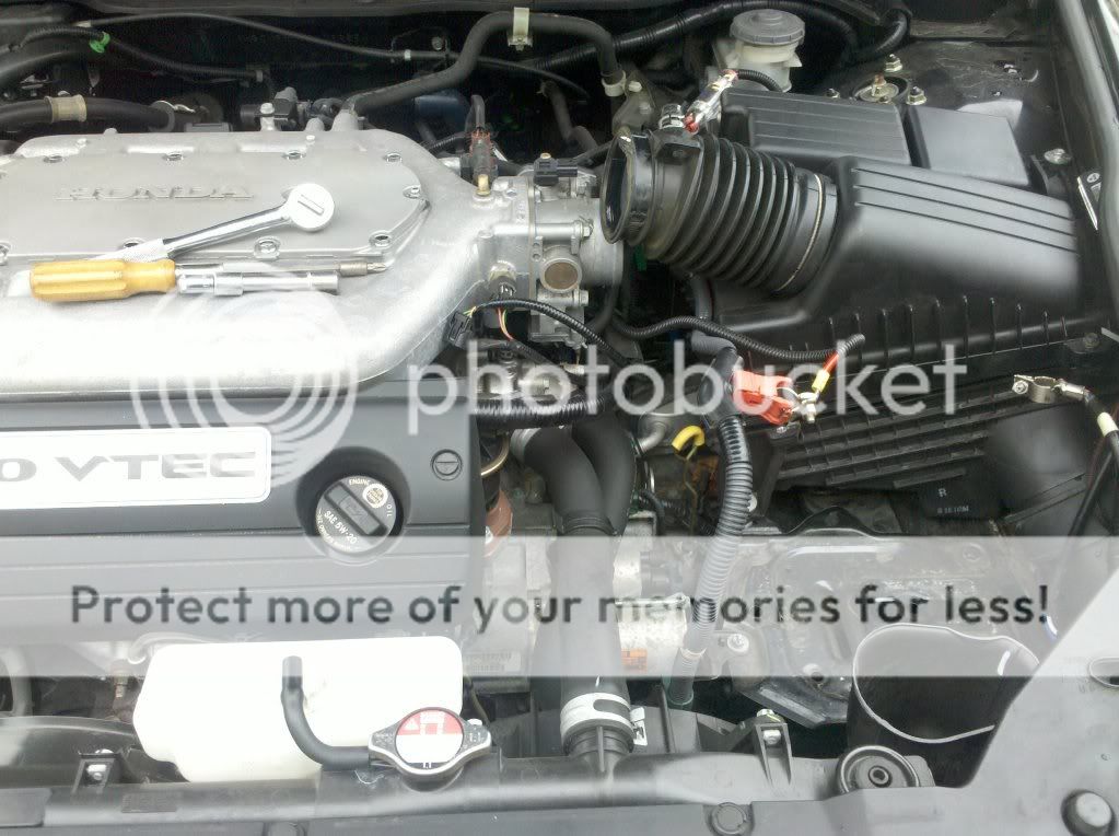

I need help though because the pipe/hose that goes into the intake didn't go back far enough to connect it to new intake. Its a hardline but i took it off and put a regular one piece hose from the engine into intake. Is this ok because the hardline pipe was like welded together with another hard line that antifreeze flows through. Look at 3rd pic u can see what im talking about.
Figured i post some pictures of install
looks and sounds good...i should know, i have the same intake. I painted the pipe black, looks ok, i painted it horribly though. I also installed that lil' filter thingy that came with it.

The tubes and the bracket i actually looked at your post before i did mine to see how u did it. That hose thats on the side i took the hardline completely off and just bought a foot long hose to connect the engine to the intake.

"That hose thats on the side i took the hardline completely off and just bought a foot long hose to connect the engine to the intake.
Reply With Quote"
I dont follow what you mean there.
I just flipped the intake tube so the and ran the hose that came with the intake from the hard part of the tube to the PCV line. Worked great
Did you try a different filter?
i totally took off the hard part of the line and used one piece of hose. It connects from the engine right into the intake pipe. I basically totally went around the hard line.

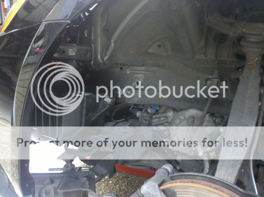

In the second picture of the first post, you can see he's trying to get access to the box that looks like the air filter.
You mean the resonator?
yeah i was trying to get out the resonator. You have to take the wheel well cover off to get access to it. Anyway its easier to work jacked up if your tall cause it doesnt hurt ur back as much
