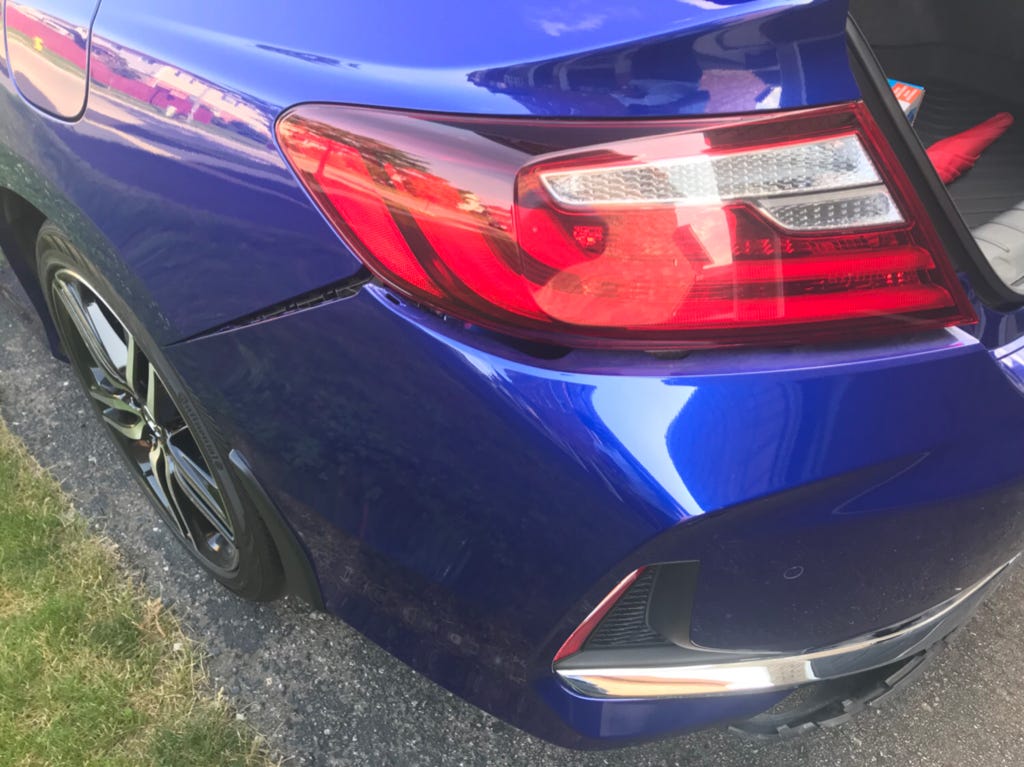

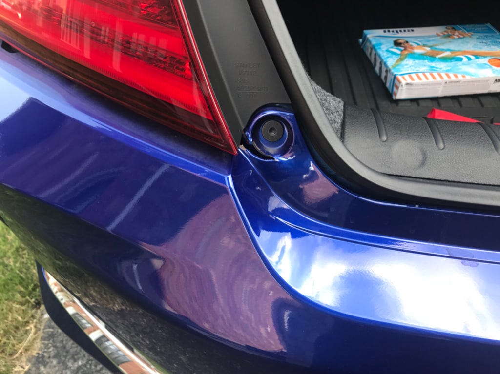

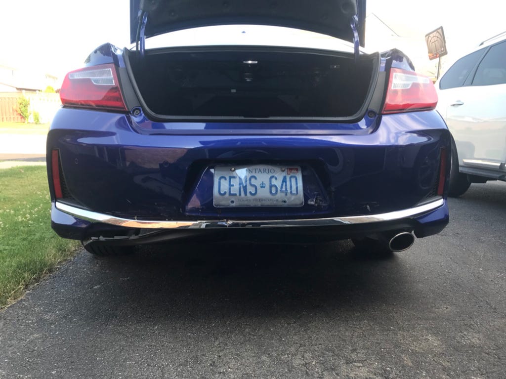

So I just got my new car Saturday morning, and today I get rear ended by a rubbernecking idiot more concerned with looking at an accident than what was in front of him (me!). Stupid idiot.
Not too much damage..... looks like just the bumper, but with the electro doodads in the bumper probably more expensive than I’d think. Oh well, I’m not at fault and insurance will fix it all up, but it’s my new car! Ahhhhh!
Yea that will be a new bumper and paint. They do not come from Honda painted so whatever shop does the work make sure they have a GOOD paint shop. You cant "fix" rubber bumpers.

Stuff happens. You are alive and this will get fixed right. Darn nice color on that Touring.

The good thing is that there appears to be no fender damage, just bumper cover. Since the paint is still "new", the body shop can just get a OE bumper cover and paint it off the car (just like the factory does) and mount it up. You wont have to worry about them having to respray the actual car. Granted the bits under the cover will need to be replaced, energy impact beam, clips, etc. Looks like the reverse sensors are fine.
