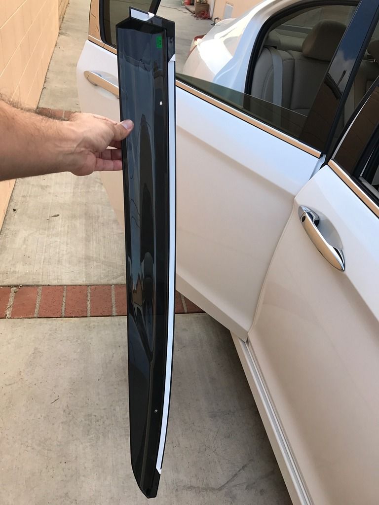

ordered them from college hills for free shipping on black friday special. very easy to install. took pics on the install on the last rear left since it was the last one i did.

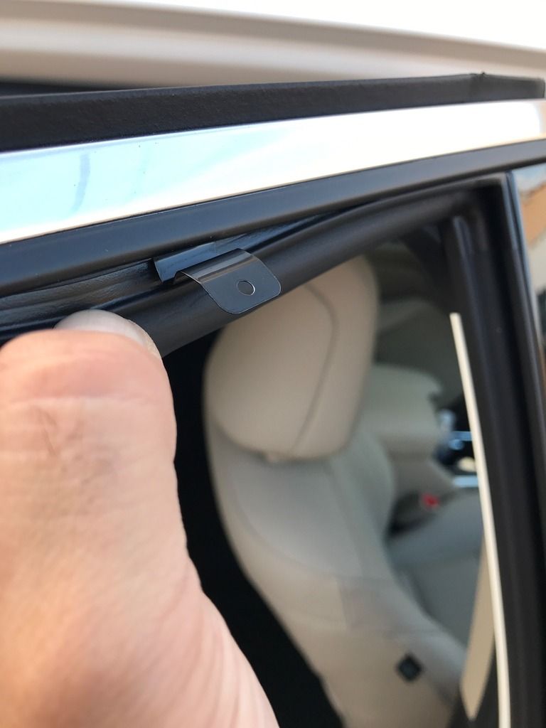

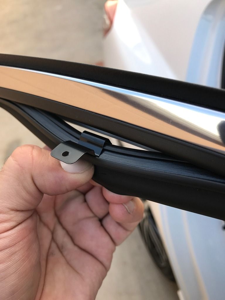

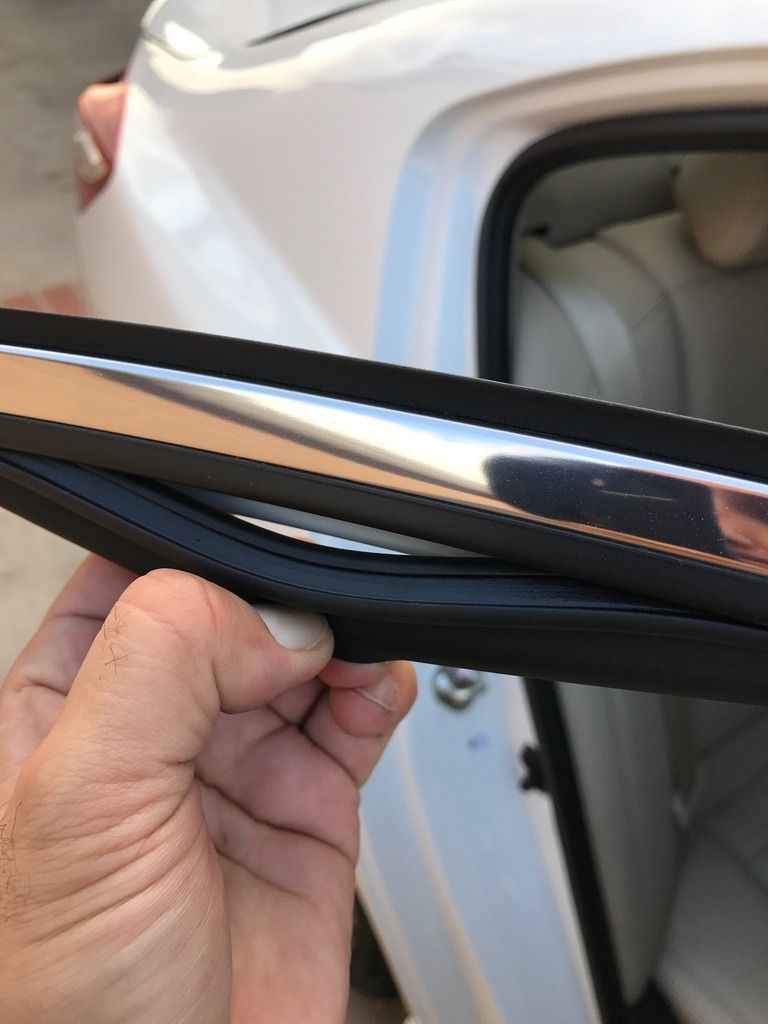

Pull down the rubber window trim on 2 sides of door
install two of these brackets into the 2 sectios you pulled down.(dont worry how far apart since you can move them later to align the holes.
This is how they should look after

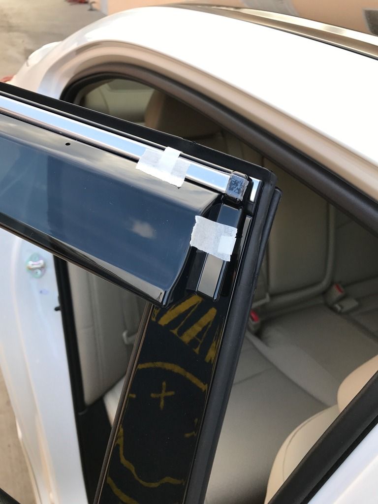

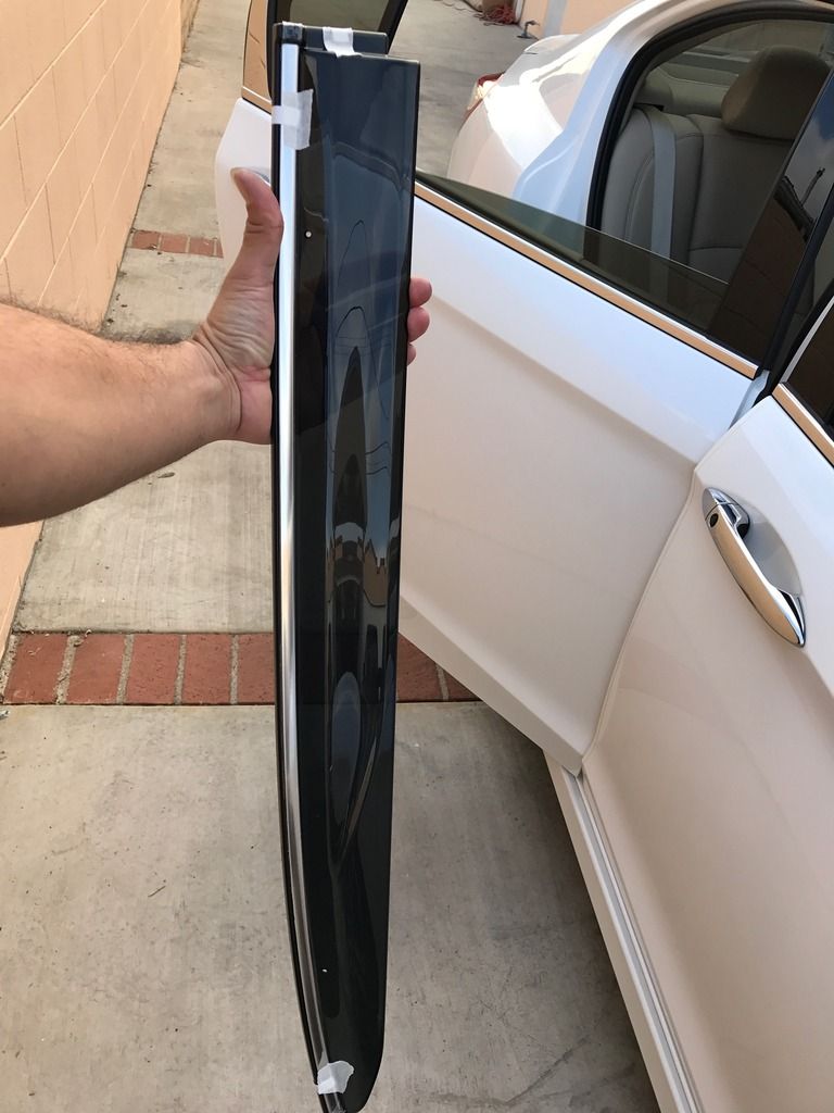

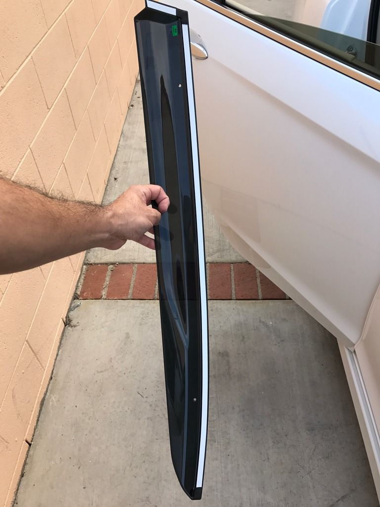

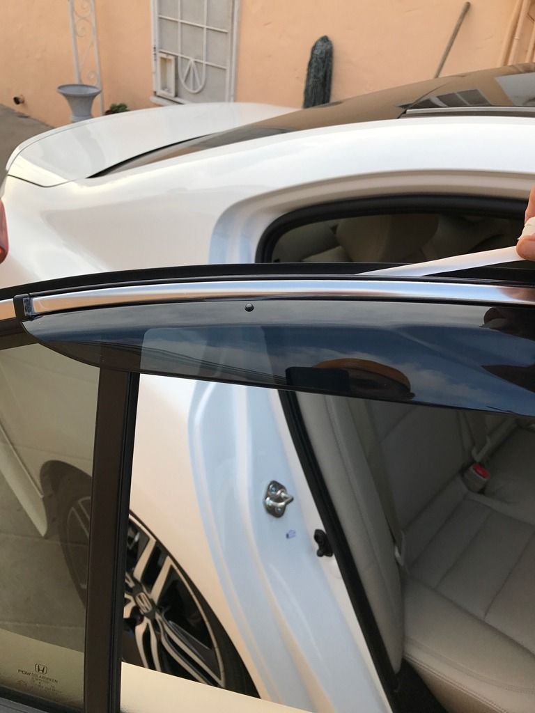

grab the visor and peel the edges off and stick it around the other side with masking tape
align it to the edge and press lightly to hold it with the small amount of 3M exposed on both side

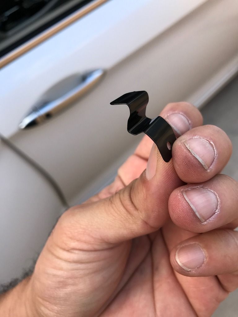

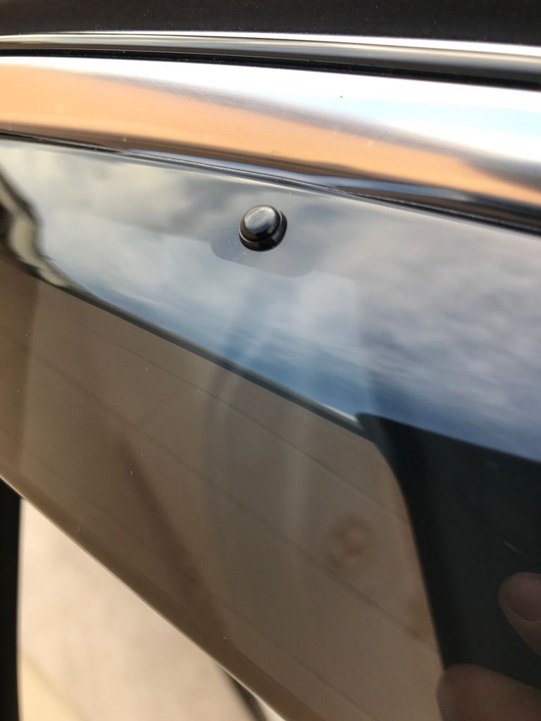

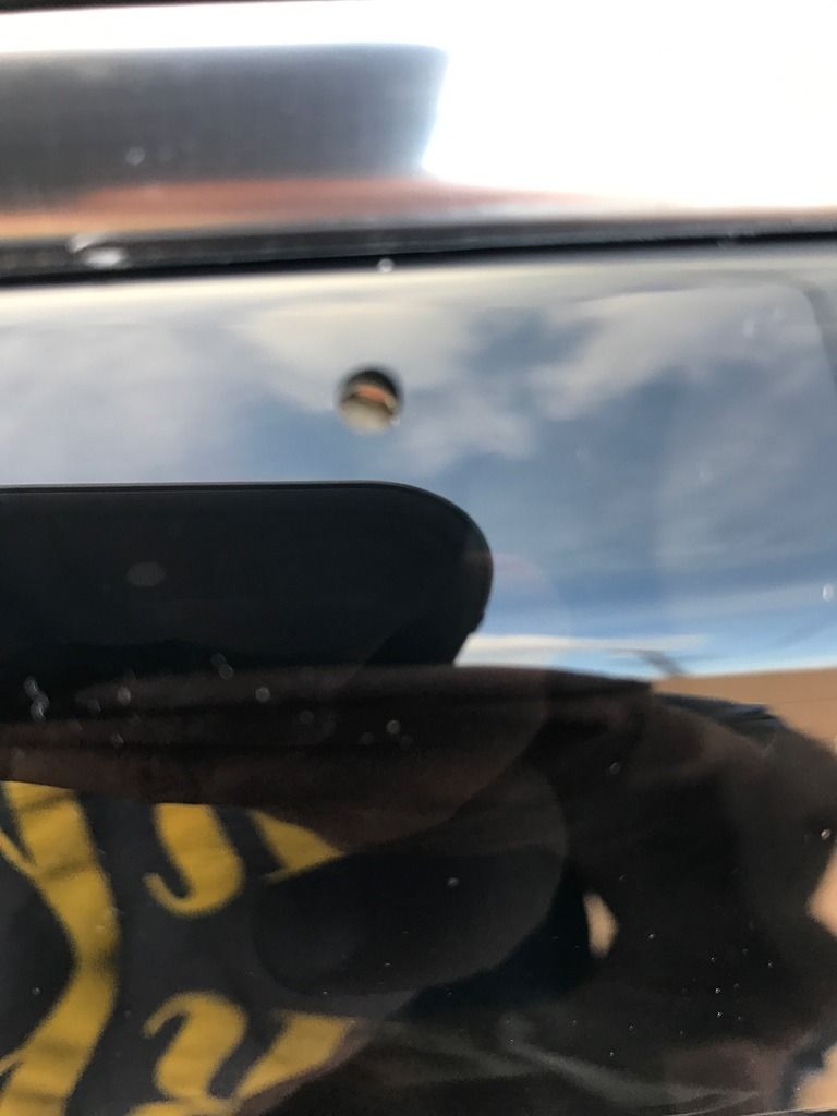

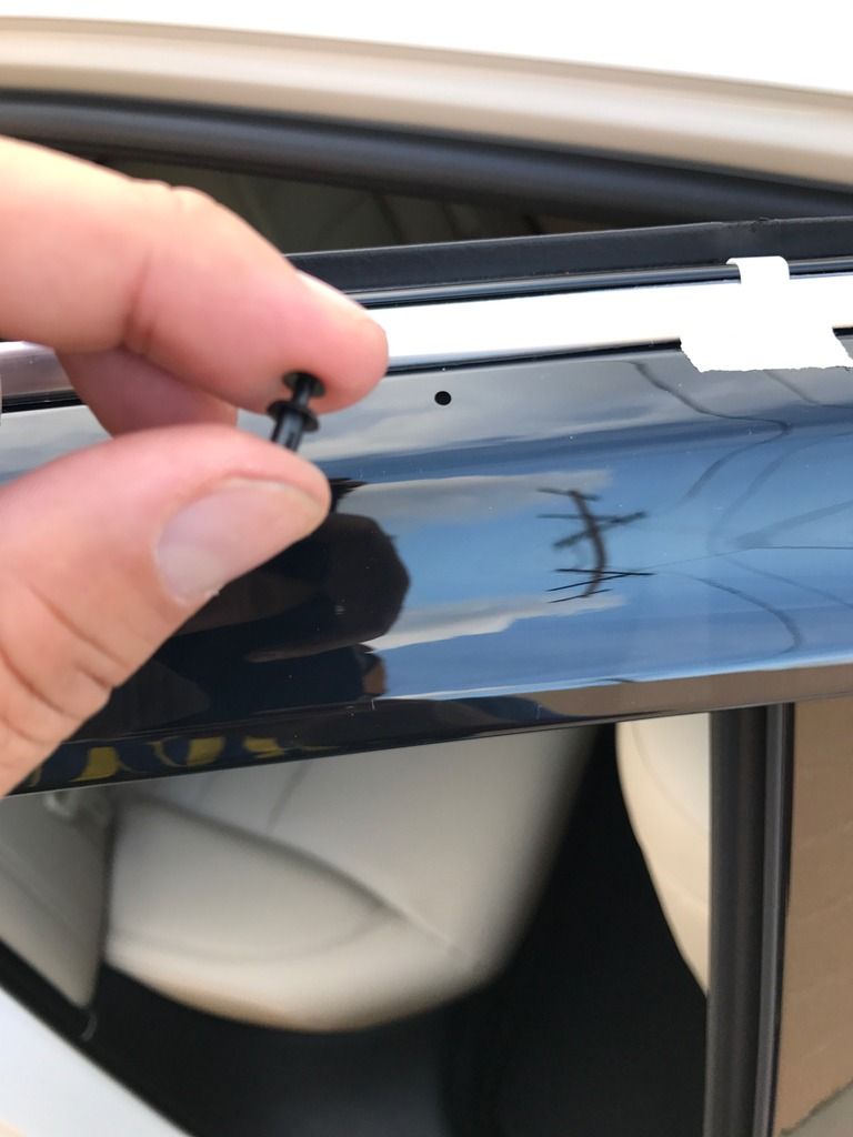

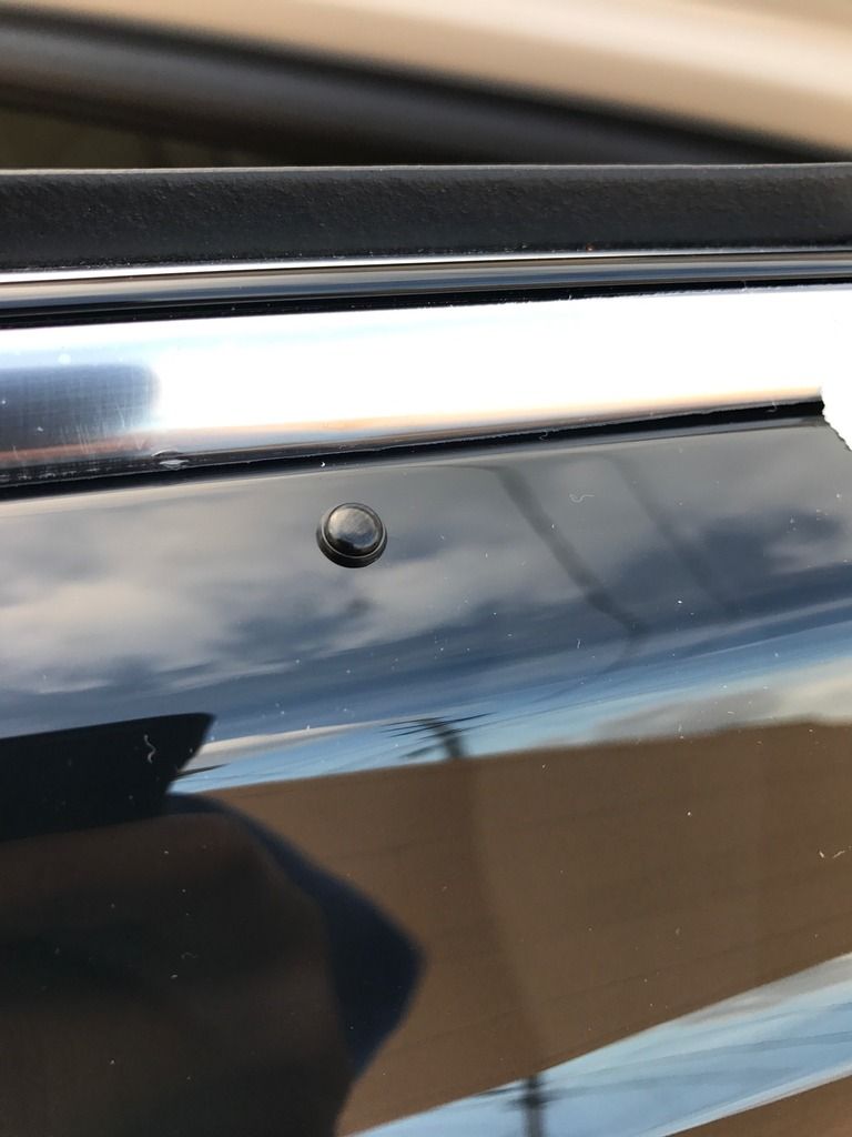

now grab your 2 clips

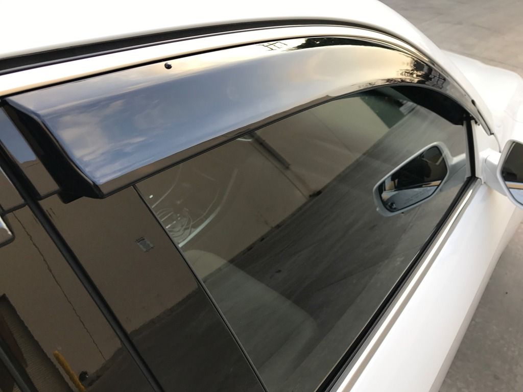

move the brackets in the bottom to align with the holes in the visor and put it in and push to lock

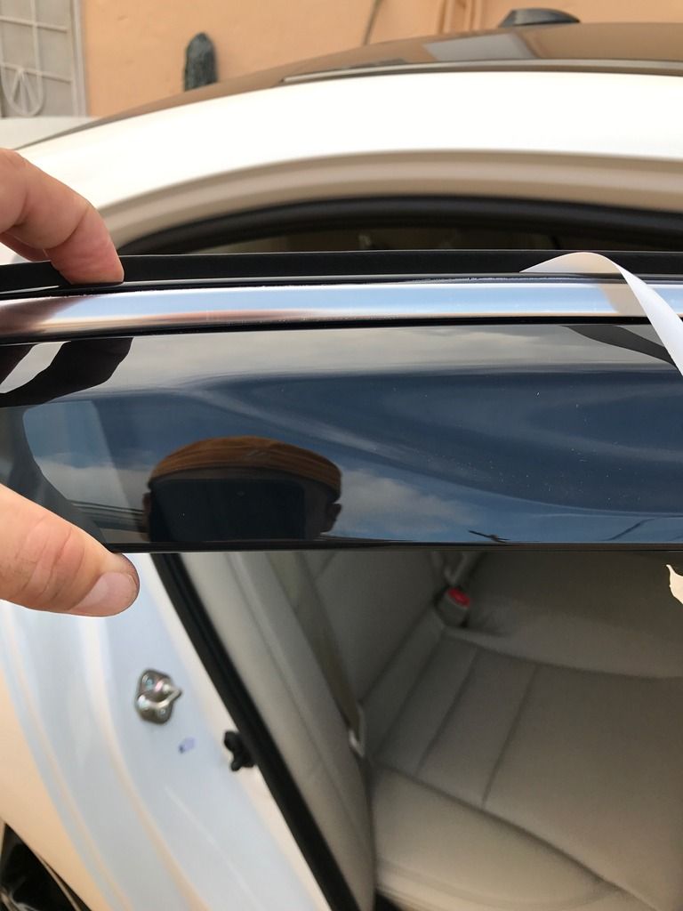

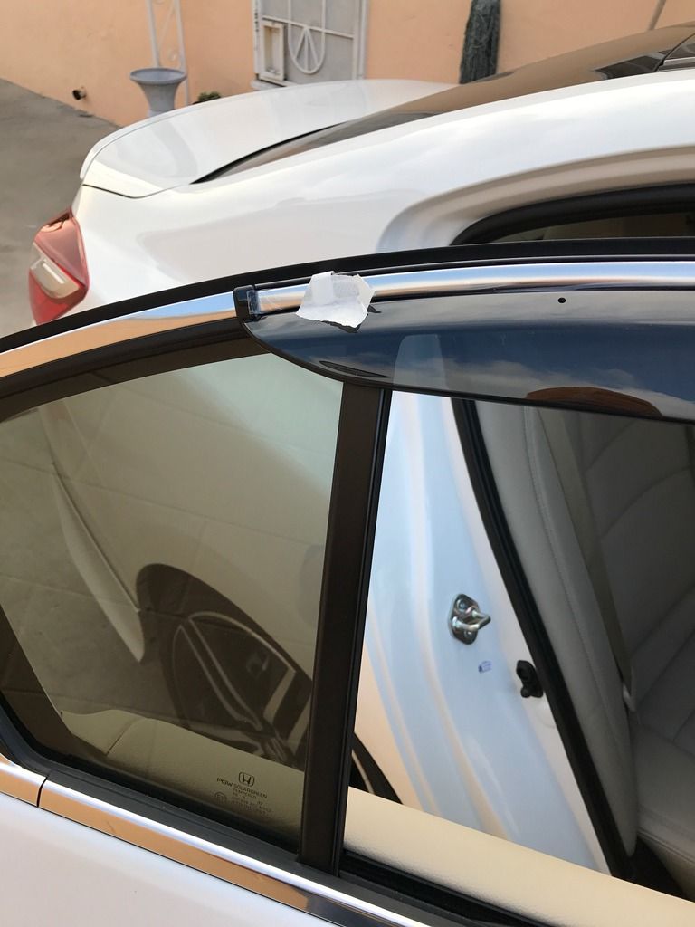

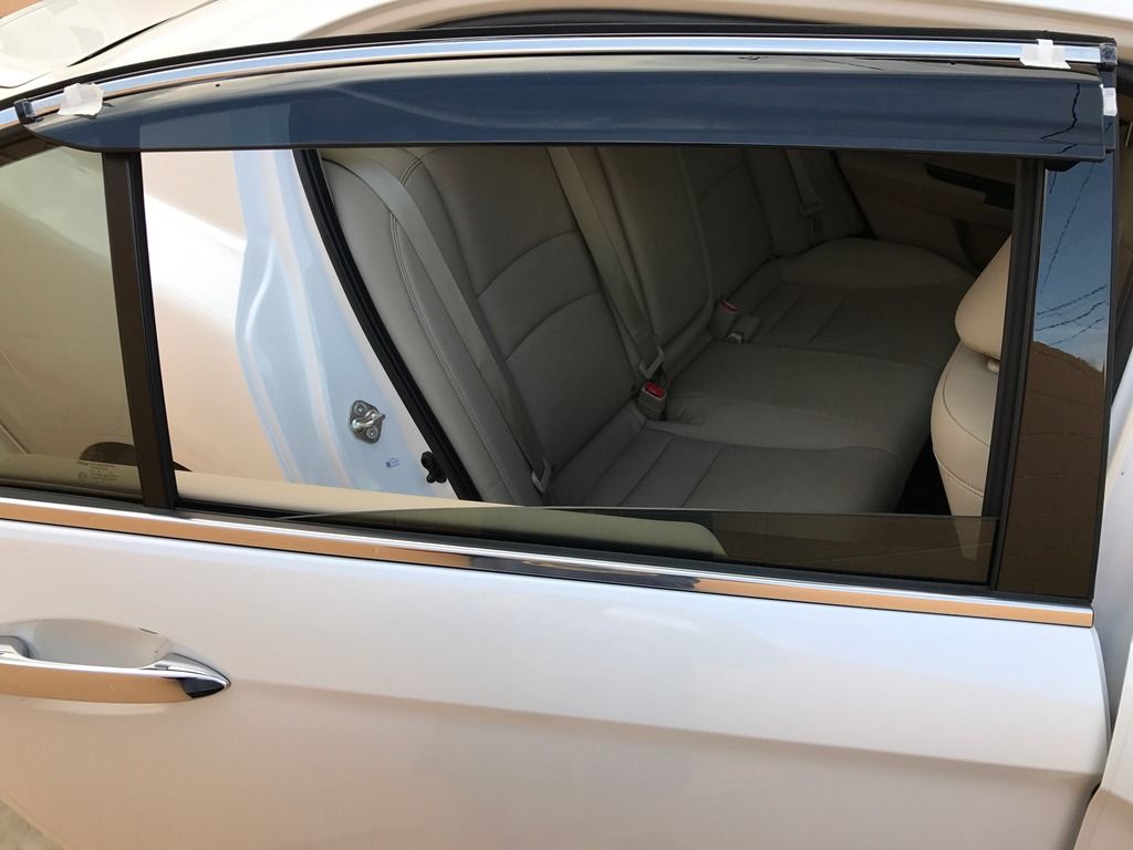

Now as you are adjusting the visor to fit just right, remove the tape u had taped slowlywhile adjusting and pressing with the other hand.
When all the tape is removed press hard on all the visor to make sure it stick firm with your palm or another towel.

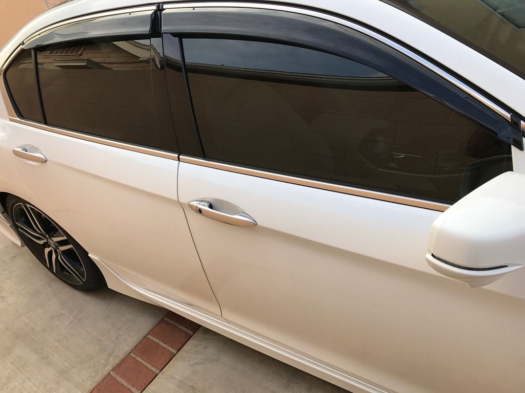

Finally remove the chrome protector an you are done! Repeat for all 4 sides.
***Note:The front visors havean extra bracket very easy to install and needs another clip to hold on a 3rd hole you cant miss. That is the only difference from the front and rear.

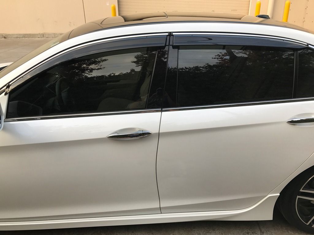

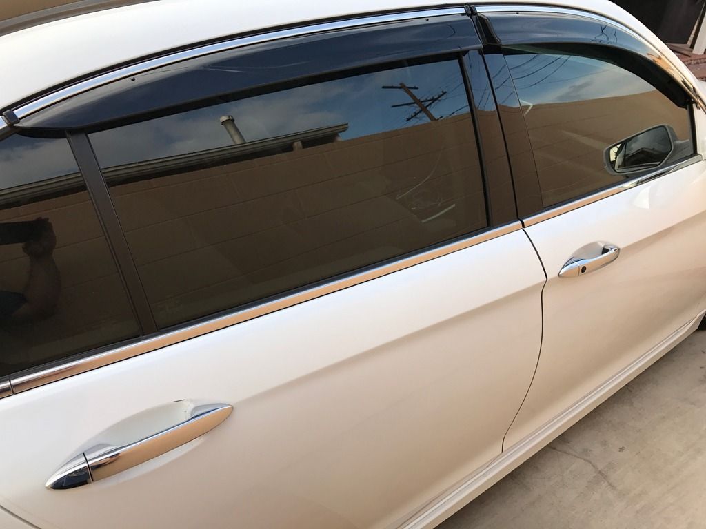

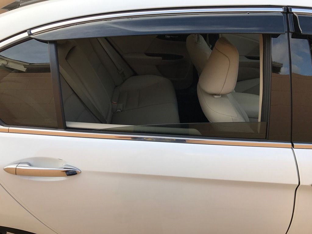

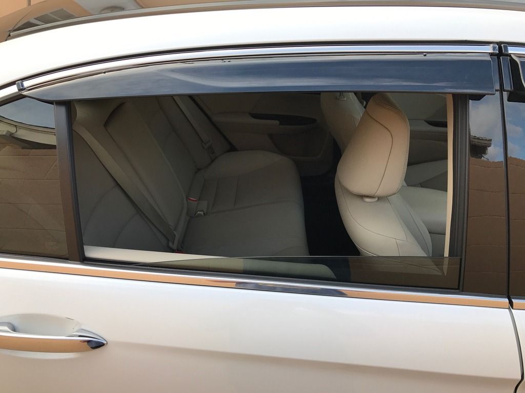

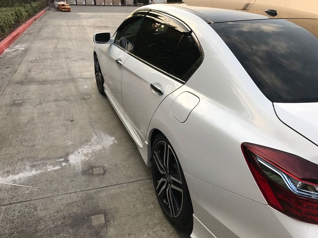

Here is the final product. Any questions, post here or send me a PM!
