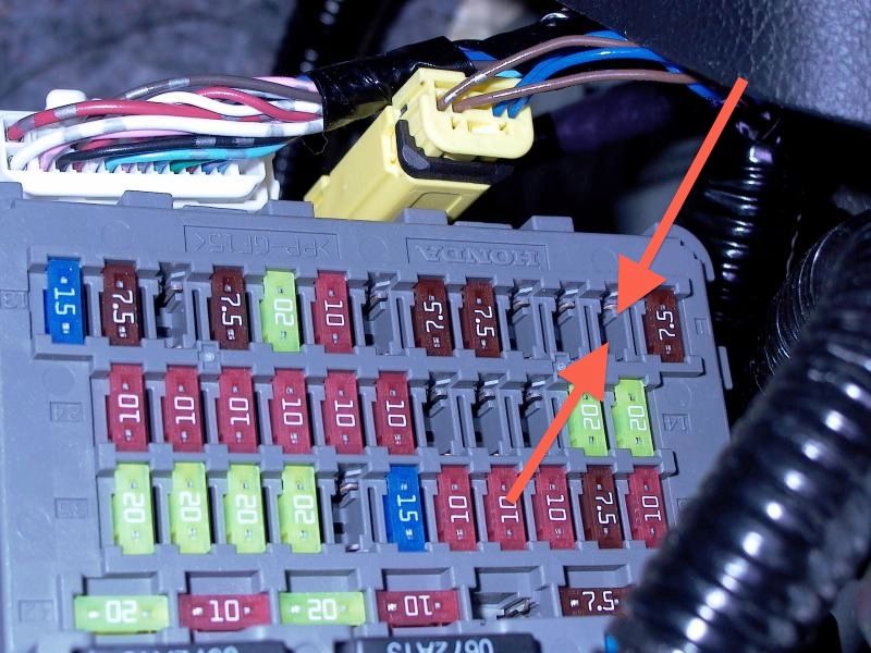

The fuse diagram sometimes can be confusing. You may have taken the wrong one out. On my LX, it is fuse #2, just below the AC 7.5A fuse. There are more than two 7.5A fuses. The fuse #1 is for AC and you see #2 being missing, which I took off.
I took the fuse #2 out which is for DRL and now it is successfully OFF.
I did not know how to add the arrows so thank you for adding them. The diagram can be a little tricky to read.
not sure, but is the pic of the box upside down? - Important you see the #1 and #13 on the plastic at beginning ant end of that row, that tells you where #2 is...

Thanks guys! I put back the fuse I pulled in the engine bay and took out the fuse in the interior fuse box as stated... no more DRL! :banana::thmsup:
I flipped fuse diagram to match the fuse box picture
I flipped the fuse diagram on purpose to match the fuse box photo. Looks like the OP figured it out.
