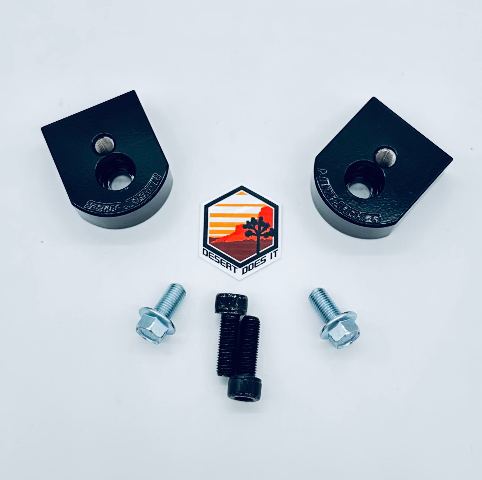

Looking at how the Accord's seat is bolted to the floor, the rear bolts are vertical, but the front bolts are at an angle, maybe 30° off vertical.
So, it would be easy to install spacers and longer bolts the rear and bring the rear of the seat up, but it's almost impossible (for me, at least) to raise the front of the seat.
Except... Here's a custom kit that does it:
Great find! Good to know the rear is bolted. I hadn't looked into this yet since I rarely have passengers.
I'll probably just make my own blocks since I already have some aluminum bar stock and taps in common seat bolt sizes. That design shows that even a 3/4" block will offset the holes enough to avoid overlap at the angle of the bolts. I'll probably go 1.5" in front and 1" in back. My people are not tall.
How 'bout making a batch, and selling them via this forum? I'd happily pay up front for a set, especially the fronts.
(The rear spacers are just straight-through stupid-simple blocks, and longer bolts, and even I can figure that out... I might even just make them out of blocks of maple.)

Thanks a lot for sharing this. I think I will order them for my driver seat. I see it can work for both driver and passenger seats. I know the passenger seat will benefit from it too for sure. I will have to order for both seats then. Let me look more into this.
Does anybody know if there is one for the rear? These are only for the front of the seats. Any links for one for the rears?
All you need is a metal spacer with sufficient surface area and a hole in the middle. A heavy square nut with threads bigger than the seat bolt's could work.
I always keep strut channel washers on hand for projects. They are about 1/4 thick. Easier to stack than regular washers and most definitely strong enough for any purpose.
Strut Channel Washers
You'll probably need longer bolts too. I recommend grade 8, flange head bolts for best safety factor when clamping down stamped sheet steel like seat tracks. If the manufacturer used a flange head bold then I'm going to replace it with one. Cap head screws are not a good choice unless you have thick washers with a precisely sized hole to prevent tear-out in a crash. I always approach modifications like these with caution. You don't want to risk adding a weaker element.

Like 2Many said, the rears are a simple DIY block or stack of washers, with a new longer bolt.
And like he said, don't scrimp on the bolt...

I basically just called that company above and they said they are sure the rear they sell for a Tacoman or Tundra would work for the Honda. They asked me to please send them some good pictures of the rear so they can let me know if it will work for sure. And if I buy it and it does not work, I can send it back to them.

OK, so I actually took a look at the seat bolts and they've used a seat-belt style with a torx plus head, probably a TP47. I don't have TP47 at the moment so I can't pull one out to verify length, thread size and pitch. It's a very low profile head, presumably so the upper track can slide over it. There's enough width for a flange head but I'd certainly try replacing one first to see if there is enough height clearance. In might need to be ground down, possibly too much to leave enough hex to grip. Perhaps the proper bolt could be sourced once all the details are determined. The size of the hole in the track is important are many multiple configurations of shoulder lengths and diameters. I usually keep seat belt bolts when I scrap something because you never know what you might need. You won't find this stuff at the hardware or auto parts store.

Really, it's an easy DIY job with scrap that you probably have lying around. You could buy somebody's "kit," but it'll be <$10 of hardware (retail, <$5 wholesale) and cost $50 or $75.

Correction, the seat bolts are TP50. I was able to find mine so I'll be pulling a bolt out soon to investigate. I don't recommend trying to remove torx plus with a regular torx bits.
I'm also thinking the best way to do this is to use a simple spacer in the front which will move the seat forward due to the angle at the front of the track. Then the rear spacer block could handle the resulting offset. The original seat bolt could then be used at the rear eliminating concerns about sliding track clearance, and a commonly available flange head bolt could be used from the bock into the body. Same at the front. This is basically the reverse of the SeatJackers kit.
