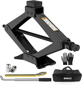

Buy a much better jack on Amazon instead of the flimsy ones included in a "kit"
Scissor Jack for Car, 3 Ton with Spare Tire Changing Kit, Portable Tire Jack Repair Kit with Lug Wrench $56.99
I added better tools than the kit had, an 18 - 24" 1/2"Drive Extendable Ratchet, LED Road Flares Safety Flashing Warning Lights Kit (and a pack of AAA lithium 20 year batteries).

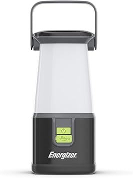

Don't want the Styrofoam Tool kit in my spare tire, I want to place the tools that I want into the center of the tire along with an LED Camping Lantern to light up not just the tire but also me and knee guards to protect them while I'm kneeling on an asphalt roadway.
