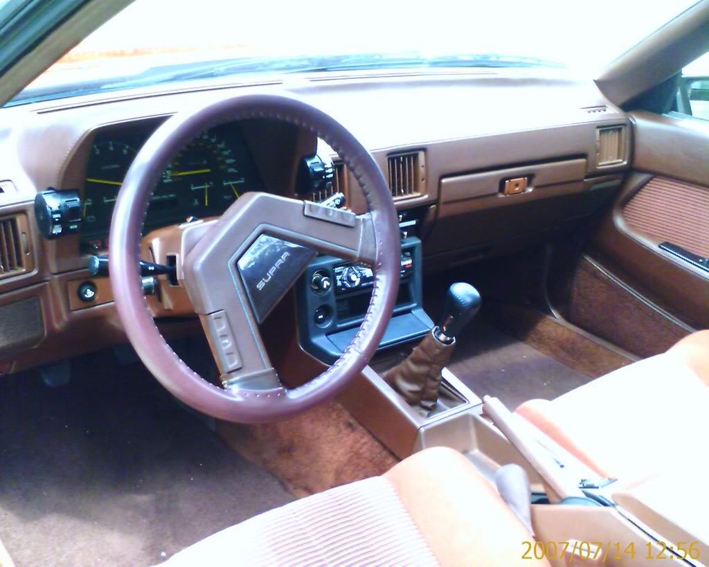

I've had good luck with these aftermarket wheel covers on my old Supra: https://wheelskins.com/original
here's the one I had:
