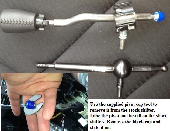

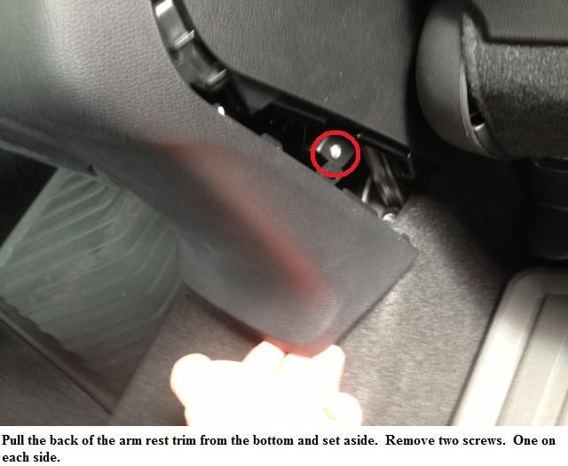

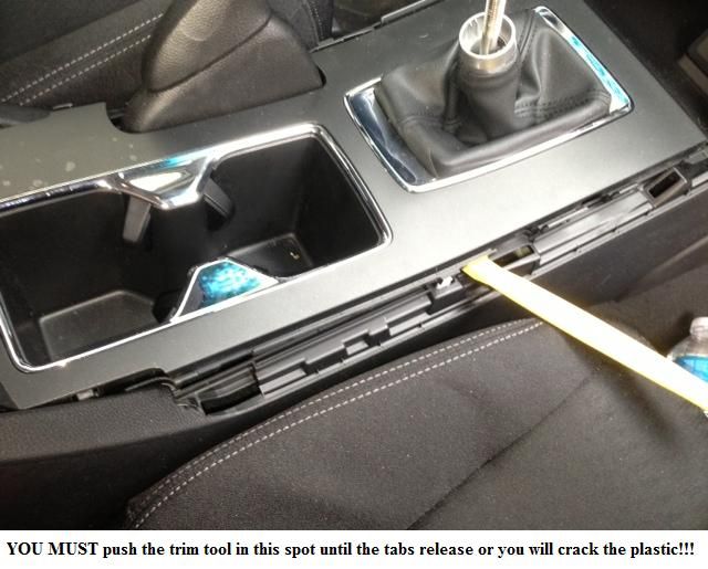

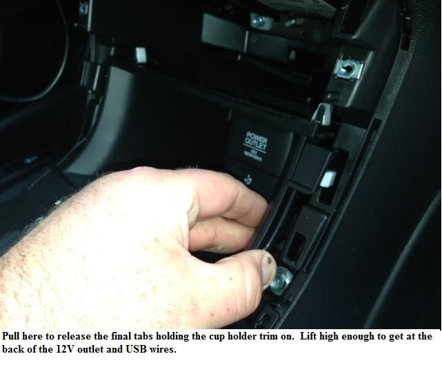

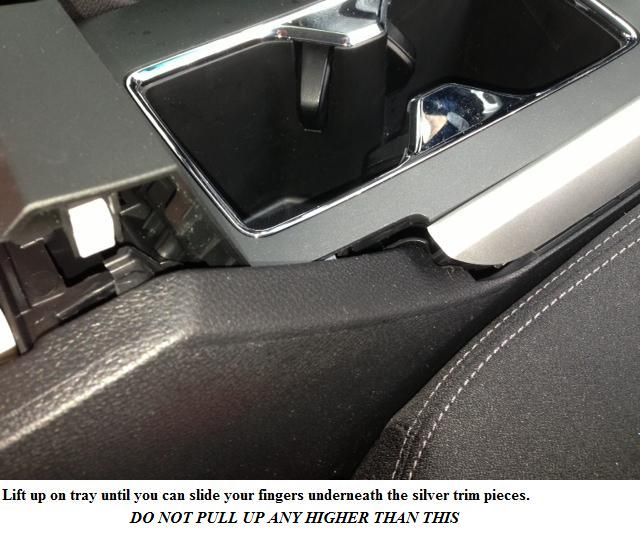

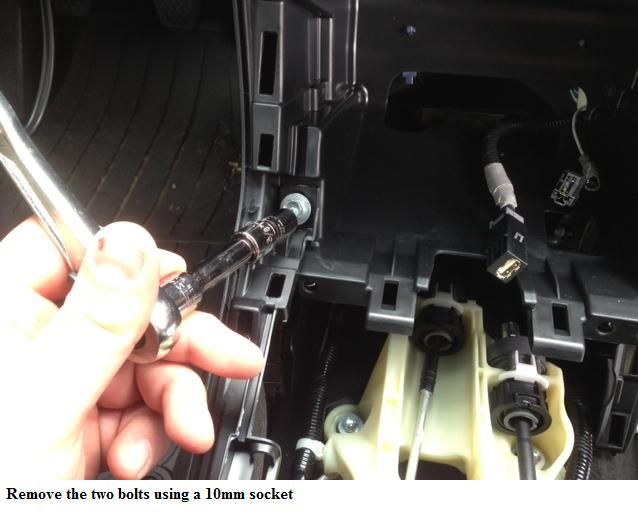

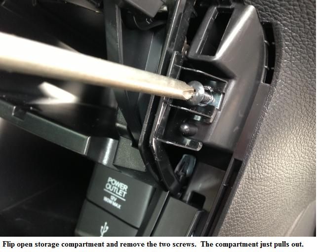

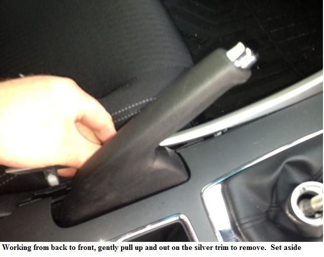

Hello everyone! I was talking with TWM Performance about a STS for the 9th gen Accords. They seemed to think that their shifter for the 08+ Accord would work. And it did!
As you can see the stock shifter is WAAAAAY out to the right. The TWM STS is angled slightly more towards the driver. Taller people, like myself, won't have to reach so far for 1st, 3rd, and 5th. It is so much more comfortable.
You will need:
Phillips and Flathead screwdriver (and or small prybar)
Trim removal tool
Mechanics pick or very small flathead screwdriver
10mm socket

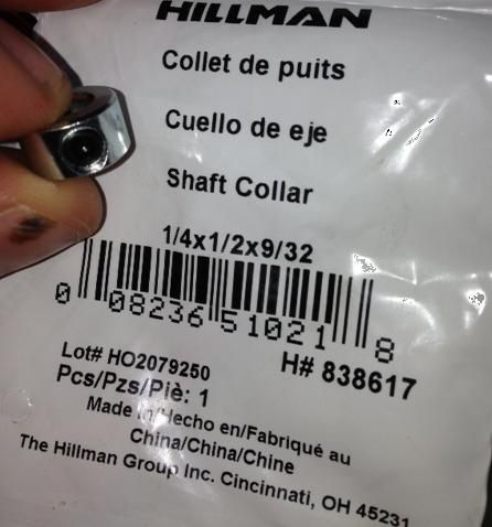

Maybe a 1/4" Shaft collar.
Ok here we go.
Sorry for the crappy MS Paint pics. Feel free to ask any questions!
how much did it cost? does it feel shorter/better or do you like it because it's closer to you?
The throws are ALOT shorter. The height of the shifter is lower too. I love that its angled a little closer to the driver. i wouldnt mind if it was even closer still. I know i could have gotten the CT engineering adapter, but then the shifter would still have that STUPID bend in it. The shifter and a weighted knob will fit the 2013 models. I don't know about the compatibility of the cable or base bushings. I have the first 9th gen Accord with this mod.

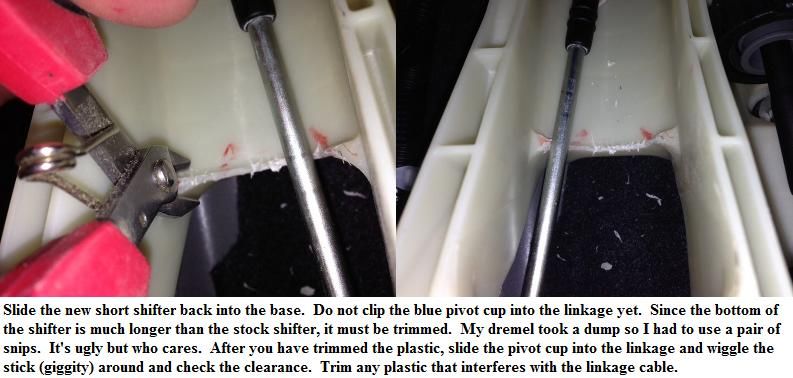

200 for this straight shaft, am i reading that right? I already have my old neuspeed ssk adapter from my previous 7th gen that i tried to use but couldnt because the shift housing needed trimmed and i didnt want to do that yet. if its necessary to trim the housing for the straight rod, i can just use my adapter and deal with the bend until im ready to upgrade the rod.
as far as trimming the housing, did you have to trim down into the "meat" of the plastic to allow clearance? or was just trimming the lip enough to allow the linkage to move freely?
Great post btw! this is very helpful with all the pics.
I just had to trim the lip to allow free movement of the cable. I wanted to get the adapter and use a torch and vise to bend the stock shifter. But my wife yelled at me :(

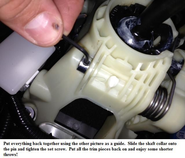

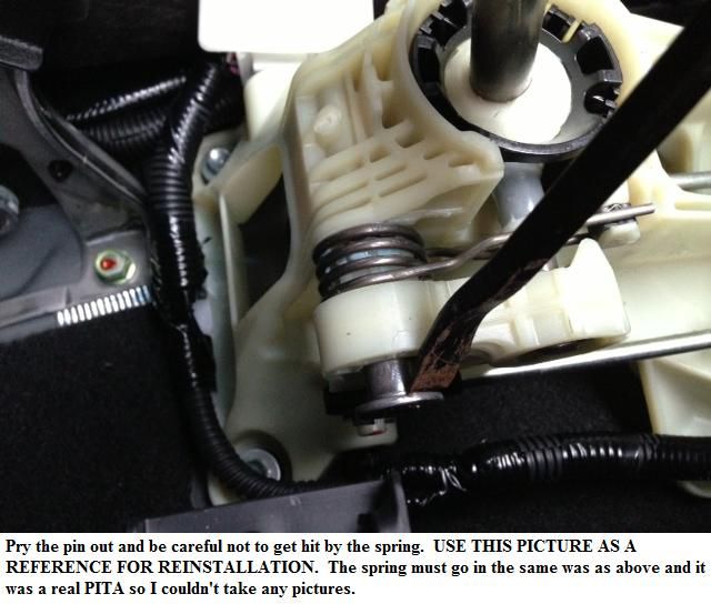

8th gens did use a bolt. But the 9th gens use a pin of varying thickness. Is 1/4" by the washer but 1/2" by the side arm. Look at the next picture and you'll see what I mean. Also the pin is not threaded.
"They ""seemed"" to think that their shifter for the 08+ Accord would work" .....no thanks. but a great detailed write up none the less
Ah ha, thanks for the clarification. Assumptions can only go so far.
The shaft collar is a great idea though. I'm sure a lot of the 9th Gen M/T Guys will want to take this project on.

This is what i plan on using since i had it from my 7th gen. i tried it when i first got the car and found that material from the shifter housing needed to be cut down to allow the linkage to drop, like shown in pics here, and didnt feel like going that route yet. since its necessary for the straight rod too, ill just use the adapter until i can get the rod.

Thanks Johnny for being the first to do this mod and take the chance on trying different parts. without this, i probably never would have tried installing my ssk adapter again. i just installed my neuspeed short shift adapter on the stock rod and wow just that alone makes a huge difference. i had to cut the lip off the shifter housing but even on the coupe it didnt take much. i just used my oscillating saw and ran it back and forth until it was basically flush with the rest of the housing. and had just enough clearance to pop the rod on the ball.

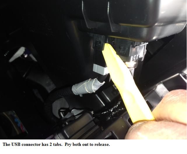

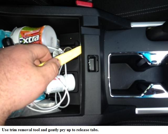

Do you need more pictures? I'm going to edit one of the steps. I found it easier to lift the shifter out and then disconnect the shifter from the cable cup. I may just rewrite the whole thing, actually. It's not necessary to remove the side and back console trim panels.
