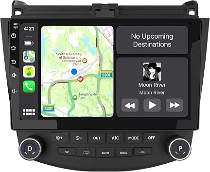

I recieved and installed an android head unit for Christmas (I'll link it at the bottom of the post). The head unit is good and I had to not use the green adapter since I have dual zone controls. But I've noticed 2 things
1. At lower fan speeds I can hear a clicking type noise (I thought it might be the damper flipping back and forth) I know it's not the fan since the tempo doesn't change in correspondence with fan speed
2. It will blow on the winshield directly, or winshield and feet, but it doesn't seem to blow only on feet or only on face...
Any ideas?

Update: the clicking noise (which sounds kind of like a clock at about 400BPM) only happens when the unit is trying to command some air to the face pointing vents

Sounds like the mode motor or the blend motors are failing. They make a rattling noise when the car is on.

i reinstalled the original head unit and the mode motor did switch modes. just not with the aftermarket radio. Im working with customer service and they sent me a new dash kit which did not help...

  • I installed an AWESAFE Android Radio (With Climate Controlls) from amazon in my 06 Accord (With dual Climate)
  • I am not using the "Y" cable since it is dual climate
- All radio/screen functions work correctly
  • A/C Works
  • Dual Temp Works
  • Fan Speed Works
  • Rear Defrost Works
  • Auto seems to work...
- Vent Mode is stuck on Windshield and feet.
- With Original Radio, problem does not exist.
- Screen shows a change in vent mode but the mode doesnt actually change.
I do not believe that the "CAN BUS SETTINGS" has anything to do with this.
My thought was that maybe the Controller on the aftermarket radio was not strong enough to drive the motor but i unplugged the harness and measured voltages and compared them with the stock radio and they look the same. This wouldnt address my concern on power output but i got 5V on pins 2,3,4,5. 0V on 9. 12V on 10. This is using 1 as GND Reference.

Had this same exact issue, just made an account let people know I figured it out. Basically the issue is the potentiometers inside the actuators. There's little pins inside and over time these start to make worse contact with the pads resulting in a worse signal. The stock head unit is able to parse this signal but the aftermarket ones can't. Though once the signal gets bad enough the stock head will also start to do this. There's two ways to fix this. For the drivers side blend motor, mode select motor, and re-circulation motor, you can open them up and clean off the pads, bend the pins back up slightly, re-grease with some dielectric then put them back together. These should then work good as new. For the passenger side blender motor the main gear doesn't detach as it does with the other actuators. As such you can try to clean it and it might work better, but since you can't bend the pins up it seems to not be very reliable. However, you can also just buy a replacement on amazon for 20 bucks. In fact you could replace all of them if you'd like. But I opted to save the money and fix all.
