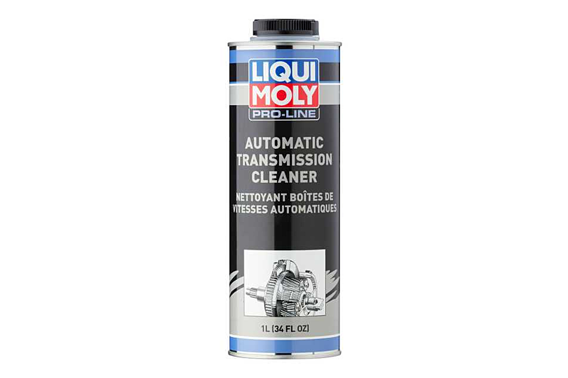

Wolfshead full synthetic had good results but I have a 2002 Honda Accord with a notorious bad transmission. I went back to Honda dw1 which you can get online for 12$ a quart. Tomorrow I'm adding Lucas additive to see if the shifting and torque shudder softens. This is my last option before a transmission replacement because I've repaired everything else and have 173k on engine.
@Petey j
Try this.... I've used it...
