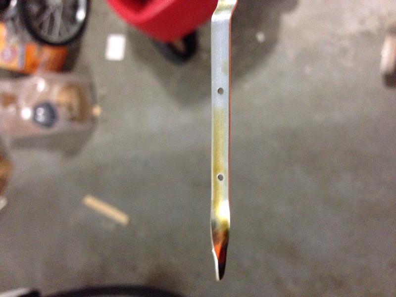

I'm sure that I've asked this before but I don't remember and can't find info on it. Engine stone cold is showing one notch and maybe almost a half and warm it just hits the top hole of the two.. It's a dark blob at the bottom and has some amber looking oil streaked.. My MM says oil life 30% (about to go to 20) around 2000 miles since last oil change lol.. I'm far off from the sticker that they put on my car.. But anyways should I buy more oil or get a change early or are my levels good?

If it's between the top and bottom hole, you're fine. Engine should be cold.
If it's only been 2,000 miles since last oil change and oil life was reset to 100%, just leave it and wait until it hits 15% or 10%. You must do a lot of short drives around town or drive it hard if it's only been 2,000 miles since last change.
As long as the bottom hole has oil stretched across it, you're good. When I do my oil change, I keep adding oil until the top hole gets plugged (I fill it with 4 qts, lower from jack, run the engine, then add the additional .5 - 1 qt to top it off).

i have a question for people in this thread...
see the picture below' so is his oil level good or bad? the proper way to read that stick is that the oil level is actually below the bottom hole (the dark concentrated matter) or is it above & between the two dots - which has the light oil marks (i've read somewhere on the forum that its just residual oil)...
http://www.driveaccord.net/forums/attachment.php?attachmentid=185025&stc=1&d=1409578640
the reason why i ask is because i checked my oil recently (about 7000kms since the last oil change)[the MM reading is showing 50% oil life] the oil marking was way below the first dot; so i added a quart of oil & then the oil marking went up slightly; seemed to me like it went above the first mark... or maybe it was the resiudual oil reading.. i've read on the forum that 4cyl burn engine oil but... is that much? i have 2010 accord coupe EXL with about 130,000km,,,

Correct position
Make sure the dip stick is facing the correct direction, meaning the oil logo on orange handle is facing the front of engine. If you put it in backwards, the oil level will show a little low, because the dip stick can't bottom out backwards.
