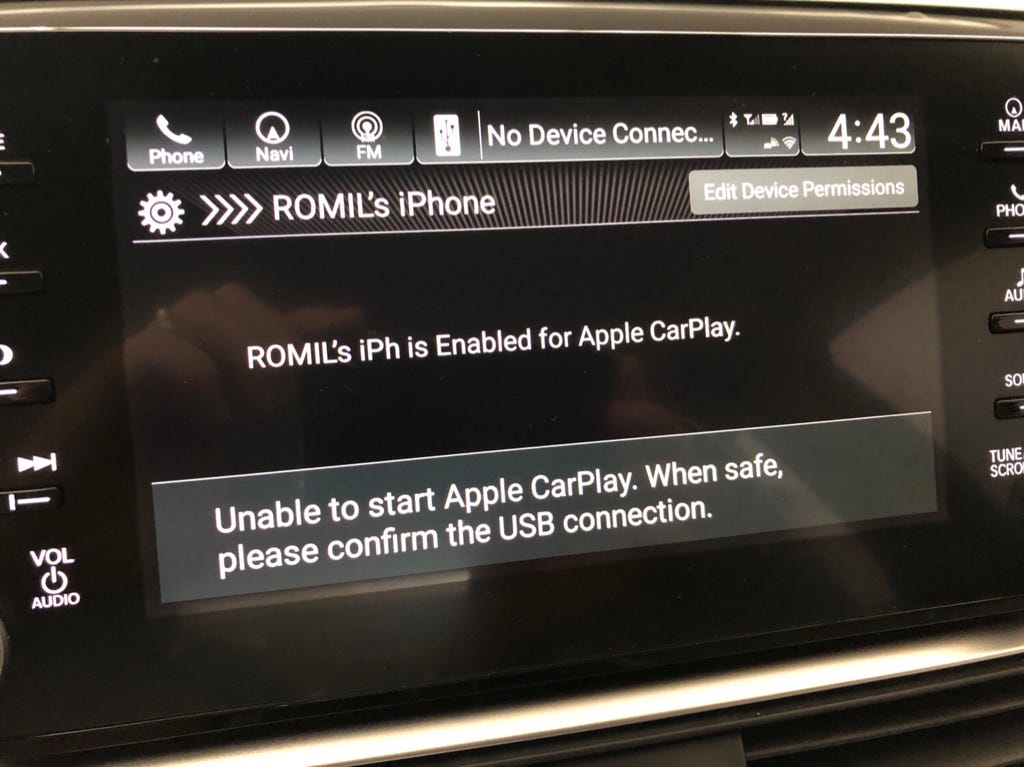

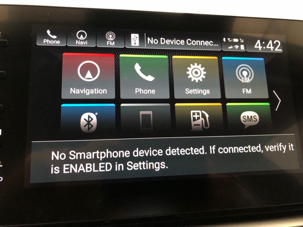

I have had my 2018 Touring since October 19th. CarPlay has always worked fine with the occasional need to re-plug my iPhone X if the device isn't recognized. Today the car absolutely would not start CarPlay. I tried restarting both the phone and car multiple times. No luck. I "forgot" the car from my phone and the phone from my car settings and paired them up again from scratch. No luck. I tried swapping USB cables (all genuine Apple ones). No luck. Then I swapped in my wife's Samsung Galaxy S8+ with Android Auto and it all works just fine. Still no luck with my iPhone X. No software or hardware has been updated anywhere in the chain, so it's really weird it just randomly stopped working. Using Honda's interface with the phone as a USB source also works normally, as does Bluetooth.
Here are pics of the errors I am receiving, in order. I get the first one immediately, then when I go to the CarPlay settings as the error message suggests, I get the second error.
Any ideas?
Resetting the radio to factory defaults resolved this issue for me yesterday!

Worked like a champ, thanks for the help!

I’ve had my 2018 HAH for 2 weeks now. After the first week, apple CarPlay stopped working as I was using WAZE on a 3 hr drive. I noticed it stalled and then would no longer recognize my phone, however the phone would keep charging from that front end (apple carplay) USB port. When I would click apple CarPlay, screen would say no device detected, check if enabled from settings (which it was). After doing several things to trouble shoot: factory reset from settings of the infotainment system worked.

I use Android Auto in mine but some things you can check: 1) try different USB cables and 2) give it some time.
1) The first USB cable I tried was able to charge but didn't handle the data so it wouldn't be recognized or would be inconsistent. That issue was more or less fixed (see below) once I changed out the cable.
2) The first couple of weeks were weird. It was almost as though the car was trying to acclimate, learn about me. One example is the seat memory: sometimes it would just randomly forget and I would have to reset it. It only did this a couple of times in the first couple weeks and it hasn't done it since (I've had the car since September). Same thing with the Android Auto. Changing the cable made it more consistent but it would still disconnect randomly sometimes. After about 3 weeks or so it's been solid. One quirk I do notice though is that if I connect the cable before the Bluetooth has had a chance to connect then my phone won't be recognized - I have to let the Bluetooth connect first.

As another poster mentioned, the USB cable makes a big difference. I use the Amazon Basics ones and have few problems (although they do happen intermittently.)
Another thing to check is whether their is lint in your phone's lightning port. I've had this happen twice. My phone worked on a charger and with certain devices, but not with Carplay.
having the same issue here... I have the 2018 Sport and my apple CarPlay glitches. What I do was unplug and re plug . Sometimes hard reset to factory settings. Today my it totally stopped working. Tried switching cables but no luck.. please help
Keep in mind that a security feature in iOS prevents your iPhone from communicating over the USB port unless that iPhone has been unlocked within the past hour. This is to prevent someone (cough government agents cough) from being able to access your phone without having the passcode.
I simply unlock my phone when I'm heading to my car, then lock the phone again. It's worked flawlessly since I started doing that.

I had to do this yesterday (2019 HA Hybrid Touring, 10,000 miles on it). Have occasionally had a time where it didn't see the iPhone when I plugged it in, yesterday nothing I did would work. Tried both USB's, multiple cords, nothing would make the car see the phone.
I performed the factory reset as above, it took about one minute, and voila, everything was fine. No settings were lost, except my A and B mileage history.
